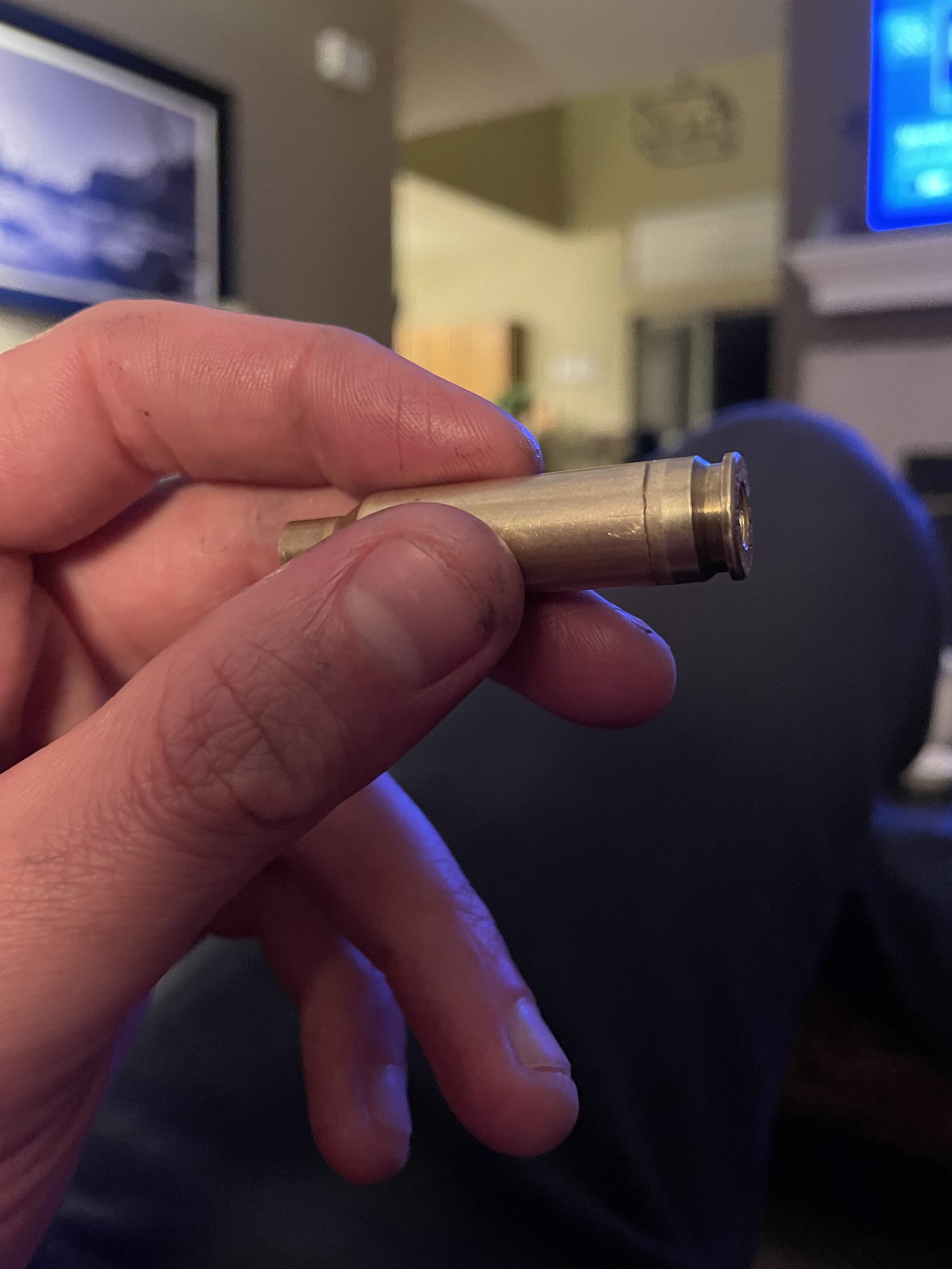

Nosler 6.5 Brass failing

Hey all- I was initially stoked to find some 6.5 brass from nosler on the shelves but after just one firing most of these cases look completely toast.
they’re separating and cracking at the base with a known safe load that’s significantly below max pressure. COL is 2.76” so they aren’t loaded too short.
some of these look like they about blew up. Anybody else experience crap brass from nosler? Maybe hornady brass spoiled me but I’m used to at least 5 reloads before seeing this kind of failure.
check out the deep ring near the base—. That goes 80% around the case and is split open
COAL isn't the only thing that makes a round "too short". Did you size these first? If so did you you use a comparator or case gauge to measure your shoulder setback?
If the shoulder wasn't moved do you have a borescope? If so examine the inside of some of the unfired brass.

wpeach1912- no load dev. I switched from hornady brass and kept the rest the same. I’m using 44 gr of superperf at about 30 degrees so it shouldn’t be enough pressure to blow these cases in half, I’m showing no other overpressure pressure signs
6.5sh—the brass was all sized down to 1.91, deburred and chamfered. I don’t have a boroscope but I did use the ole bent paper flip feeler trick and most of these are trash after one firing. Most have similar hairline cracking or excessive wear from bludging in the same area of the cases where the pictured crack is.
Supersubes- I’ve only got an my ogive socket for my comparator Sounds like i might need to check my shoulder setback

Usually a failure like that is excessive headspace unless you are WAY over pressure
That would make a lot on sense. Too much headspace and allowing that brass to expand within the chamber. To the point its splitting
glad there isn’t .0001 more space, these are close to total failure
that would account for the total lack of other pressure signs too
time to buy a setback socket for the comparator. I’m probably mashing this brass too much and setting the neck back too far.
Excellent advice gents thank you. At least this only cost me 50 pieces of brass and nothing worse

Way over pressure doest do that either. It expands the case head and blows the primer out. That is headspace on the first firing, the question, is the brass too short, or is the chamber too long? Either way, with a light load and a heavy jam into the lands they could be fire formed.
O.P you should have stopped shooting those after 1, I know you had to have some heavy bolt lift associated with that, and head space is going to be your cause. The brass looks in an extremely rough chamber or die. Is it from your chamber, or did you run it though a die before loading.
What is your set up? Have you confirmed headspace via a headspace gauge, or anecdotally by firing other brass for multiple firings and it doest do this??
Somehow this didn’t equate to a rough extraction in the slightest. I didn’t even notice there was a problem until I closely inspected my brass for reloading
they were probably stretching enough straight back and there wasn’t the typical resistance you’d experience with overpressure

You can use a 9mm or 40 pistol case to measure shoulder bump.
So you took virgin brass that’s already on the minimum side of spec, sized it further without actually measuring anything sizing related, and are wondering why they are separating when they stretch to fill the chamber?
I measure everything except setback. These actually came a bit long from the factory -1.92 and more. That trimming definitely exacerbated the problem.
almost a costly learning experience

Headspace confirmed w go/no-go and running the action with the firing pin out
I’m pretty confident I’m mashing these too firmly into my sizing die and moving the shoulder back too far. These were formed on a new hornady match die and I fear I have the sizing set to the point where it was squashing the brass
Exactly. So you didnt measure then.
"I measured everything except the stuff that matters" is how that reads to everyone else.
1.920 as an overall length is basically useless. Overall length isnt the problem... well basically ever. You problem is you folded body material into the shoulder and shoulder into the neck when you sized and then shoved the whole thing forward stretching your case webs when you pulled the trigger.

I’m in agreement with y’all on this one. Like I said— Learning experience for sure, glad it didn’t cost me more
This equates ignorance on my part.
My biggest mistake here from any other rookie (like myself) to learn from:
I thought the sizing die would not allow me to mash the brass below minimum spec due to the bottom of the sizing die bottoming out against the case holder.
That’s just not true. I wasn’t aware and it could have been ugly

Yes, your assumption is the very reason FL sizing got a bad rap. Some dies are chambered so short you can barely get the sizing you need out of them, while some will knock the shoulder back .020. Shell holders vary as well, and allow more or less bump.

A Hornady .375 C insert for your 6.5 CM is $10.00. https://www.midwayusa.com/product/1012729396
Sounds like you already have the Body (holder) for the insert. I'm sure that Nosler brass was worth more than $10.00. You can try the 9mm or 40 case route & see if you get consistent readings.
Not the first time that I have heard of a Hornady die setting shoulders back too far when following the instructions. I had one in .223 that set the case shoulder back .030 shorter than min. They all fired, and they all got a ring. Couple of my reloading friends have had the same issue at different times with different calibers.
All of us just canned the dies and went to Forster and never looked back.

Trimming had and has nothing to do with your case seperating.
Trimming controls the total length of your brass.
As Spife and others have pointed out, you created a headspace issue (by oversizing your new brass) and the brass has to eventually fit the chamber as part of the firing sequence.
To get the shoulder (the datum line is basically the middle of the shoulder)to move back into place, brass will flow from just in front of the solid web.
That's why your cases are seperating.
You have a serious headspace issue....
Now, on to another issue that you mentioned.
You said you get 4-5 loadings on your brass before it's trash.
Do you have any idea why that might be?
Probably not.
If your cases are seperating after a few loadings, then you have created a headspace issue.
If your primer pockets are loose, then you are way over pressure.
(You have both problems)
Even those cheap Hornady cases will last for a dozen firings. Most will last longer than that if you aren't hammering them with 70k+ psi.
