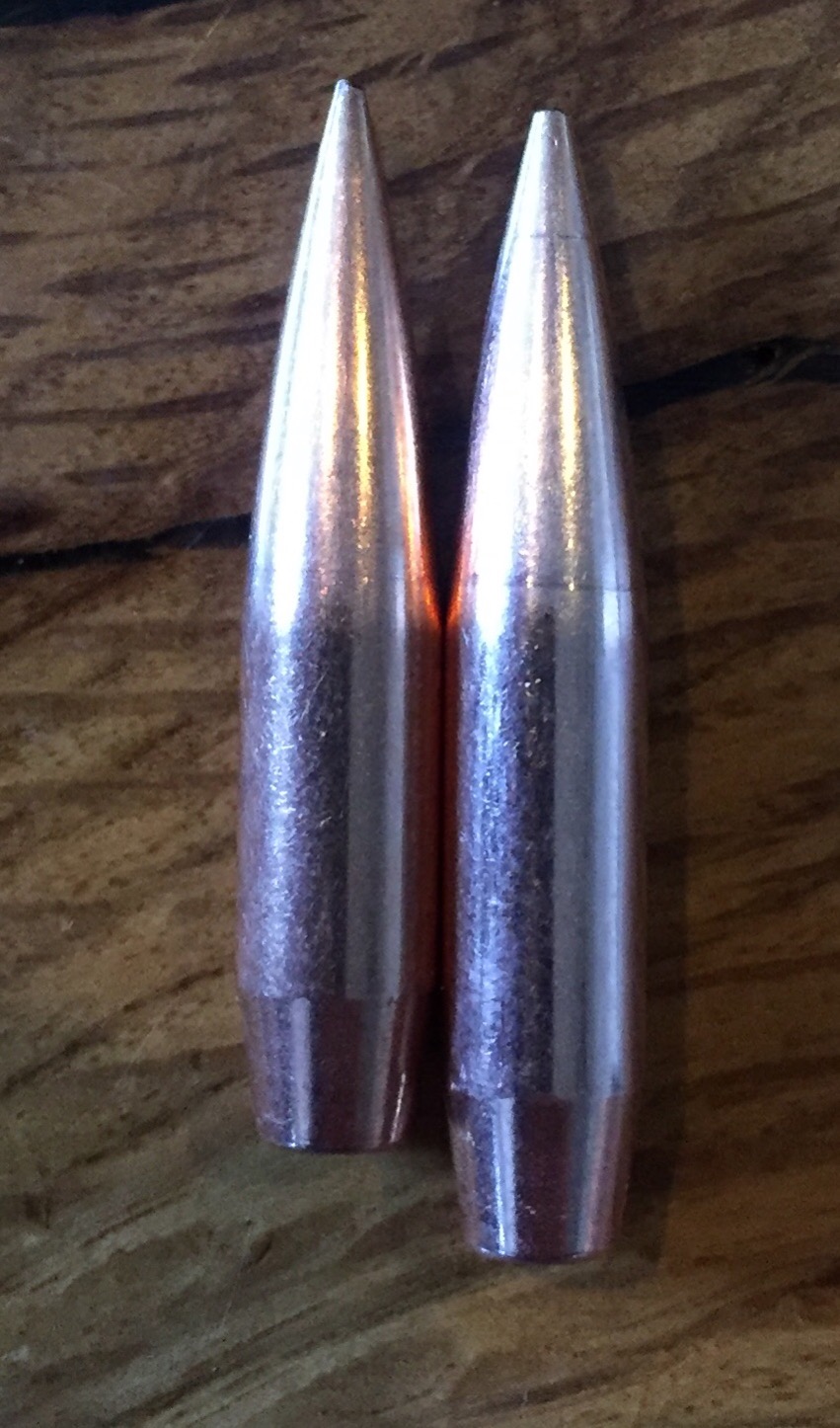

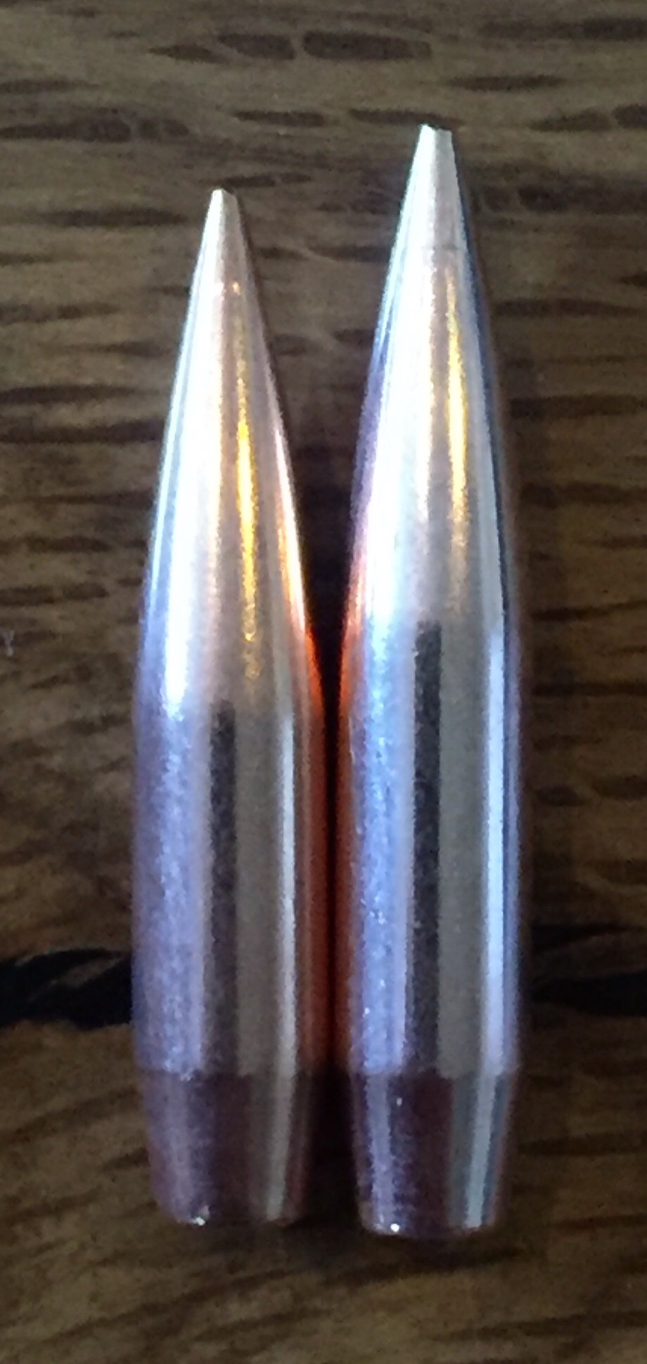

105 on the left, 115 on the right.
Bases even
Comparator marks even

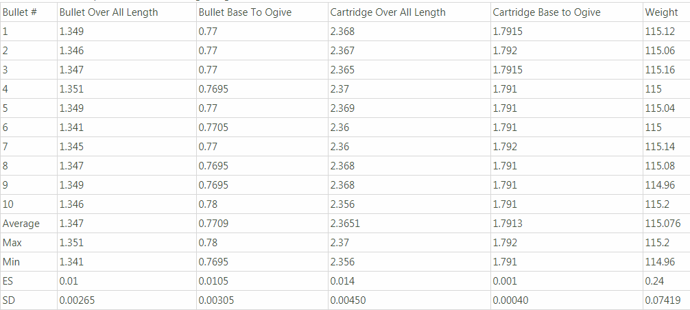

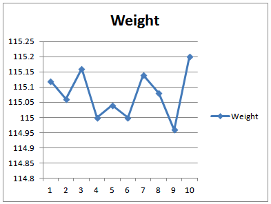

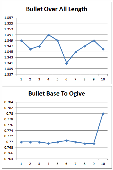

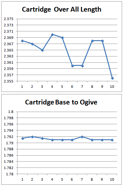

And the results of a brief sample of 10.
