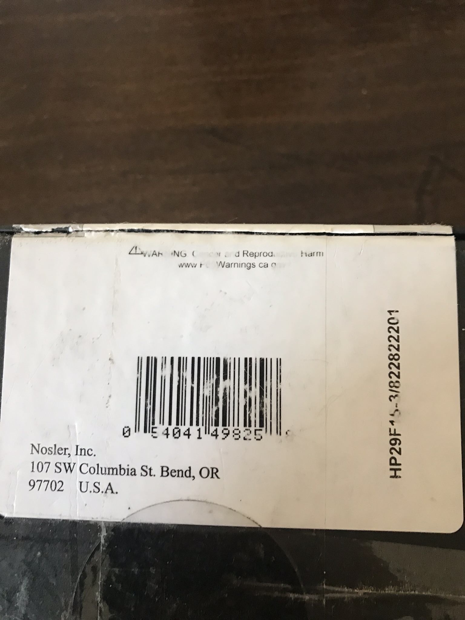

    What lot number were you having issues with?
    The guy from Nosler was super cool and said this happens with the older lot numbers. I’ll try them again but want to verify they are a new batch.
    @NoLegs24 can I send you a PM?

    Reactions: NoLegs24
