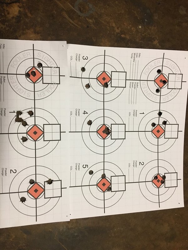

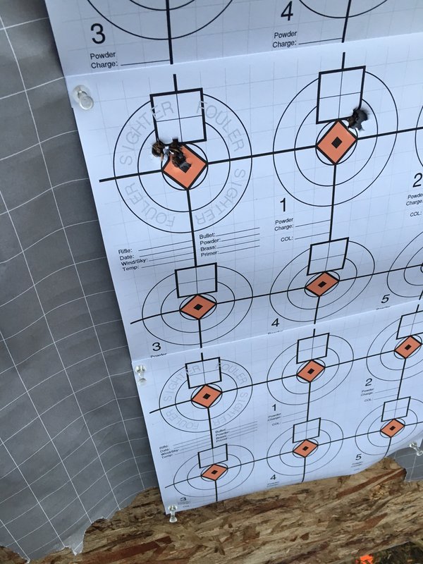

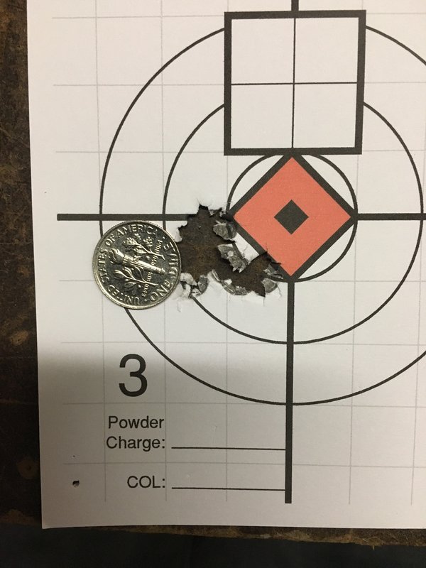

I am having a little bit of an issue with a new lot of 175 gr nosler RDF's and i was wondering if anybody else has experienced this possibly with the new rdf's. I have contacted nosler but unfortunately they were closed for the day so I emailed them as of now and I'm not sure if there are any reps on here from nosler. My experience came from when i purchased a single box of 100 of the 175 rdf's to try them out and i was very pleased with the results as can be seen from some of the images (9 shot group with dime then 5 shot group and 3 shot group other image). I proceeded to purchase a box of 500 and this is where my issue started (image of OCW starting at 43-44.8 x.3 increments with a couple seating depth test at the end). I used the same brass from the same loading/powder/primers as was used previously, the only new item was the new lot of bullets. My load from the original box was 43.4gr varget/lapua brass/fed 210m and the 175rdf seated .020" off the lands. Now with the new lot, i tried the 43.4 and the same seating depth as a starting point and it was fairly bad but i thought it may need tweaked so i ran a new OCW from 43-44.8 and it was horrible with no clear node or anything resembling my previous experience. I had groups upwards of 2" which i have never seen from any load through this rifle much less my previous box of rdf's (rifle is a custom rem 700 m40a5 base copy). I was wondering if anybody else has seen this with their RDF's? Once I am in contact with nosler hopefully i will be able to send them the bullets for inspection. Lot number is smudged on the box but i believe it is KN22F20-1/150515051505 (The K might be an R)

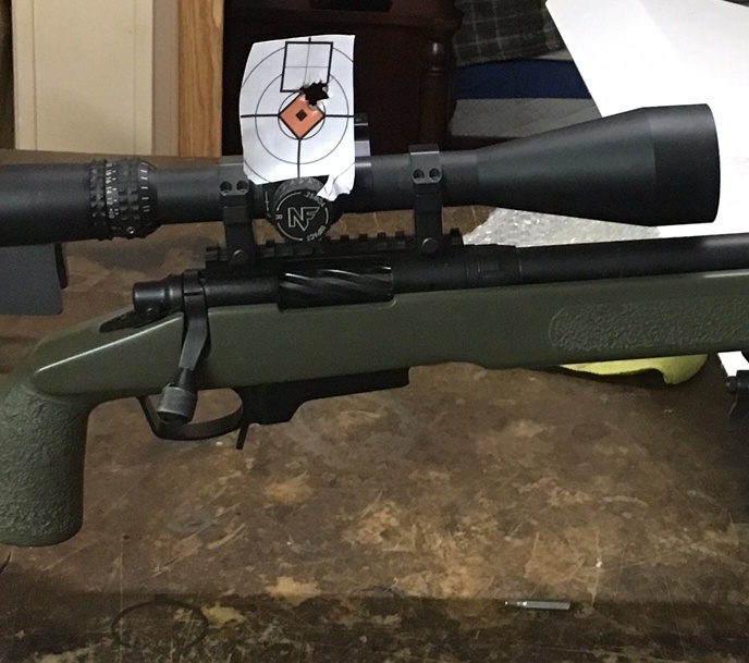

I thought the same thing myself so I wanted to make sure. Unfortunately i didnt have any 175SMK which i know shoot very well so i used the 178 ELDX i had with 43.4gr of varget and shot the 6 shot group attached in the image. I feel comfortable nothing drastic has changed with the rifle.

Have you considered that what you thought was a node wasn't?
No, not really. Given my previous experience with the box of 100 I had there should be a node, actually two in that 43-44.8 range. Looking at the target shows me no relation to my prior experience with this bullet or any bullet i have tried for that matter. Considering varget and that weight class of bullet it is fairly well known for the 308 win that there should be a node around 43.4 and then a higher one around 44.5 or atleast from my data and data i gathered from the reloading depot here.
