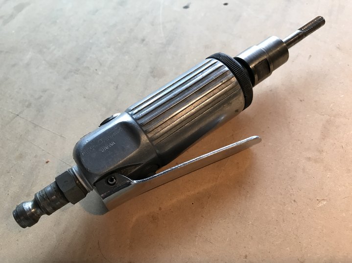

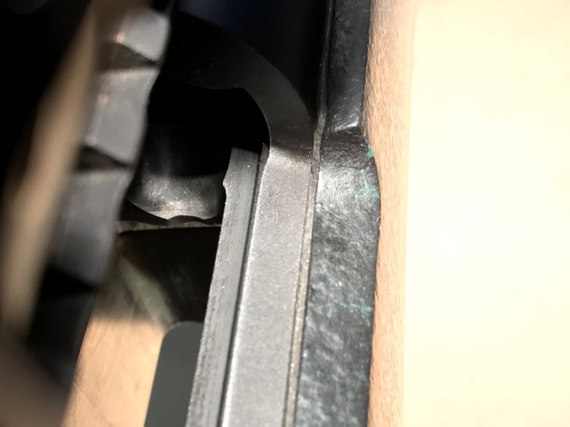

Went the air tool and carbide burr route to modify mine. Didn't need much removed. photo51202.jpg
