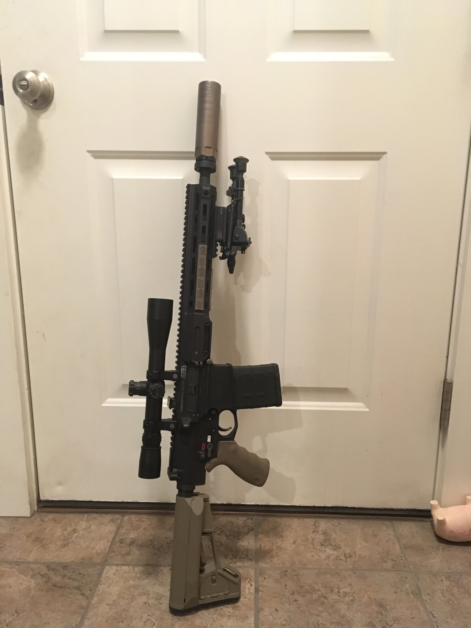

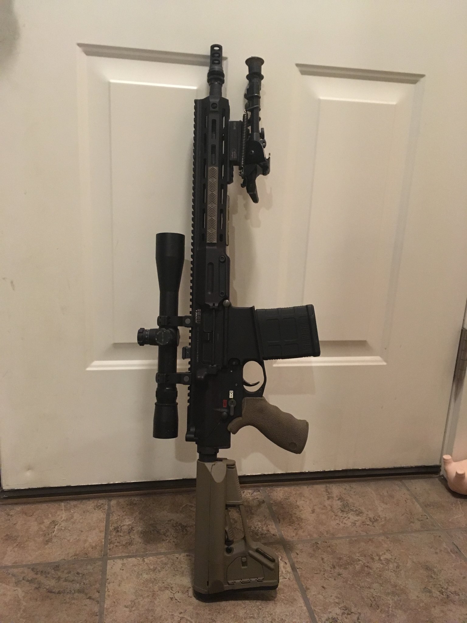

I took my lmt mws 16" cl .308 barrel and chopped, threaded, pinned, and welded an asr muzzle brake. The barrel came out to be just over 14 1/8".
So this is the same 16" barrel from the factory, meaning the gas port is in the same location, same size, same port pressure, only less dwell time. This actually helped with the over gassing of the lmt. The rifle now runs smoother, so now not sure how this would beat the rifle to death. As far as the noise goes on this short .308, it sounds like any other centerfire rifle going off. With a suppressor, I shoot it without ear pro just fine, just like on a longer barrel. Reliability? Can't get more reliable than running 100%.

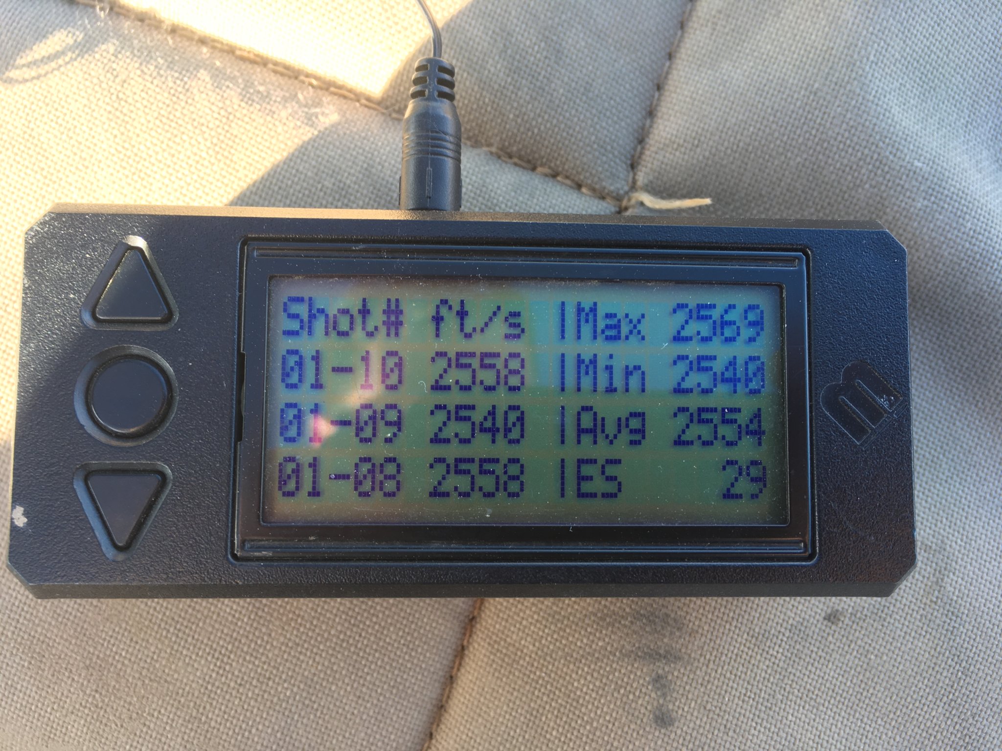

Now the thing you guys are waiting for, velocity...... the day before I chopped the barrel I hooked up the magnetospeed and got an average muzzle velocity of 2587 fps with a 155 eldm and 45.0 varget in lc brass. This is with the 16" full length barrel. I chopped it and put a patch through to get the metal shavings out of it then hooked the chrono up and shot 10 rounds of the same load. It averaged 2554 fps. This is only 33 fps slower for almost 2" of barrel. That is a difference of .3 mils drop (about 8") at 800 yards and the same wind drift. This is with varget that produces pretty low velocities. I just used that same load for a before and after comparison. I'll try some imr8208 and bet I get some more impressive numbers.
2" of barrel might not sound like much, but it looks and feels much shorter and balances much better. I am very happy with this 14.1xx" barrel.

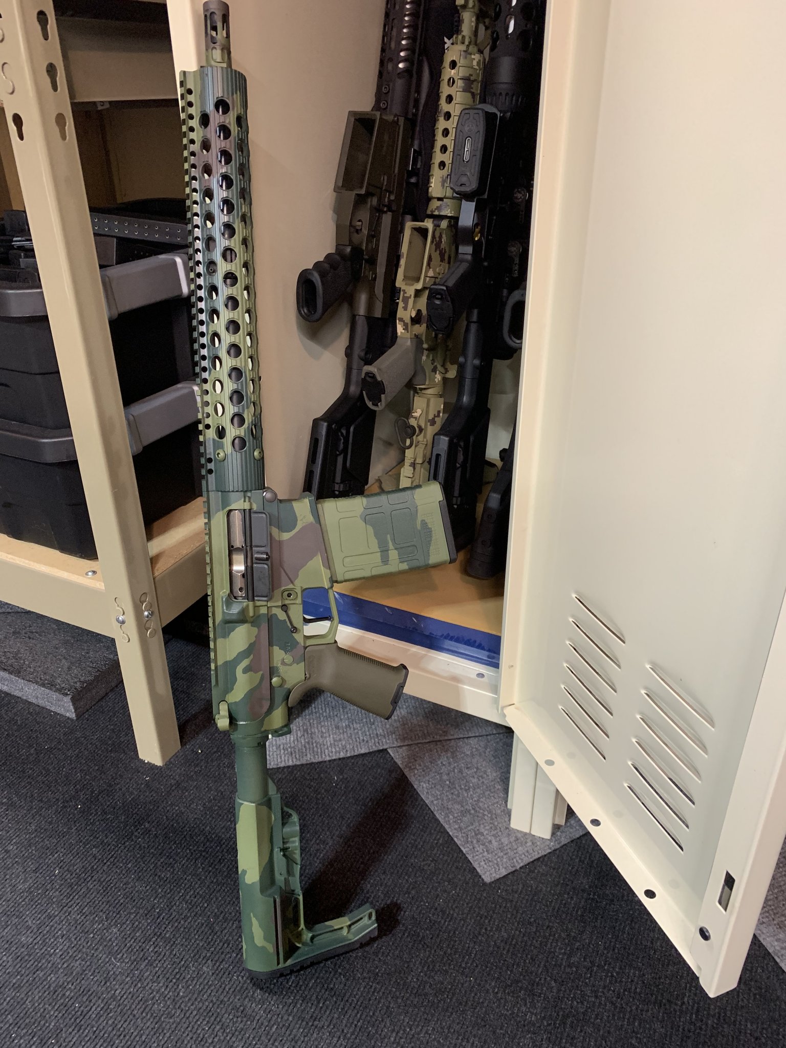

Pic was taken a couple years ago after i had just got done doing load development with a 5-25 on there normally it’s a 1-4 with offset irons . Shoots great and weighs around 7lbs
