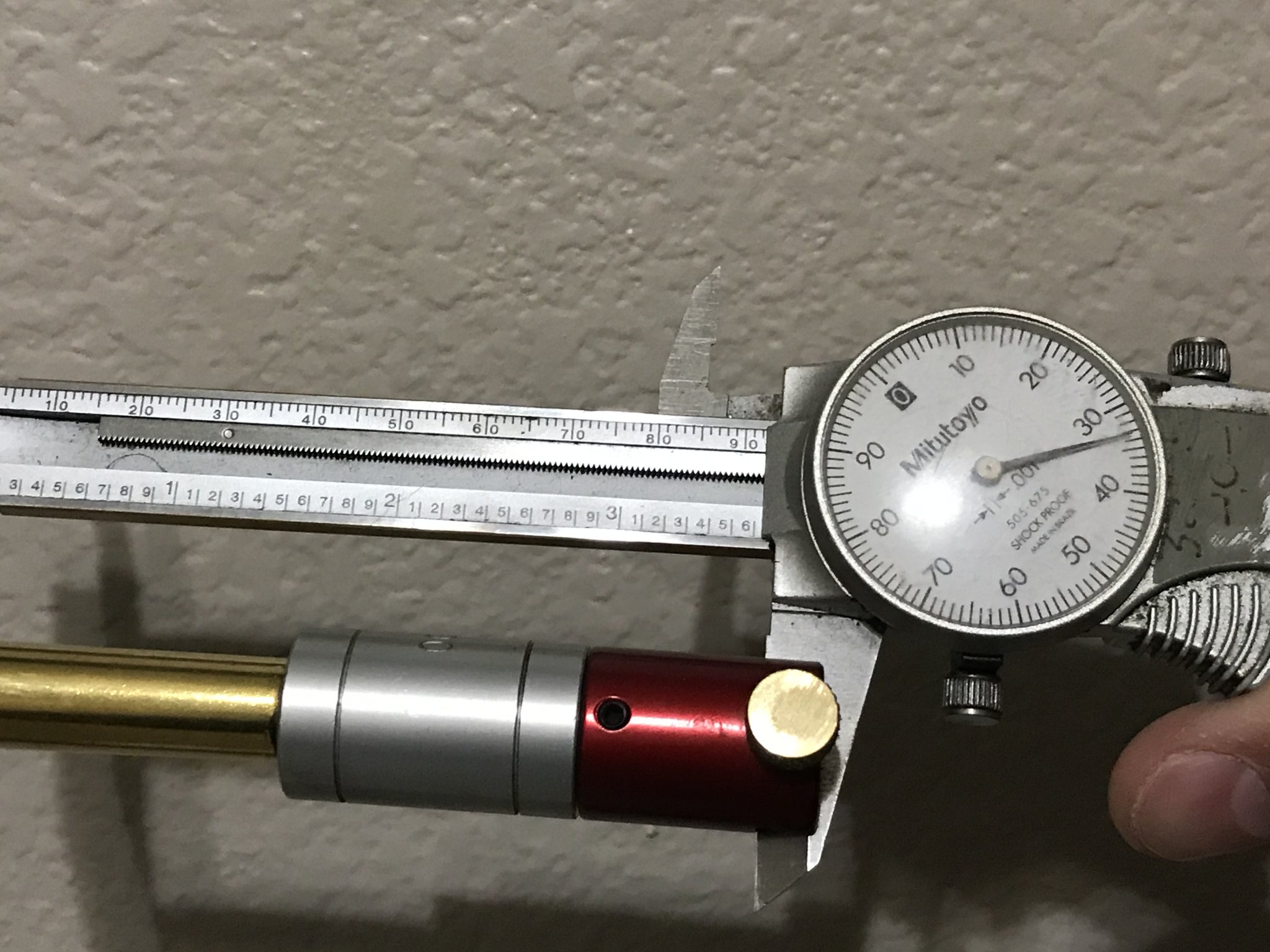

I loaded a couple cases that were fire formed to 1.626". After I dropped the bolt from locked back position; I re-measured the headspace on the cartridges. First one measured 1.623" & the second measured 1.618".
What do you all think of that re-headspacing on bolt drop.

What does a fired case with the primer removed measure?
90%+ measure 1.626". Some longer with a total sample of 2x measuring 1.629". That leads me to believe my chamber must be more like 1.630".

Its getting ready to rain here and I’m bored so just pulled a round of FGMM 175 and measured the case head to shoulder datum using the Hornady case gauge/D400 bushing.
I’m getting 3.6335. Loaded the round into my SR25 slammed it home. Same measurement.
measured a round of M118LR and got 3.636. Loaded it, removed it and still 1.636.
Measured a round of Mk316 mod 0 and it read 3.637. loaded/extracted the round and measures 3.637.
Perhaps it would be worth it to post a quick video of what you doing and seeing in your before/after measurements, assuming you have a means to support the camera/phone or an assistant willing to film.
Haha, perhaps a pic would help
Point was I didn’t see any resizing/shoulder bump after loading relative to before.
3.6” would be something, lol
