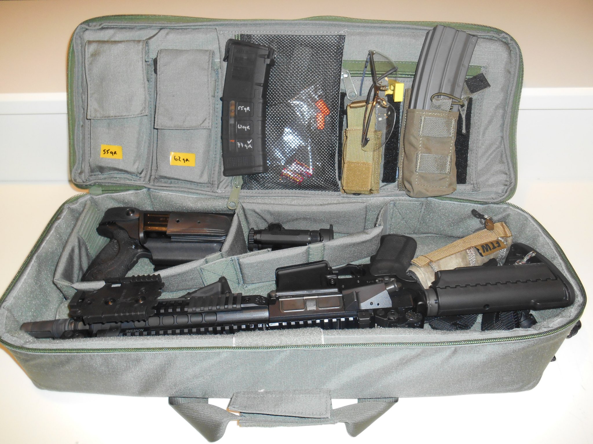

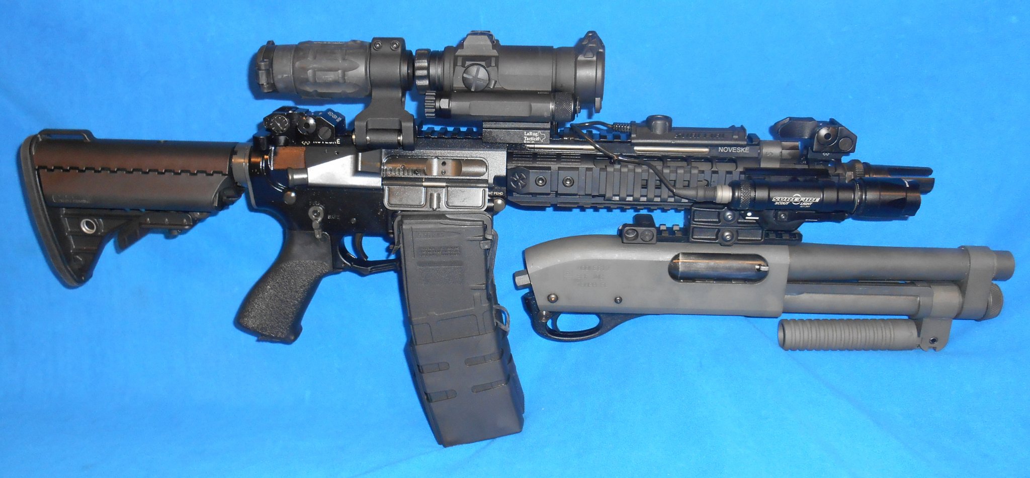

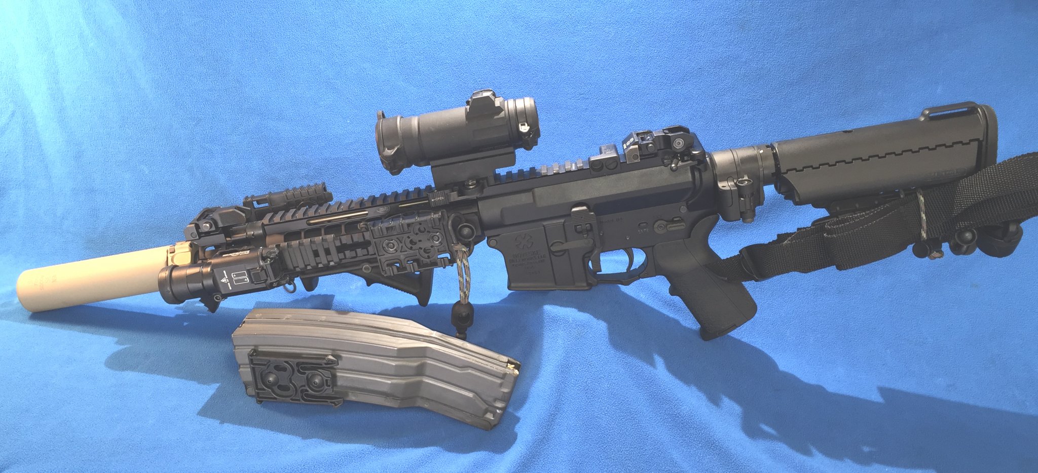

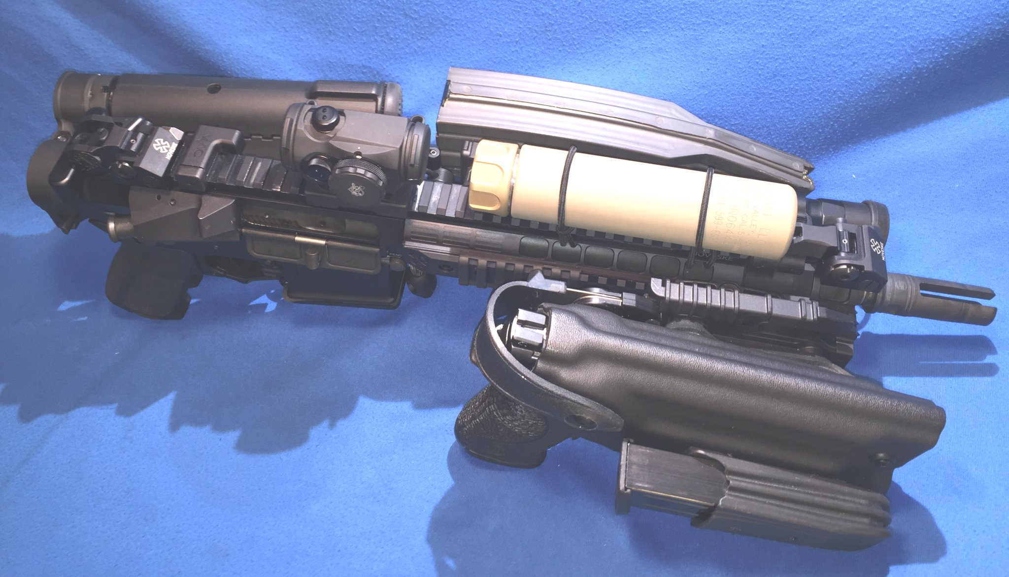

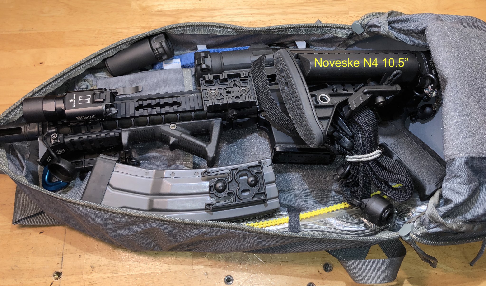

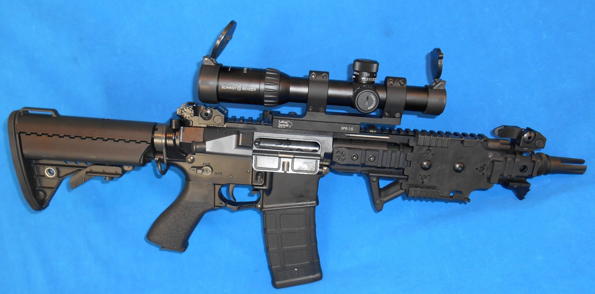

I only have this Noveske 10.5" N4 SBR I have setup in a couple of different QD optic (S&B 1.1-4x short dot / Aimpoint red dot) configurations, but in particular it has a good round count with Surefire 60 mag, Safariland WLS to secure sidearm + extra mag, folding stock and muzzle brake that allows for QD SOCOM suppressor / Warden muzzle brake, everything together in one grab-and-go package; installed a Geiselle SSA 2 stage trigger; Blue Force Jedburgh model or LaRue discreet case for carry. It's been a really nice accurate rifle for anticipated use out to 200M. It is easy to re-configure it into a KAC-style Master Key if you live in a de-funded law enforcement zone. I purchased this one from John Noveske's mfg. facility just prior to his unfortunate motor vehicle accident in 2013, a conspiratorial demise at that. My experience inspecting other Noveske firearms is that in general they are a high quality firearm.
