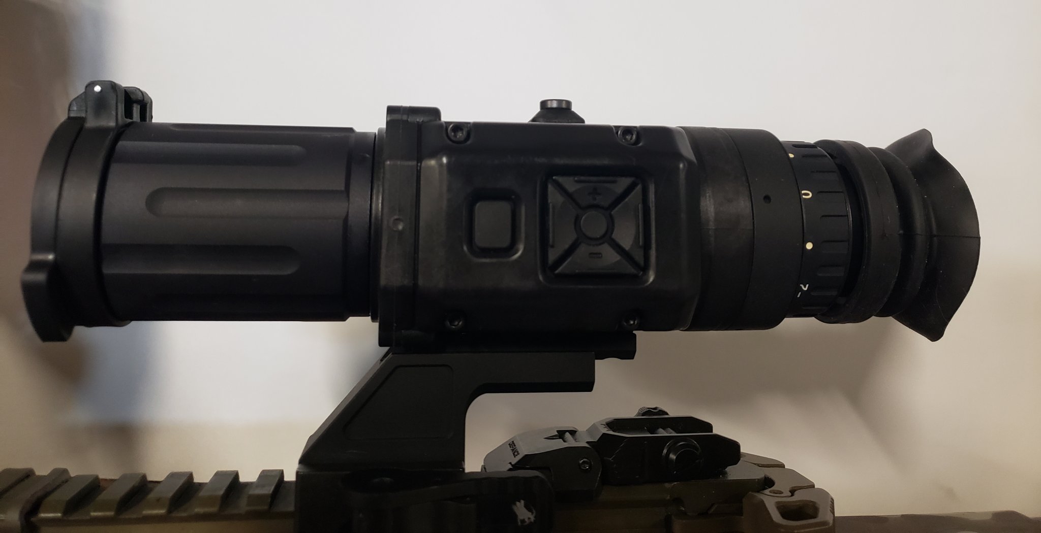

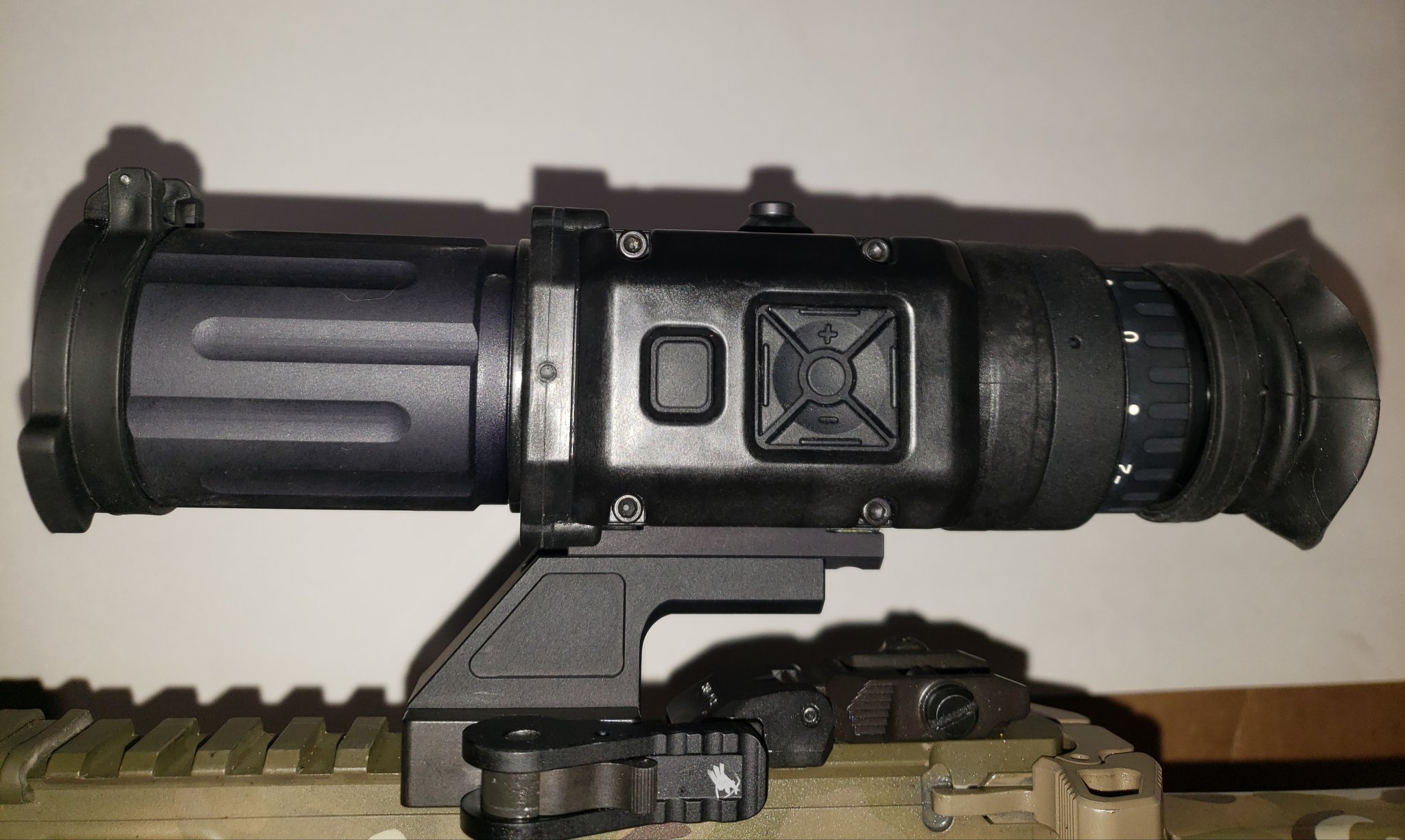

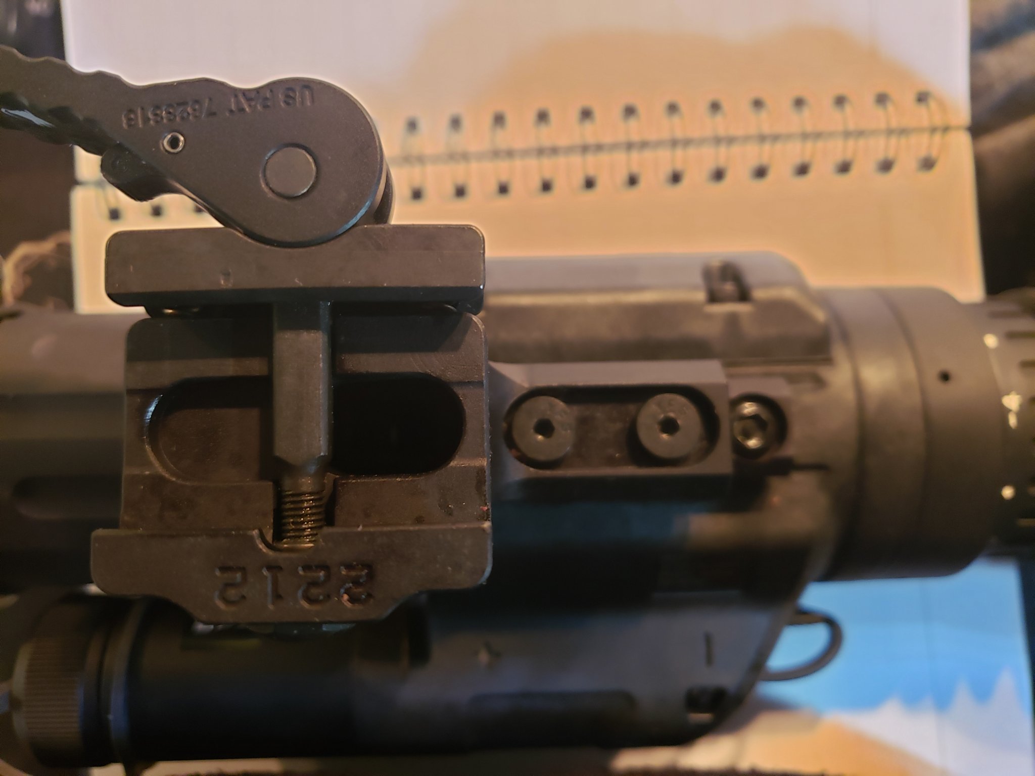

Mines an 18 so I get some shadow no matter what due to the wide fov. You can get a wide variation of of heights with the different kram spacers and mini acog mounts. The hole pattern on the kram is a little off from the nox so bolt your factory mount to it to use as a template to drill or file it out. For instance this is a tall mini acog mount and the thinnest kram.
Reactions: koshkin and Max_R

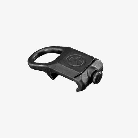

Yes you'll need a nut for the rear hole. It needs to be narrow or tapered so it'll sit flush on the bottom of the v shaped channel. The one in the pic above I used a nut off of a pic rail sling swivel. The other ones I got a nylock nut from the hardware store and flipped it upside down so the rounded part is down. Still didn't quite fit so I ground some flats into it.
Don't think this is the exact one but it gives an idea.

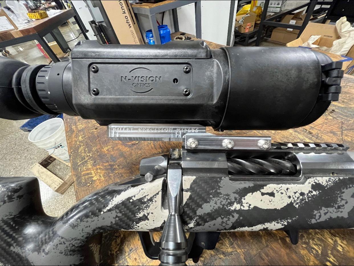

Might be a little late to the party but check out Billet Percision Rifles.. 2 of my buddies are running them. Not QD but no they're solid. First pic is a random pic of one before anodizing. One on right is next 2 bobro

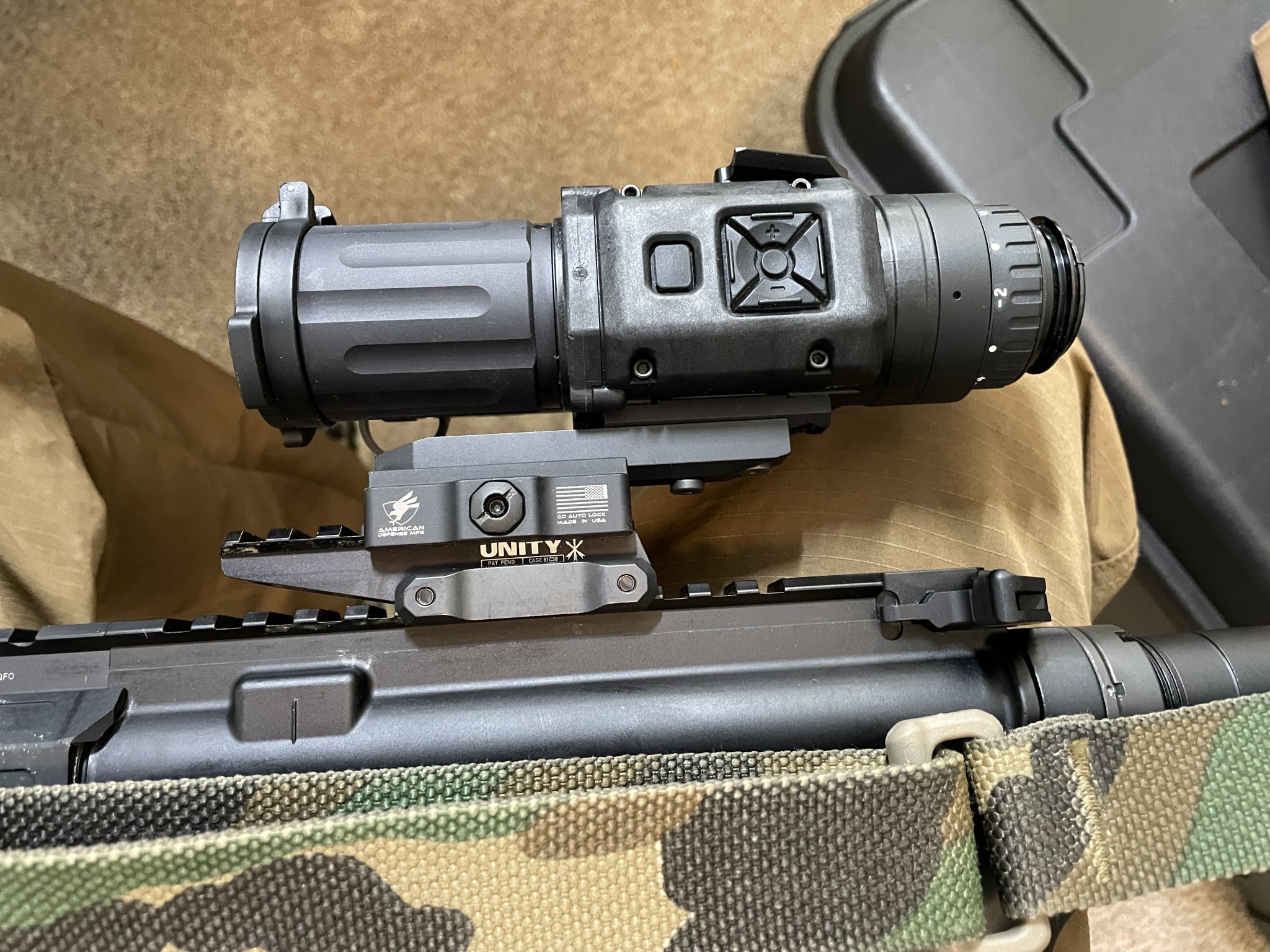

Looks a little silly, but I threw the Kram 9.0 on the factory ADM B2 mount and tested the height over bore and it wouldn’t quite clear the DBAL, but if you throw it on the unity riser it clears everything. I have an ADM cantilever mount on the way so I’ll post photos of that setup once it arrives to give everyone another option to consider.
this is what i want. thanks for this. i called for Billet Precision and hopefully get one coming my way.

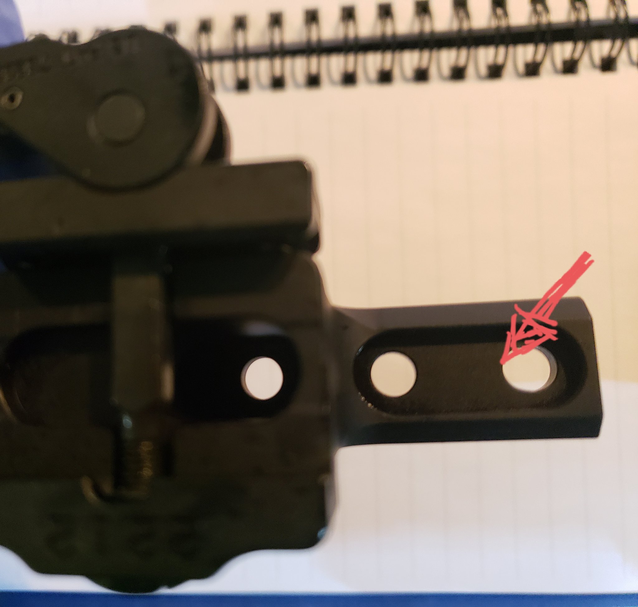

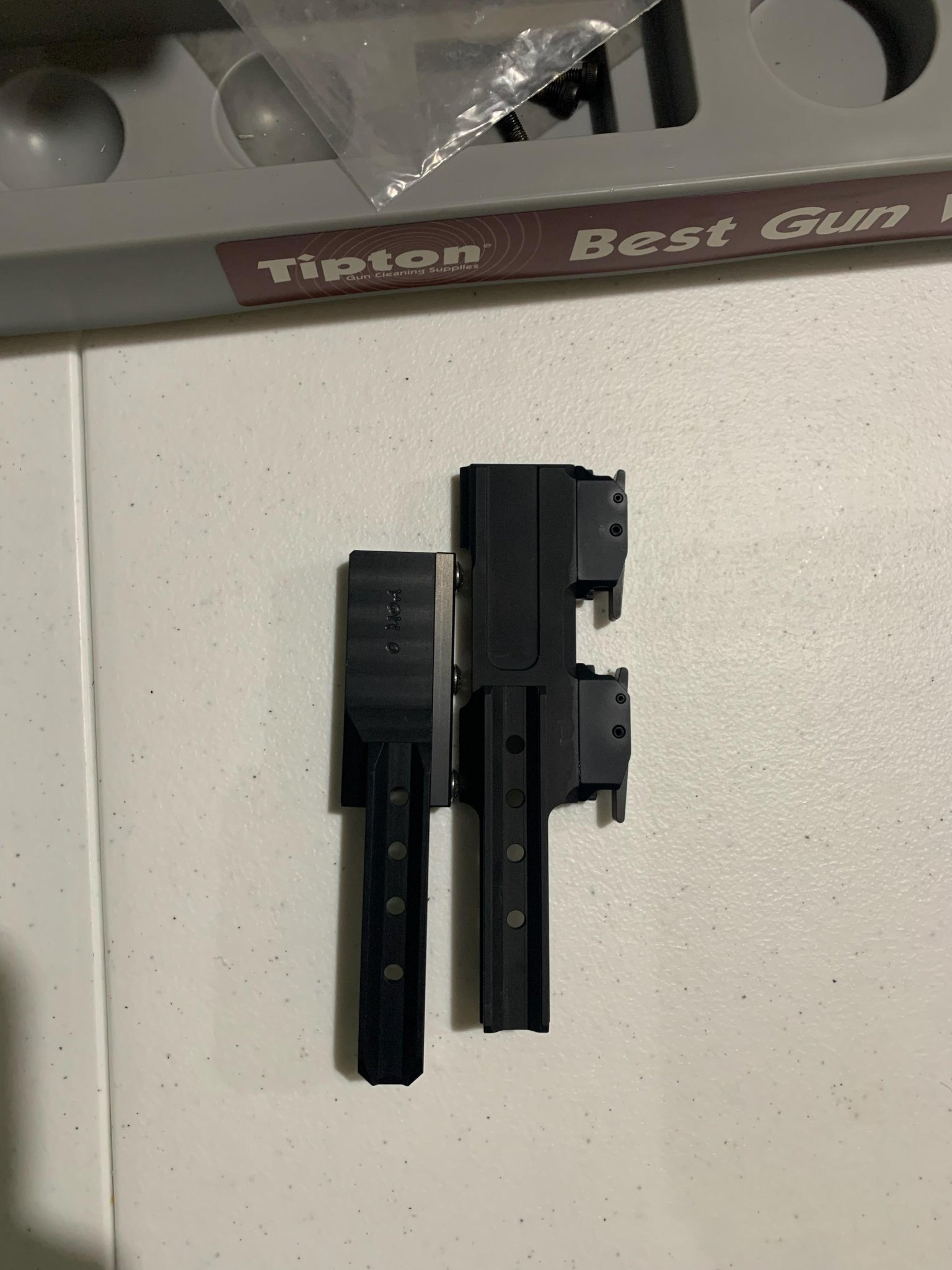

A friend of mine used American Defense AD-B2 Cantilever mount 1.93" which raises and brings it back more posteriorly to the eye and gives you clearance for devices on the top rail. Mild filing was needed to get the rear most screw hole to line up, see red arrow. This was secured with two screws @ 20 inch lbs of torque. This mount comes in 2.3", 1.9", 1.6", 1.5" and 1.4" heights, see American Defenses website.

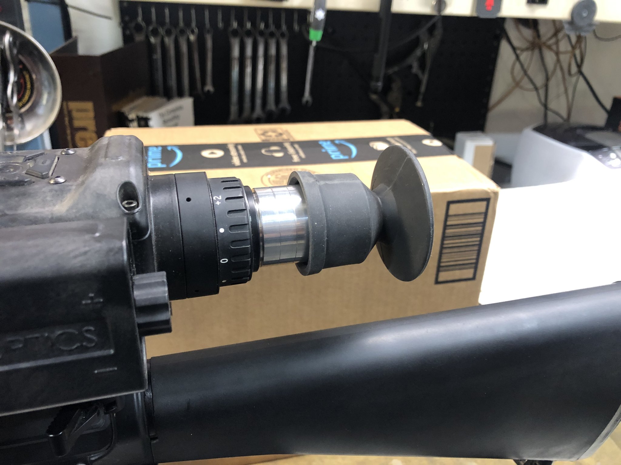

These pictures are the adapters on a Halo LRF, but it sets up the same way it would if your using a NOX.
These give you enough eye relief to use on a bolt gun as well, but you will need a cheek rest.
Just add spacers until your eye relief is comfy for you.
Like this for example.
Shown here screwed on the Halo XRF with a shuttered eye piece attached.
