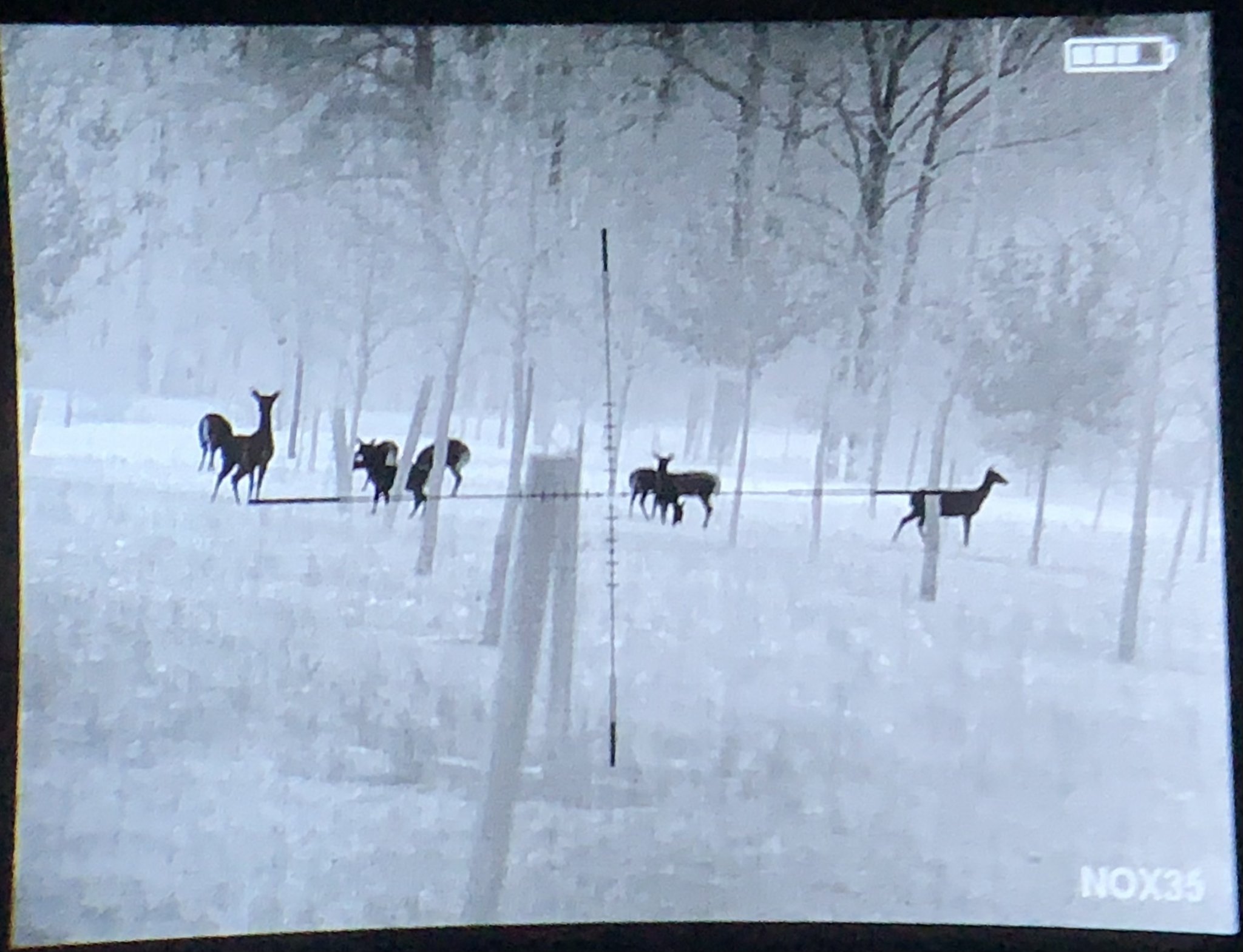

Image. It is outstanding. It has the best image that i have ever seen in a thermal and I've seen quite a few.
My scope is a Trijicon MK3 35mm. I used to switch from my hand scanner to my rifle scope just to get a sharper image and a some brief eye relief. Now I don't do that. The Nox has a crisper, sharper, more detailed image than my Trijicon and that is saying a lot.
