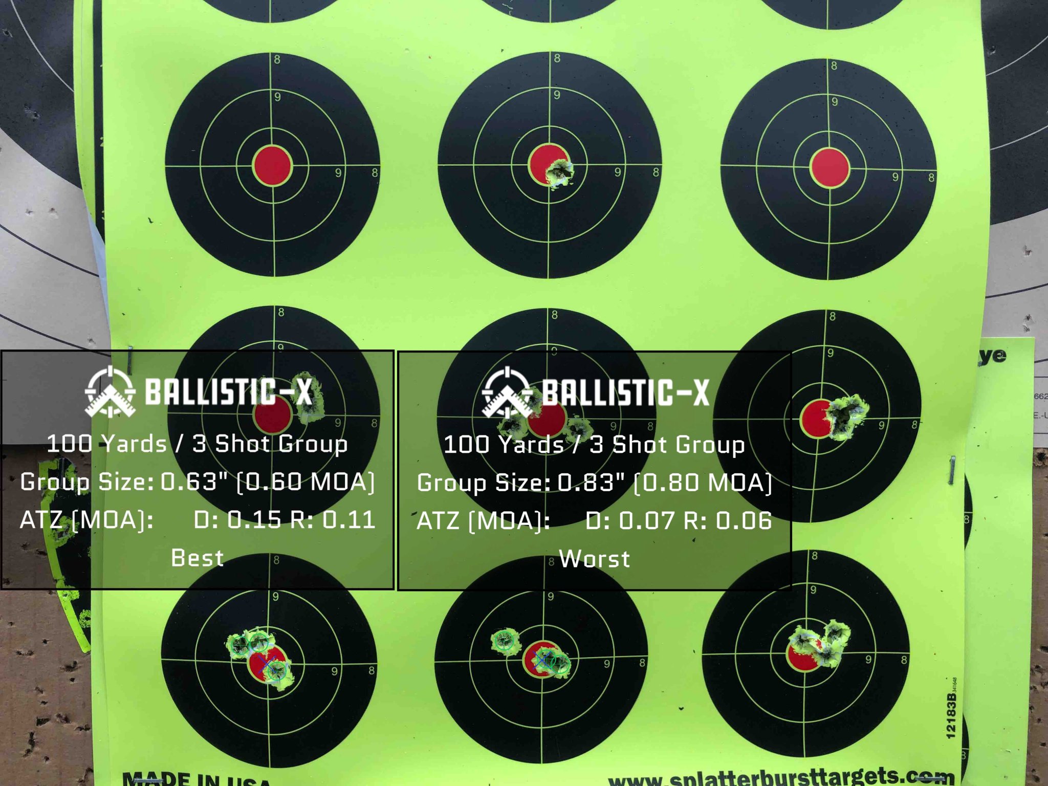

Spent another box of 147 ELDM’s today, she is a hungry lady.
Anyway, seems like there was a little improvement. It is tough getting myself to a place where everything is lined up just right, and I a completely relaxed. I sometimes have a hard time picking up that center dot too. It is not consistent. My eyes aren’t exactly eagle caliber, but sometimes it is in sharp focus, sometimes I can’t see to see it for shit. The illumination would probably help there a lot on these gloomy days, but it seems to be unreliable on this Trijicon glass. I will need to look into that and see what’s up there.
Anyway, proof is in the pudding. I know it’s probably nothing special to you folks, but it is better than where I started...

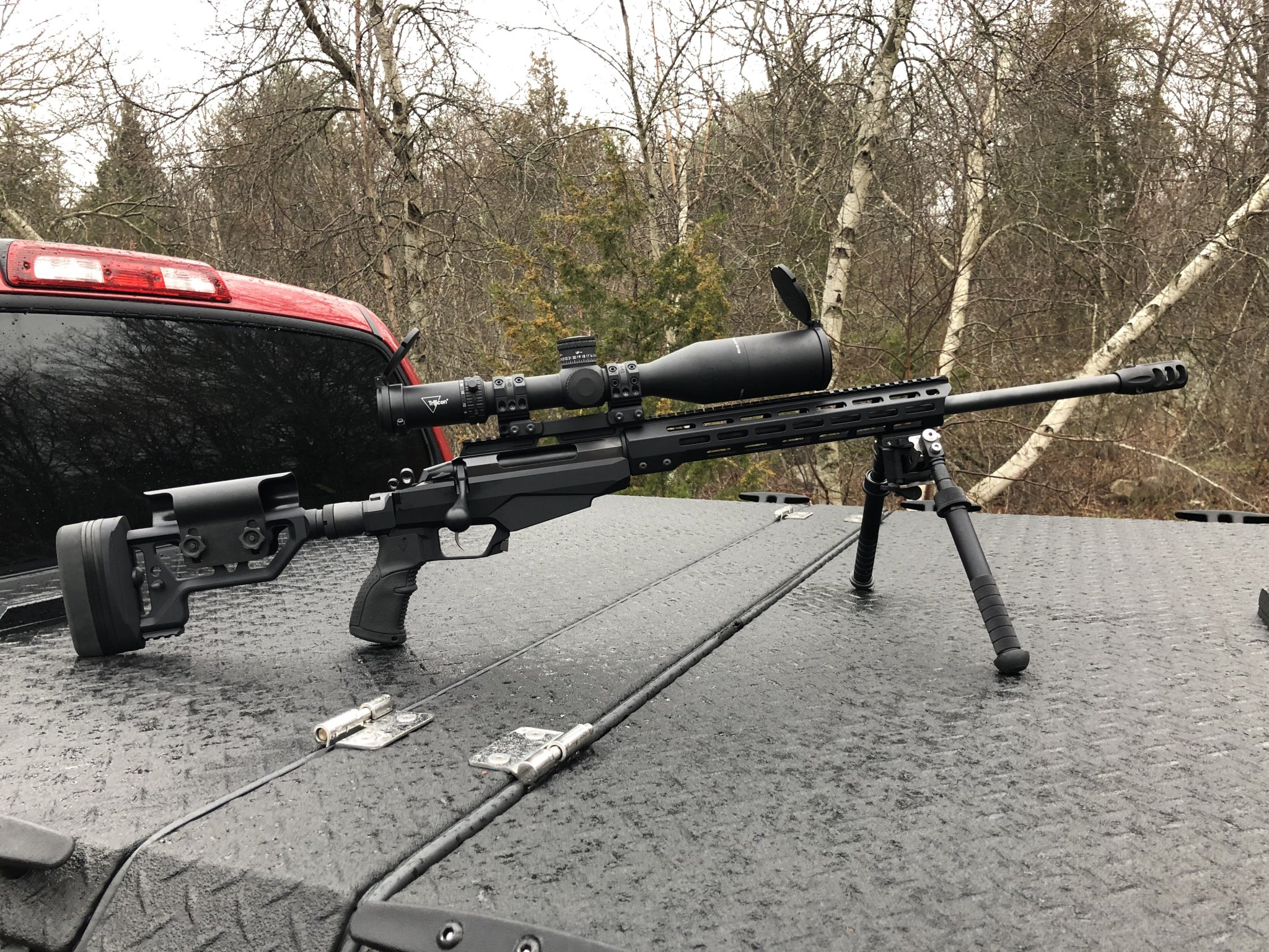

And just for the heck of it, here is my girl. Modest compared to some of the rigs I see on here, but she is good to me...
@McReef Did you adjust your diopter on your scope to properly focus the reticle? I think you should be able to see the center dot clearly if the diopter is set. It’ll be a huge thing to not have to struggle with.
That’s a good looking gun. You should see my ghetto rigged AR15.
