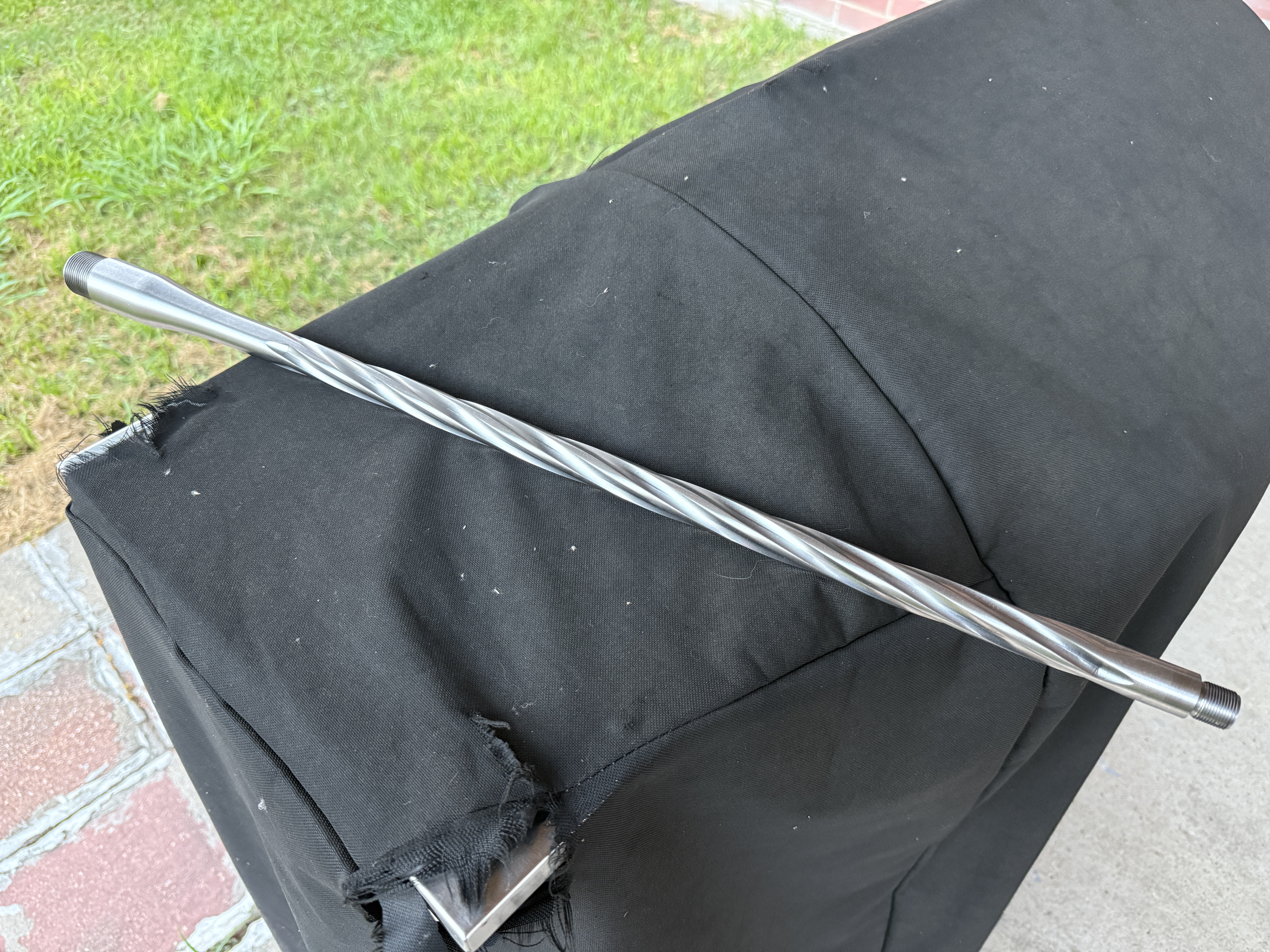

I am new to NRL Hunter and currently building my first rig. My question is…which barrel is better for NRL? I don’t have experience with either. My thoughts..
Steel Fluted = can hold up to longer (8 rds) strings of fire but heavier depending on contour. Possibly could go shorter to save weight but then I lose velocity/power factor.
Carbon = lighter & possibly longer which benefit weight and velocity but may start to drift the more it heats up. Even with a thicker contour I don’t think that is enough to change how the heat will affect it given how they are constructed.
Or neither and I should look into something else.
*Im trying to stay in the open light division with a 6.5 CM setup

I’d probably go steel like a preferred .750 or .810 taper less, 3b, or a fluted light or medium Palma. Although I have had good luck the last couple years with a proof CF prefit on my light rifle.
