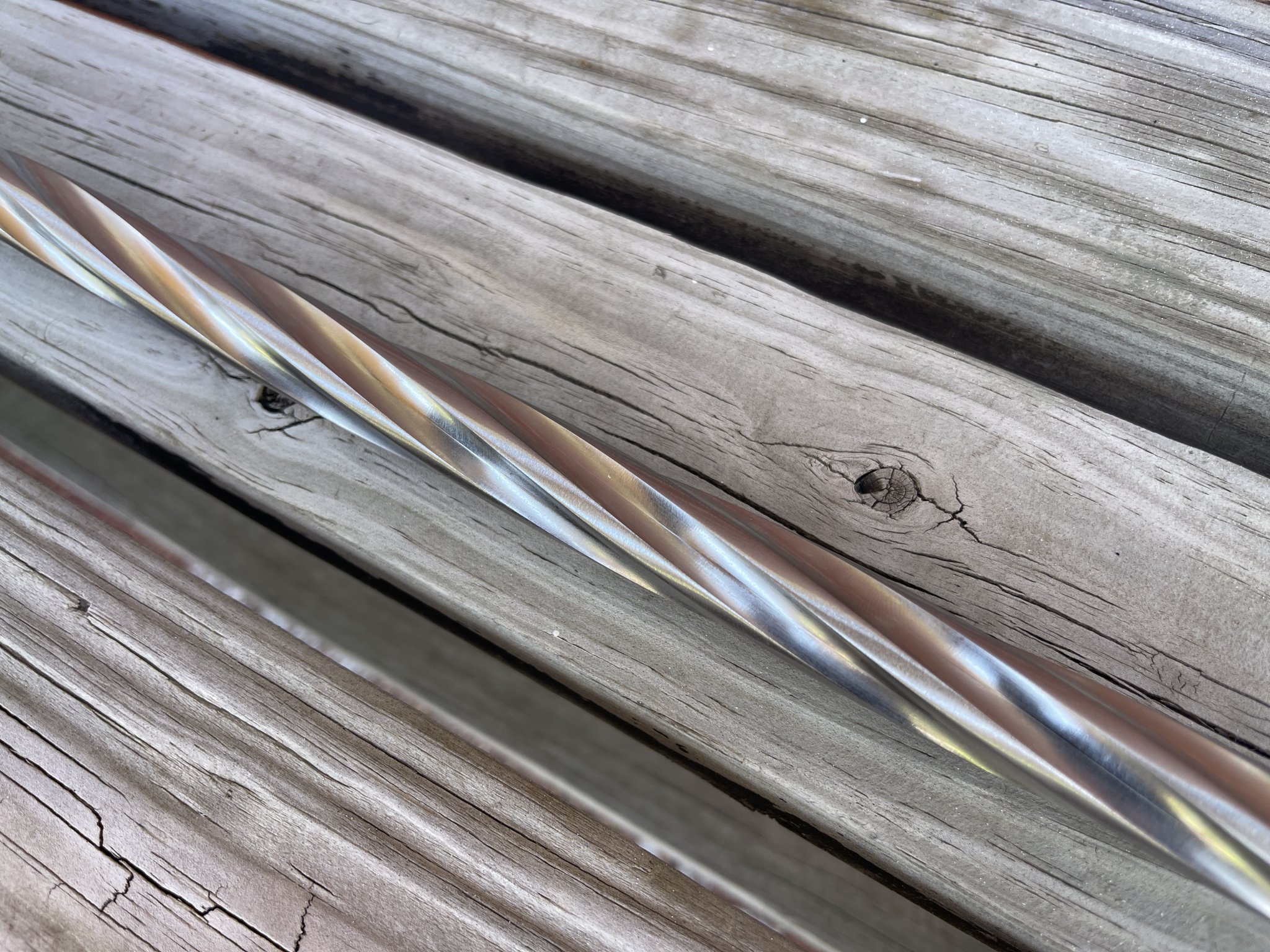

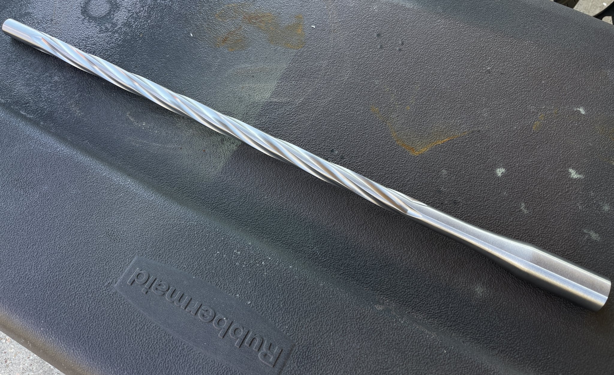

The barrel came in. In case anyone searches later on and comes across this thread about lightweight barrels for NRL Hunter.
7mm 8 twist Preferred Barrel Blanks .750 Taperless contour at 25” unchambered. The fluting is the helical 12 style. Weight on my scale is 45.5 oz.
