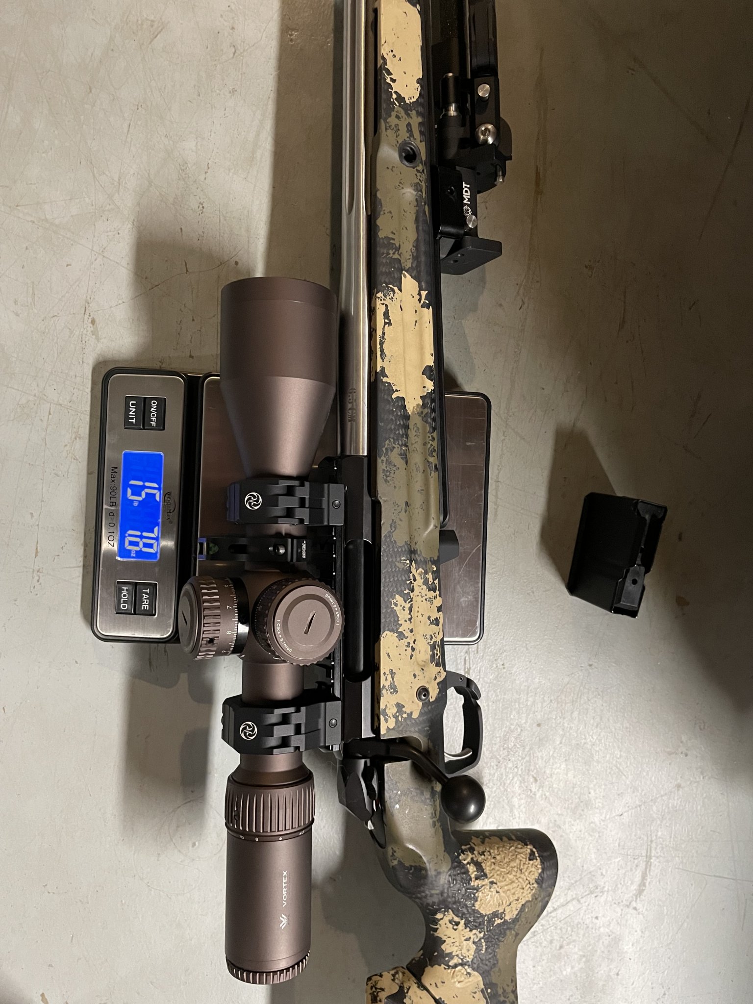

I’m less than 16 with my setup and it has a razor gen 2, manners prs1tk with , nomad ti and rrs arca and a cyke pod. I would just add the arca.
