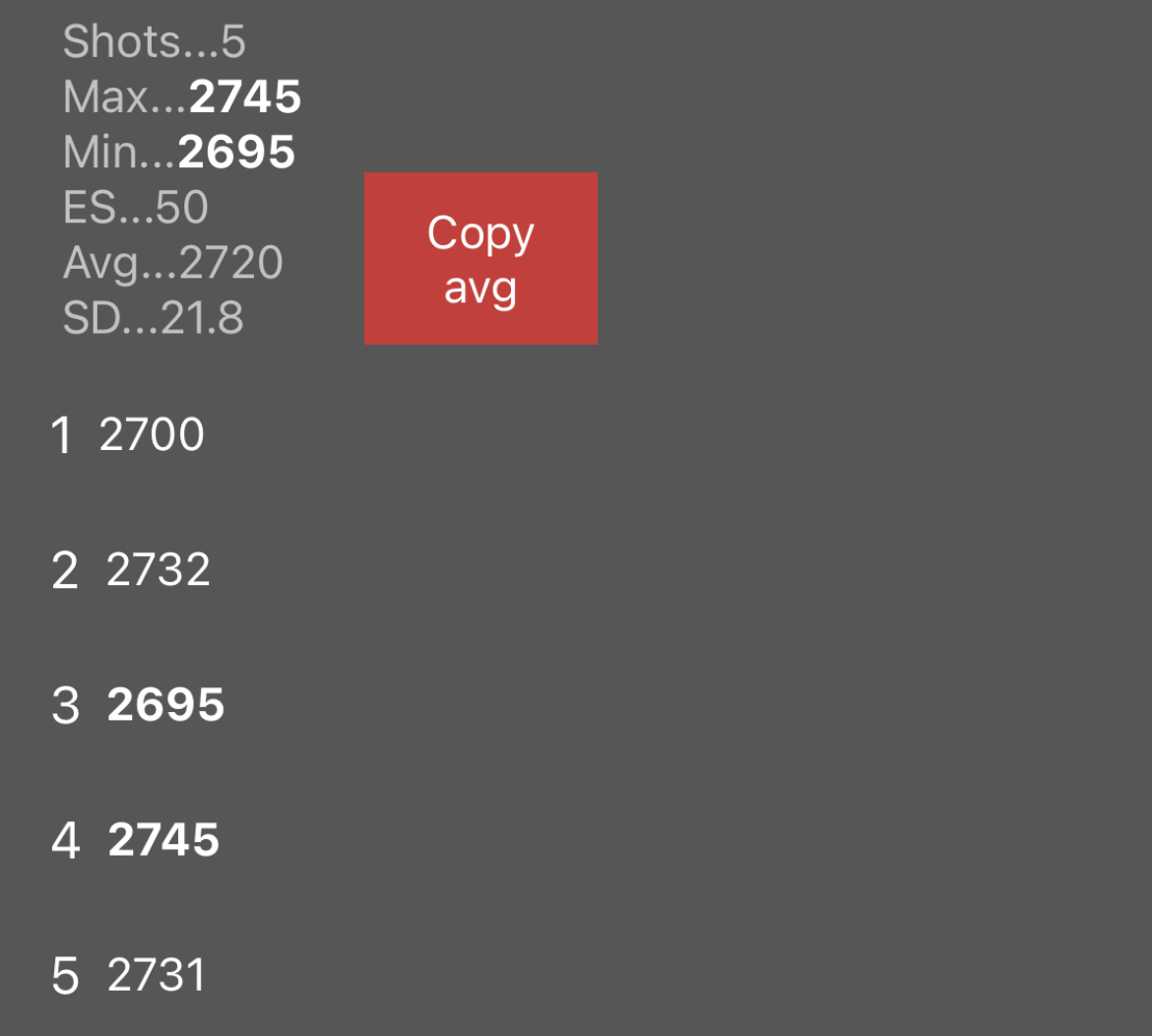

Hornady has always printed tight groups, reliably sub 0.5moa @ 100yds for me... but with absolute dogshit SD/ES. See photo - Laughed & quit chronoing after that. Took it out to 720yds & the velocity difference definitely showed

You'll see people comment on the felt recoil from a 153.5gr versus a 140gr... it's very real & IMO the 153.5gr is an improvement for spotting impacts.

With factory ammo, Berger has been more consistent (10-12fps SD) than Hornady (15+fps SD) for me. That said, @ 700yds the 50 ES I saw is only what, max 0.3mil difference? If Hornady is working for you & you're familiar w/ the ammo, it may not be worth a change... esp if you're not seeing the SD/ES I do. Just throwing something out there for you
I've shot Berger 6.5CM factory ammo that had worse ES/SD than that. I also got a lot of 300WM 215gr that the ES was almost 100fps. I've had my share of issues with Hornady factory ammo, but the Berger has been bad enough on multiple occasions that I won't buy it anymore.
I've had some Hornady lots that had 40-50fps ES but its usually 20-30 which I consider very good for factory ammo. Even the cheap american gunner is usually in the 30fps range and it can be had for a little over $1/rd.

Yeah, I'm probably being a little picky. Just used to getting sub-8 SDs w/ handloads w/out putting in too much effort
