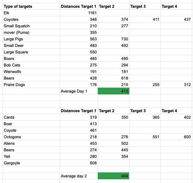

    Avg target distance is around 450yds over 20-22 stages of the matches I've been to in UT,WY,MO,ID,CO and CA. I know @hic28 calculated the avg distance for his match and it was around that figure.
    yep, here are the exact target types and distances I used last year. 2024 will be completely different as I already pulled every target down and am working on a completely different course of fire.
