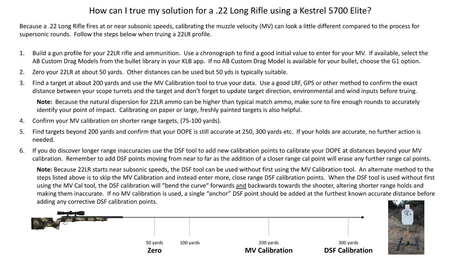

Hi all, new to site and looking for some help please. So I got my rig all set for competition and will be doing Nrl22 and just found another club that does 22 prs. So from what I’ve read the furthest I see is 400 yards. So I’m in position that I can afford a kestrel and was considering 5700 elite. But I’m starting to get confused because the more vid I watch and more I read it seems like it’s really only beneficial to longer distances than what I’ll be doing. Case in point just watched a video with Brian Lintz and even he mentioned 200 300 yards weather not that important. I have no plans to move up to bigger guns or purchase another one. So my question is will my StrelokPro be good enough for what I’m looking to do or if you think kestrel, is regular 5700 good enough
Thxs guys

300 yards is an awful long way for a 22LR bullet. In my solver for SK Std+, dropping from 60° F to 40° F results in needing another 0.4 mils come-up. That’s right about enough to take you off a 2 MOA target, assuming you broke the shot on the center of it.
OP, I’d say you need to input local environmentals into whichever solver you use, but using a local weather station’s info should be sufficient.
I’ve been using my 5700 sportsman for my 22 shooting this past season and the way environmentals change the impact and dope is enough to keep me using it. I shoot out too 350 regularly and tried 400 a few times but going to be attempting 500 this upcoming season. Will be happy to have it the
The paid Ballistic AE, Sterloc pro and others need environmental for RF. The 5700 Elite is 100% worth the money. You also need a quality Chronograph to know what your bullet is doing across different temperature ranges. The data from Extreme Hot & Cold with 15*-20* differences in between the better output data you are going to get. Good Data in equals great data out. I carry my RFs out to 350 regular. That is our RF only range that is 15 miles from my house.
The dope to 200 is going to be real close if you choose one of the CenterX Custom curve models. then a Cal DSF is needed from 250, 300 and 350 if you can get those ranges or real close to them. I would start truing and testing my data at 150 then bump out in 50 yard increments. Always start close and work out. If you go the other way it will erase all the long data you put in. I found that my rifle and data had 1 adjustment at 300 that needed a -.4mil drop correction over what it called for.
BC changes based on velocity. For out to 200yards or so people generally use something like .135 to get it pretty close through the spectrum of 50 to 200. For example at 50yds, BC is .172. At 300 yards, BC is .11 (based on the velocity generally).
When taking shots out to 300-400yards, I like the Kestrel Elite's custom curve from AB that has basically measured out the BC all the way out to 600 yards. You can do it yourself with DSF as well.
Other benefit I have is I don't worry about having to pull out my cellphone the whole match long.
Other thing though if you are thinking about dropping coin is the new Sig binos that have AB Elite built into them.

Maybe I got lucky but my Kestrel AB Custom Curve out to 375 has been spot on for 16T.
For my 12T though I need to start DSFing at 200y because I actually have less drop. Looks like at 200y I'm already at .1mil less drop. I'm curious how it'll be out to 400y but no easy way for me to test this. Right now I haven't bothered with DSF, but I'm using the Custom Curve, but just running it with 15fps faster chrono which has held well for both 100, 150, and 200.
So my v3 arrived today, can’t get out till Saturday but are you saying with chronograph and kestrel you can use custom curves and get exact dope. The range I use only goes out to a 100 yards
Thxs guys
This may have been user error but....
I have a Kestrel 5700 Sportsman. I could never get itto give me good data with .22lr. Didn't matter how much I trued it I could either get it accurate up close or accurate at 300+.
I did upgrade my sportsman to the elite software and it works great with .22lr now.
All that being said my strelok pro has been great for rimfire too. I zeroed at 50 yards. Trued my MV at 100 yards. Trues my BC at 200 then tweaked it again at 300 and it's has been great.

Correct the Kestrel Sportsman doesn't have a custom curve. A custom curve basically will adjust BC throughout the velocity range. A standard curve is just some set BC throughout the entire calculation.
Strelok Pro has the multi BC which basically you can do as well. Just put your dope at the multiple calculated distances and it'll true the BC.

So I’m new at this if I use my v3 and put in velocity than choose 4 or 5 different distances on app than goto multiple bc setting and add that dope it will tweak bc and be more spot on. I don’t have access to more than 100 yard range until day if my first event couple hours from home
Thxs
Thxs
I assume you mean Strelok. The multi BC setting is for published banded BC's (ex; Sierra or Hornady), if you had the ability to measure BC at distance (Oehler, ShotSpotter) you could use that.
What you are looking for is the truing function, it is a button that has a target with an up/down arrow.
A short press gives you the classic method which is a velocity or BC adjustment at one range, a long press gives you the new method with three range entries.
Ok so I enter my velocity from v3 I have 50 yard zero than I would say put in 100,200,300 yards see what StrelokPro says and if different than what it says to get on target enter those amounts and I’ll get true bc
No, you'd enter whatever distances you shot at and the actual holds that were different than what Strelok predicted.
Example; the predictions at 100, 200, 300 were 2.4, 8.0, 14.6 Mils. Your ACTUAL holds to hit were 2.8, 9.2, 16.0 Mils. You would enter those distances and the holds you used, it would then adjust the BC or Velocity to try and get the predicted curve to match these measured results.
Ok and as far as velocity I just enter from my v3 say 3 strings of 10 average ??
Sean
Sean
As many as you are comfortable gathering, the more shots the more accurate your numbers will be. Unless using an off barrel mount on a Magnetospeed your going to want to limit things just due to its impact on accuracy cutting into your practice.

I didn't have a chance to shoot my new CZ 457 rifle past my original 50 yd zero and still wanted to try NRL22, so I plugged in my data into my Kestral and shot a match. It was dead on up to 100 yards. It was a little off at 200 yds but I still had fun. I need to chrono my lot of ammo to get a better solution past 100 yds and get some actual time behind the rifle to get my DOPE. Good luck.
You don't necessarily need the chrono data, it helps but you'd still probably have to true it up in the Kestrel. This is the process I've used to calibrate my 5700 for the two .22's that I shoot matches with.
Using that method, my dope has always been pretty solid to 500 yards.
Shoot paper, 10 shot group to really make sure your calibration and zeroes are good. I see people who put out steel at 200 yards, like a 6" and say well I landed most hits on it, .1 mil at 200 yards is .72", so there's about .83 mils of variance on that steel. Shooting paper, and really looking at the avg POI is the best way to ensure proper calculations.
Make sure your 50yd zero is correct as well. People go "close enough" and then they go oh my 200yd is .1 high, so I'm going to true for .1mils high and that will give you a velocity change, but really their zero was .1 off. .1mils at 50 yards isn't much, .18" so check your zero precisely.
