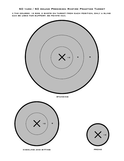

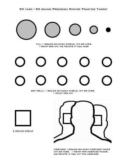

I made up these rimfire targets to use at the range to work on different aspects of shooting that I might encounter at a match. All you need is 50 yards and 50 rounds, some barricades, and if you want you can use a shot timer. Keep score to track your progress or create a little mini-match between the two of you. If you have kids or just want to mix it up I also did a "Shooting Gallery" version with ducks and stuff...it's neat.
The first target is basically working on precision with a KYL, dot drill, and hostage target.

And the last page is working on traditional positional shooting positions (standing, sitting, kneeling, and prone)

I'm stealing these. Thanks.
