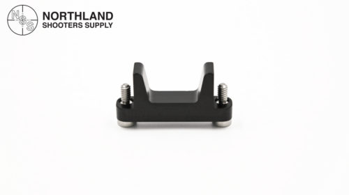

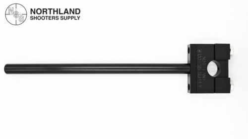

I used the NSS action wrench with their lug alignment tool on my cousins Nuc 1.1
Yes, that means the scope rail was removed to do so but guess what, it went on after everything was done and its straight just like its supposed to be.
Yes, that means I didnt use a torque wrench. But I know what 60-100 lbs of force feels like and what tight feels like. Its not coming off unless I put a wrench on it and its not going to be impossible when I put a wrench on it either. Its fine.

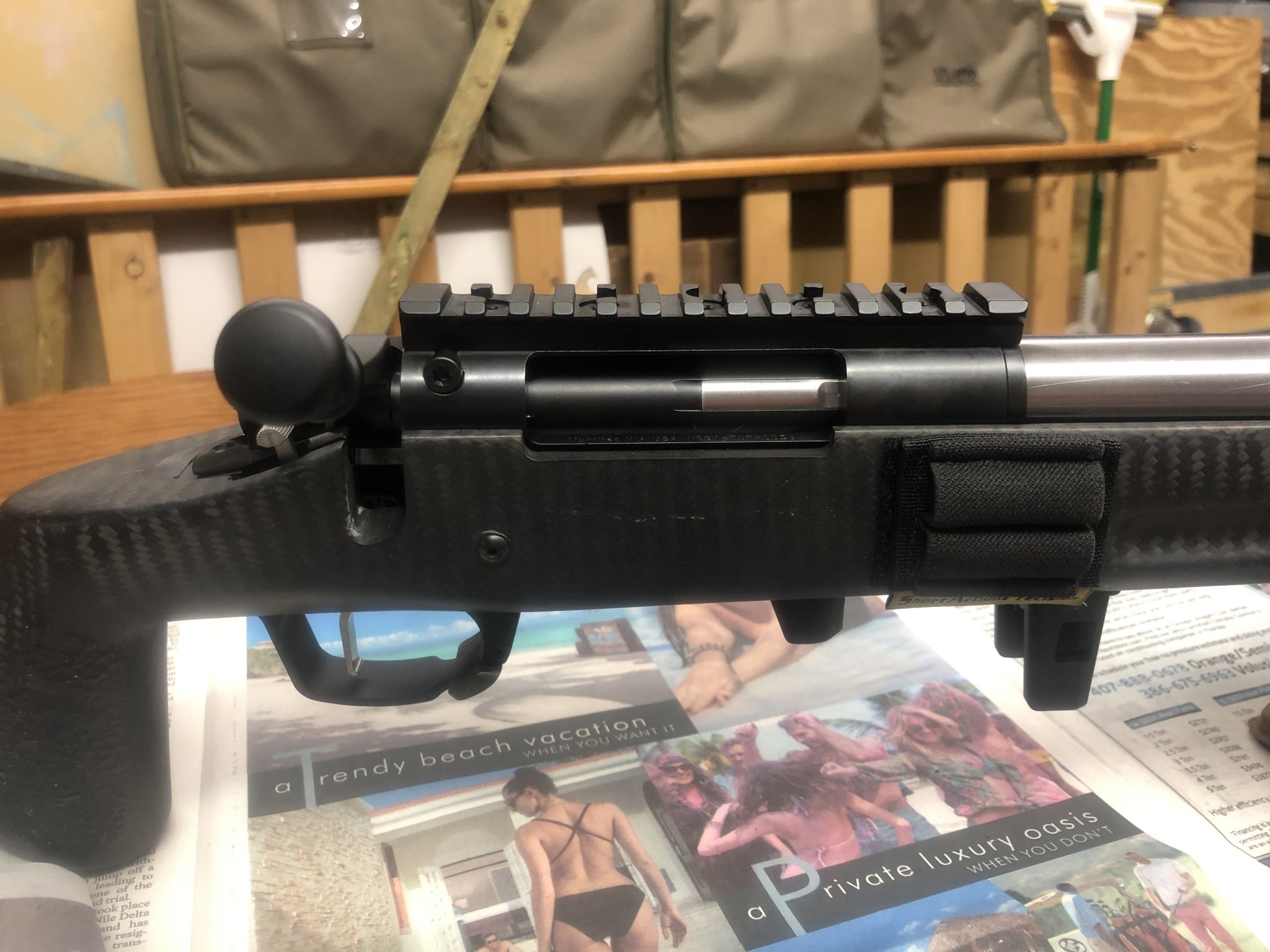

Okay so, we made it work with the Remington style outside action wrench. It took a bit, since we had to mill in a notch to make room for the notched part of the action lug in the wrench.
We had to do this for two reasons: one is that the notch made the lug not fit in the wrench since a Remington lug does not have that. Two is that the lug notch sets pretty tightly into the removable rail on the action by design. Since the rail had to be off of the action in order to use the outside action clamp-style action wrench, we had to have a way to properly index the lug so that once the action was torqued to the barrel, everything lined up properly.
We made sure that the clearance slot that we milled into the action wrench clamp piece was set up to index properly while being torqued.
Fortunately, since we took our time to set it up right, it worked as planned and everything lined up well when done. If I had been smart, I would have taken a couple pictures to illustrate, but I’m not that smart.
