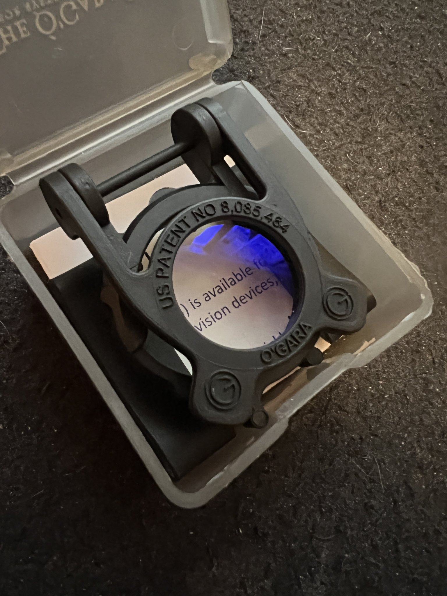

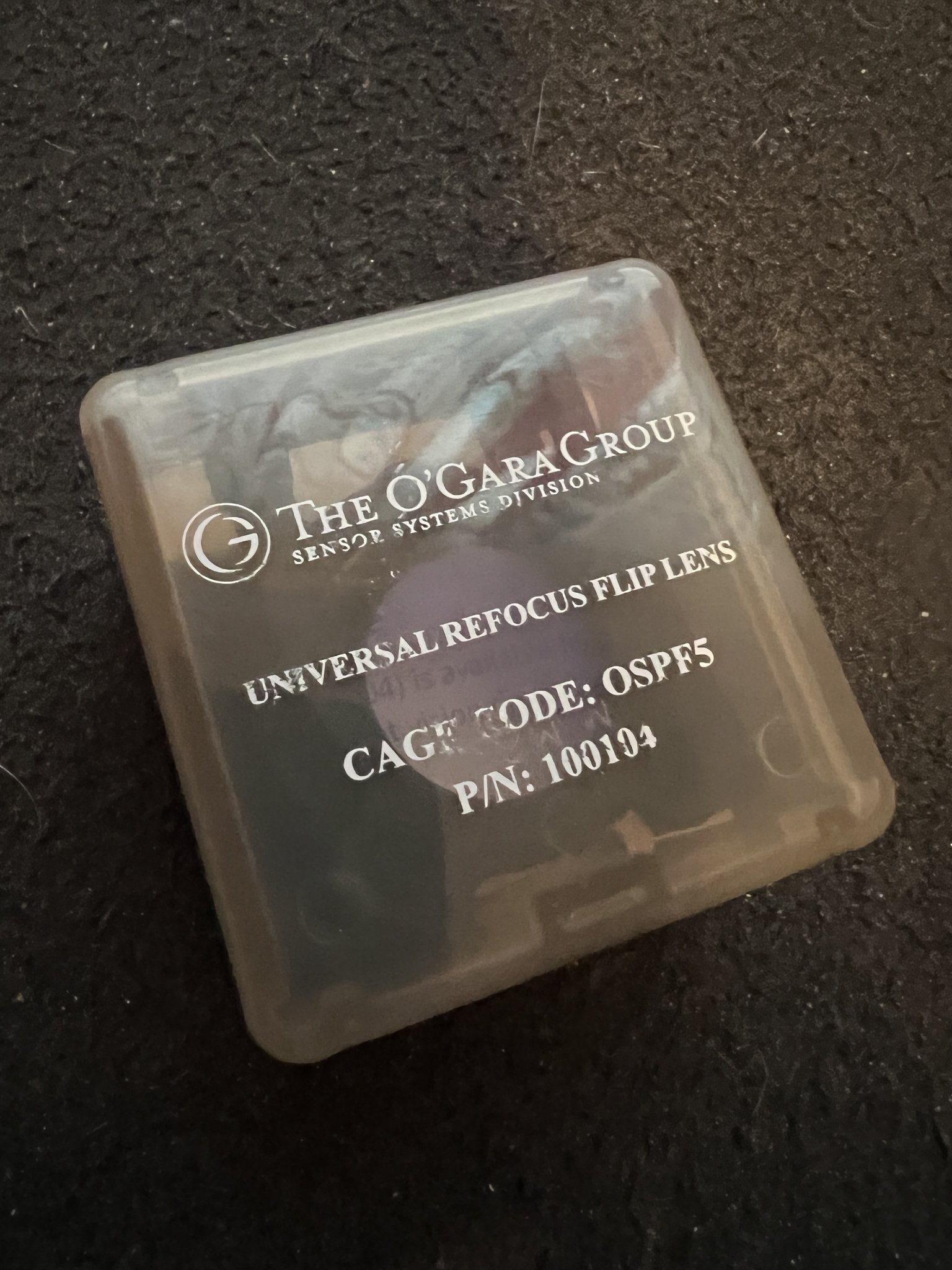

    As for your first problem : I use Universal Refocus Flip Lens

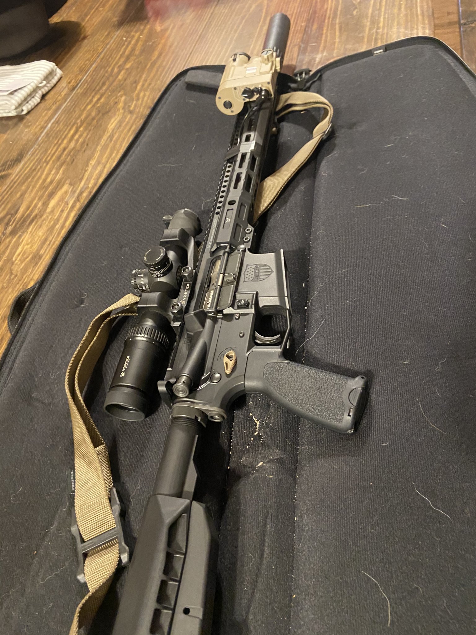

    Went out for the first time with my new milspec UWP L3 PVS14 and dbal d2 for the first time this week and have a couple questions.
    1st, is there anyway to make the pvs14 focus closer? Doing anything with your hands, or looking down to watch your step is almost useless.
    2nd, how the fuck do y’all see anything after the first shot? I’m shooting a 223 AR with a YHM turbo. After the first shot there is a couple seconds where you can’t see shit from the gases, is is impossible to see where a pig went, or do a follow up shot because the gases block everything out.
    3rd, does anyone use IR flood lights on the front of the their vehicles? With no moon light and a lot of tree canopy it’s a little hard to drive blacked out, on that same note, any good tips for blocking out the guage cluster and radio? I just taped some cardboard over it.
    Thanks for any advice
    If you need to look at your gear to operate it, you need practice, not a refocus lens. Close focus is for temporary detail work, like reading a map. For that, turn the objective, then reset it. When I teach the NVG class here at Gunsite, we stress the ability to work all your gear/systems eyes off.

    I tend to disagree on the focusing advice he gave to some degree. Get a cap that fits well on the obj end of your PVS. Punch a hole in it with the case mouth of an empty 5.56 casing. Put it on the NOD. Take it out and look around. Everything up to about 2-3 ft away will automatically be in focus. It only won't work on VERY dark nights.

    Either I forgot there was a focus adjustment in the front or I’m just a tard and didn’t think to try to adjust it. Just tested it out and that’s all I needed, I only needed to focus on something 2’ in front of me once, and needed to watch my feet going down a rock cliff a couple times, that would have been the solution in both instances to just adjust the focus temporarily.
    Flip caps with a hole I don’t think would have worked. It was dark as fuck out there, zero moonlight, zero ambient light, soley relying on starlight. I was pretty happy I bought a milspec L3 UWP tube this week. I don’t think a lower spec or filmed tube could have kept up, even the L3 was struggling. Then again this is the only tube I’ve looked through so 🤷🏻‍♂️
