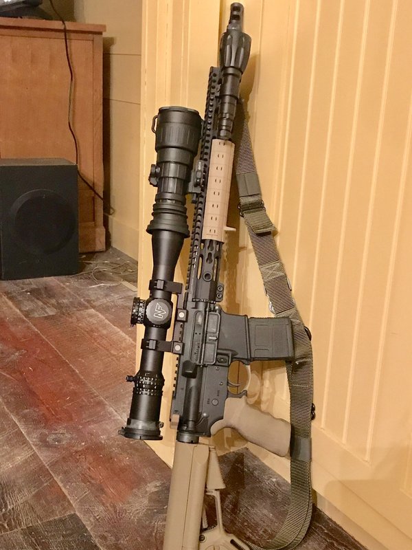

Here’s the setup. Looks like it lines up pretty good to me, but I could be wrong.
If it was me, I would test it ... zero without clipon ... then mount clipon and repeat ... test it before going hunting ... that seems simpliest way to find out if there is an issue.
