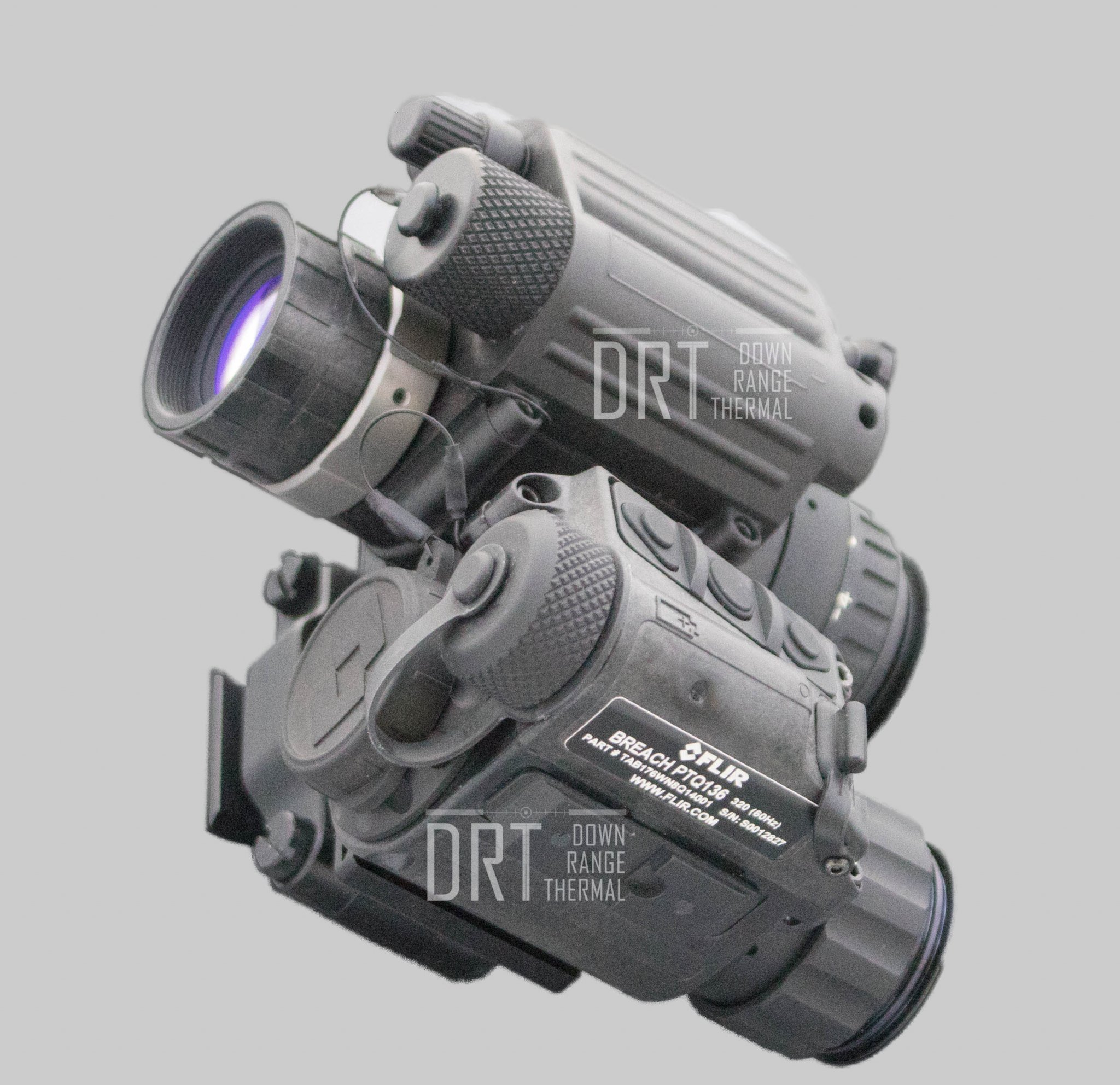

I need to weigh this system together but should be about 24 ounces all up so it would probably be a little heavy. The skeletonized bridge we have built for us by IC/MOD is the lightest avail and works perfectly with the breach and 14 lining up correctly. The RQE is a thing of beauty though.
7039183
@DownRangeThermal what mounting system is the NV using in this set up? It's this the vyper / hyper housings @wigwamitus was speaking of earlier? Or does this function with the standard single screw?....

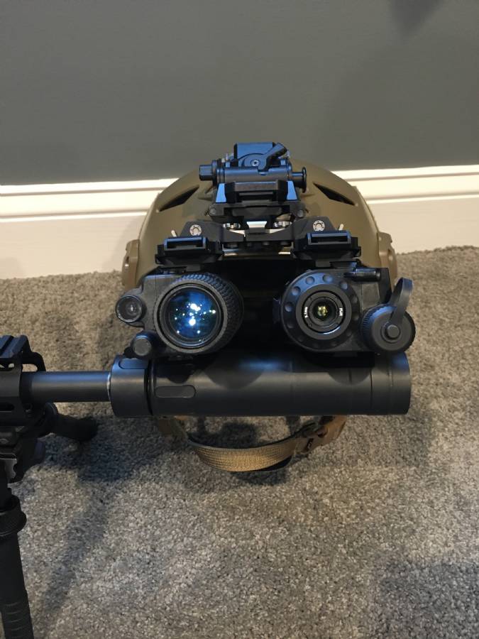

Mum14 paired with a breach using a RQE bridge. Nice light weight setup
