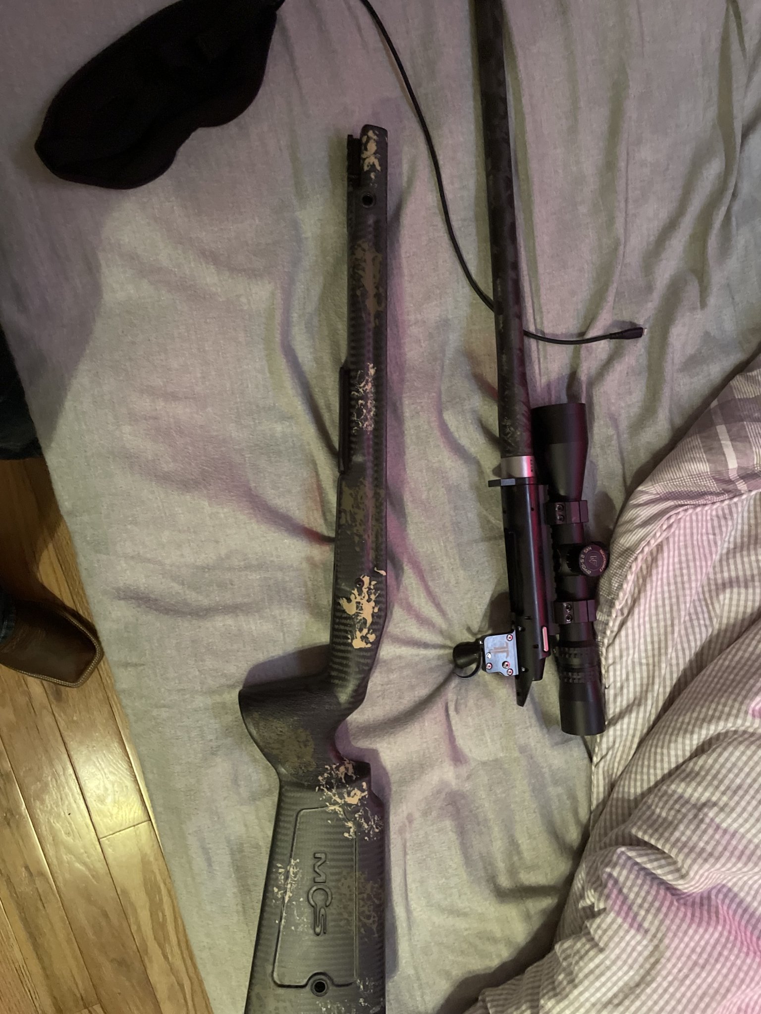

I’m running that same rifle, I threw a 4-16 x50 atacr F2 on it, I absolutely love it… personal preference on the focal plane, for a hunting rifle I like second for close in fast shots. I can’t use an illuminated reticle where I’m at so trying to pick up the crosshairs on 4x in a first focal plane in low light is a bitch.
Rifle is right at 9 lbs

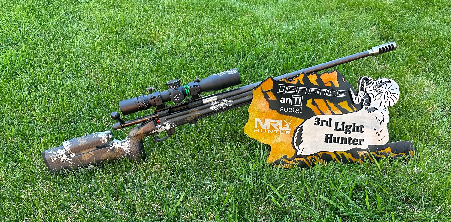

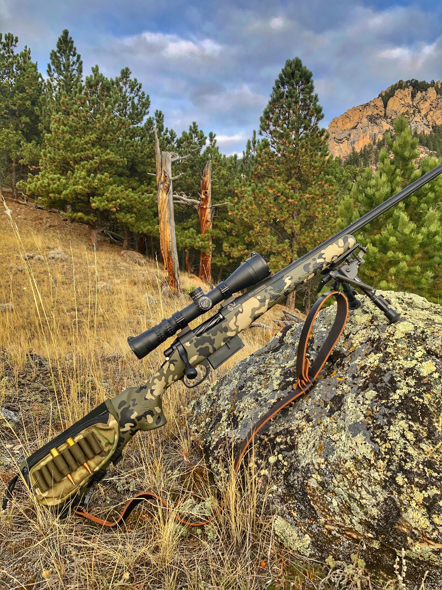

I run two of the 2.5-10x42 compacts. Killed many elk, deer, bear, speed goats. Great hunting optic and it will do everything you ask of it.
I'm not just guessing.... ;)
FullSizeRender.jpgIMG_6423.jpgAimee 2020 elk.jpgIMG_2738.jpgIMG_2646.jpgIMG_2559.jpg
Any pictures? I’m thinking about the atacr now, maybe the 4-16x42

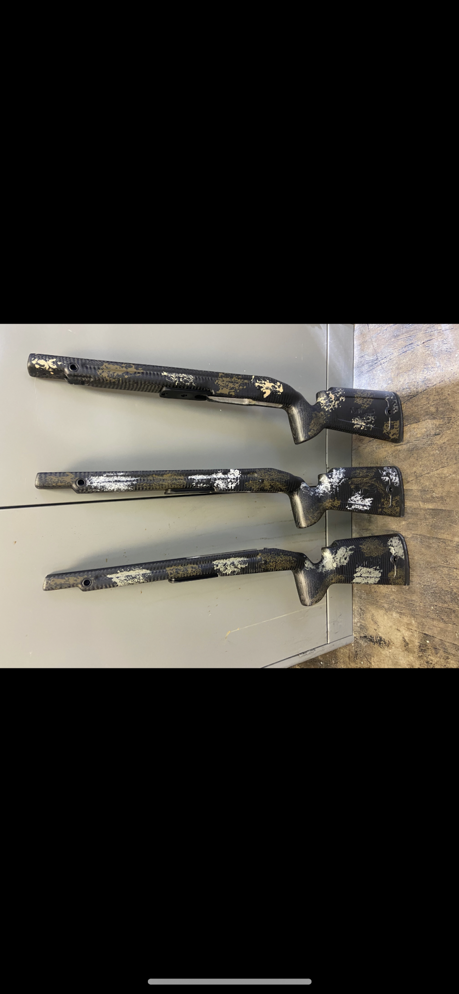

I went with the gap camo, I was looking at the Tommy bahama, looks good, I’m doubting my decision with gap as well lol

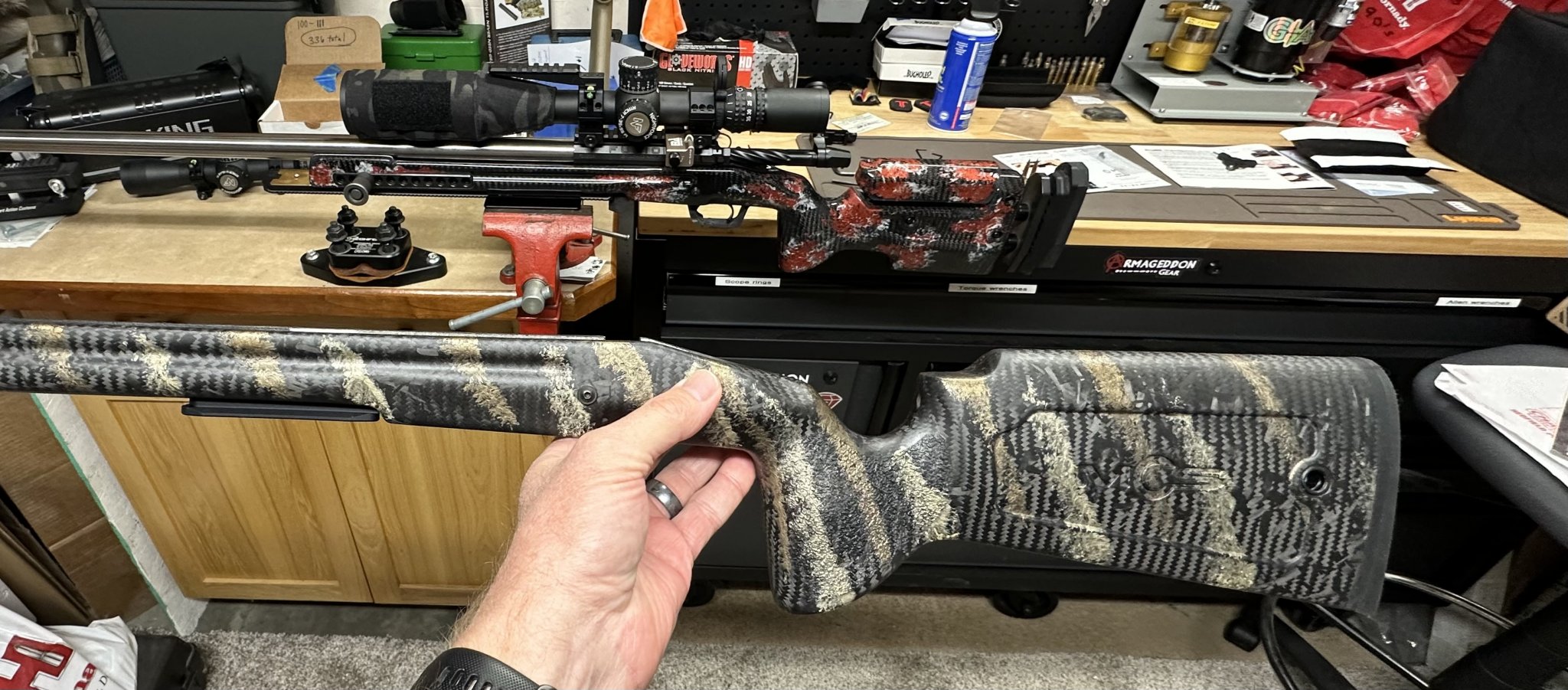

I had a couple EH1's in GAP camo, it's a nice pattern in the elite shell. I'm a sucker for green and grey though which is why I leaned towards Tommy Bahama this time. I'm looking forward to getting the PH and comparing it to my HNT26
These are the ones they had in stock the other day, wish the gap paint job was a little less splattery looking like the other 2… still nice
Reactions: Sendero_Man
That's a good looking stock. Do they not come with the picatinny forend rail? I was under the assumption they did, I didn't specify when I ordered mine. What BA are you putting in it?
Yeah I asked them, just were not installed in those pictures, but yes they do come with the stock, origin with a proof sendaro, Hawkins hunter dbm
OK, I wasn't sure but that's good to know. That would be a sweet setup with a 2.5-10. I'm going to use the PH with my 737R to build a light target/varmint rifle with a 4-32 NX8 or 5-25 MK5.
