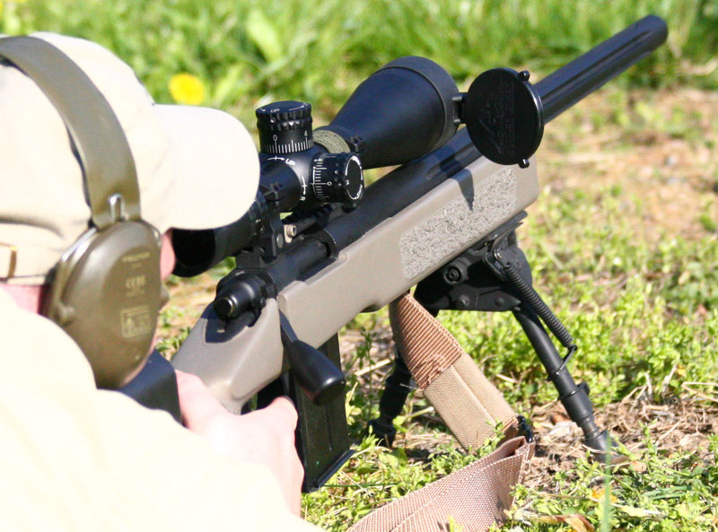

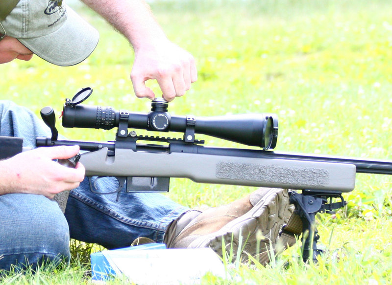

Robert is right, he wasn't just trying to get you to go away, there was a short period of time when there were no rev lines under the ZS turret. I had an early NF 3.5-15 F1 with 5 mil per turn turrets and there were no reference lines under the elevation turret but there were under the windage. The windage knob is essentially the same part between ZS and non-ZS models which is why it was present but the elevations were all different. I guess the thinking was that if you got lost in your elevation adjustments just dial down to the zero stop and start over. I think they started showing up with lines under the elevation in 2010 when they came out with the High Speed turrets.
