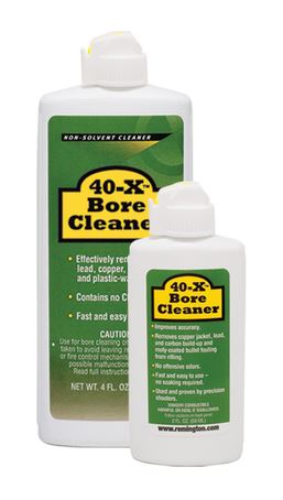

Nylon brush and this:
Fuck your rifling.
