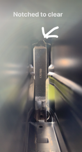

Yep, my mdts let me go really long. My 6.5 creed stuff ends up a 2.890 or so but I have plenty of room to go still. Had to notch the rem700 but in an origin it clears fine. Just get a mag without the binder plate, your nuc should handle it.

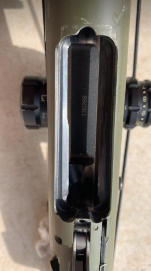

The nuc is already clearanced but this is what it took for my rem700, you can see all of the extra length possible gained.
