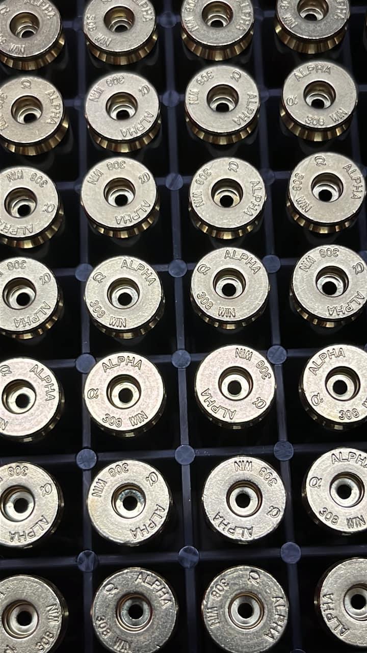

I ordered Alpha M brass is 6.5 CM and 308 and a quick glance reveals there have been issues with this brass in the past. I thought this brass was the shit. Is it not? I wanted to load H4350 41.5 grains 143 ELD-X and go about my day.
The only issues I am aware of were pre-OCD and I'm not sure they were very widespread either. The OCD stuff I have is great, I'm sure you will love it.

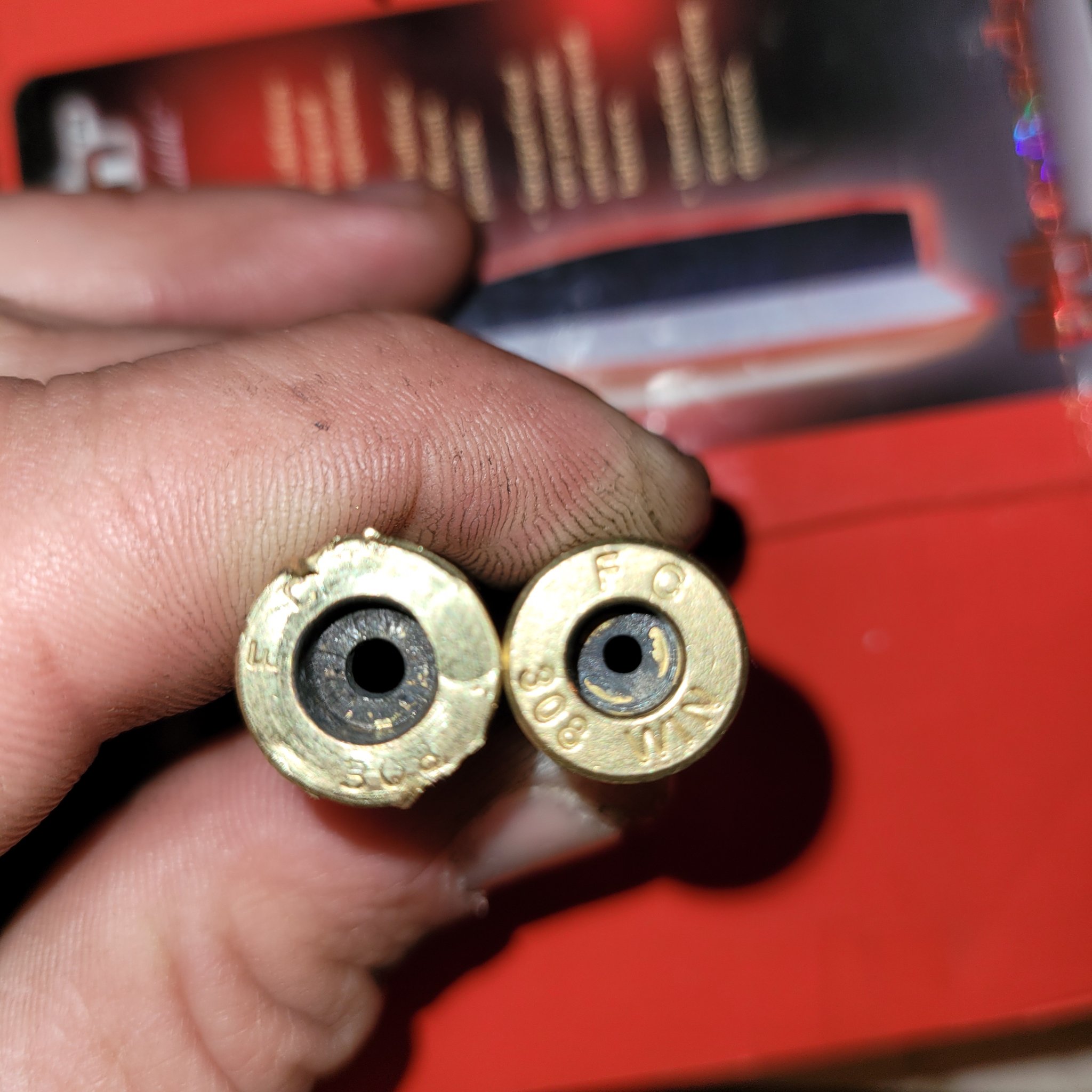

That's a fine statement and all.
Not all firearms, owned by all the people that follow that statement, are made to the quality of Desert Tech.
Case in point. View attachment 8076956
Great load in WIN cases, not a great load in FC cases. Had case capacity been observed in each case. Or a simple 5 round ladder test in powder weights working up to the load there would of been no issue.
Shrapnel blown reward and face peppered. Okay, but could have been worse.
Don't give shitty advice.
That can also happens if you accidentally mix just one Federal or Lake City case in amongst a batch of Winchester. It has happened to me. And yet I don’t go through my batch of brass one by one inspecting head stamps to make sure it doesn’t happen again.
One could also measure the case capacity of every single one of their cases just to make sure that the manufacturer didn’t put a little too much brass in one thus reducing the capacity. One could also stomp up and down and make a coalition and petition the manufacturers to all make cases with a standard internal capacity, for safety reasons. Where does it end?
It is, after all, a minor mishap in the final analysis. The pocket is blown and some gas escaped. This is why we wear shooting glasses.
Don’t foster paranoia, promote common sense. And common sense says maybe that Winchester load oughta be reduced so if you accidentally get another FC case mixed in…
