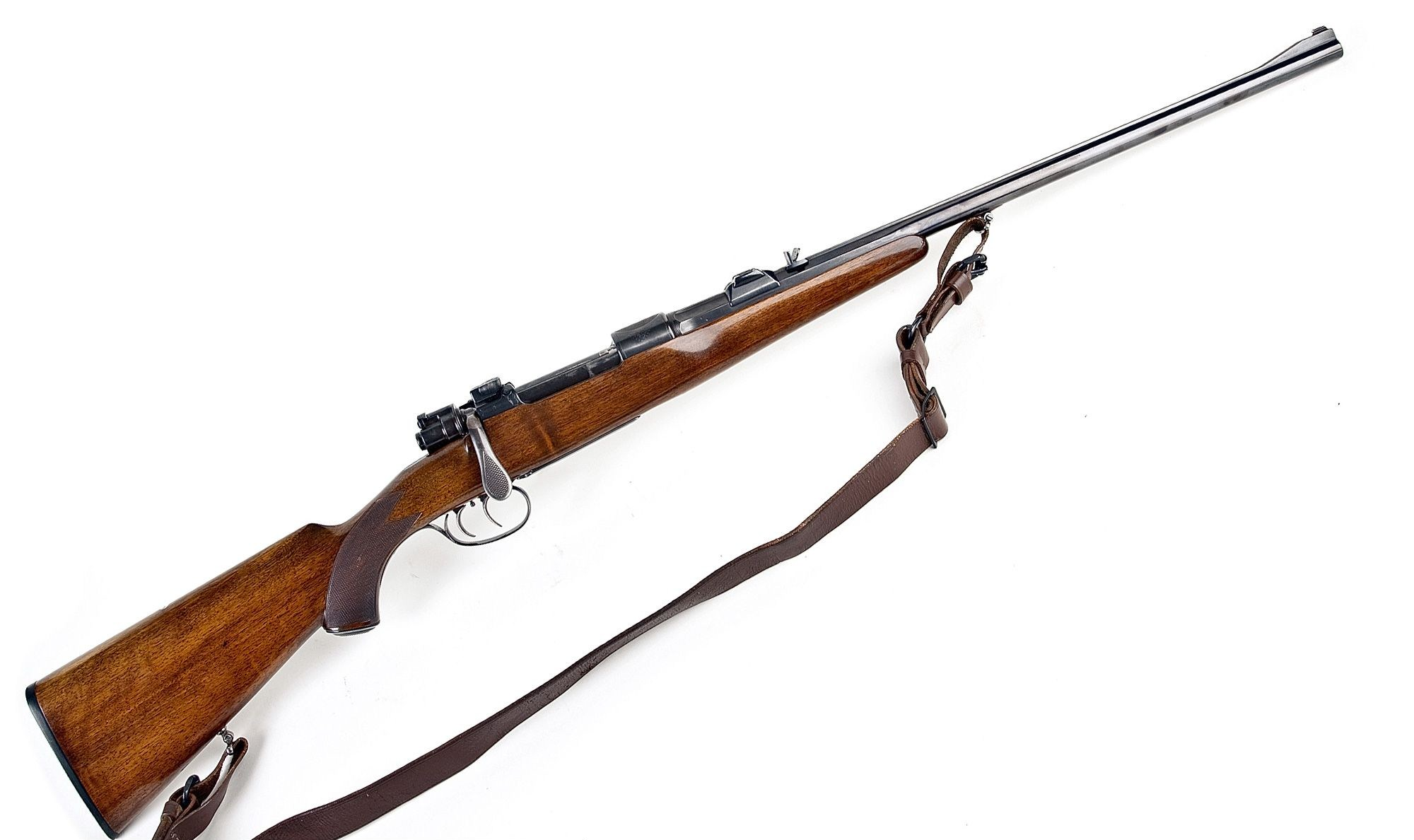

Hi all. Sooner or later (hopefully sooner), I'm going to start on a Mauser build, #1 part of which is going to be rebarreling it. At the moment I'm slated just to get a plain round barrel from Lothar-Walther, more or less matching the original, but I've had a thought. Seems like, once upon a time, octagonal or octagon-to-round barrels on boltguns were a thing and I'm thinking maybe I'd like to have one on my Mauser for some style points since otherwise it'll be a pretty plain rifle. Here's a couple pics of one in the film Public Enemies, handled by Christian Bale. Y'all can see that it starts out octagonal at the chamber and turns round just about at the nose of the stock.
Rifle:
Melvin Purvis (Bale) taking aim:
Does anyone know of a barrel-maker who can do me one like that, with or without the top rib, if I elect to have it? McGowen will do a full octagon (and blue it and everything) but their twist rate for 9.3x62mm is kinda tight at 1:12 (SAAMI says 1:14.2 and that's what Lothar-Walther uses). I can contact L-W and see if they can do me one, but anyone have other suggestions?

1/2 octagon to round, generally with a full length tapered rib with integral front sight ramp, sometimes you will see them made with an integral sling swivel as well.
When properly executed the contour will actually be swamped very slightly to where the center of the barrel is .015 smaller than the muzzle. In the Mauser circles that I travel in we call it the Schilling contour. Was cool to see that rifle pop up in that movie, seems it would have made more sense if Bale had used an '03 sprg. Or maybe a '17 Enfield. I was surprised and had to look twice, damn that was a Mauser, very distinct look.

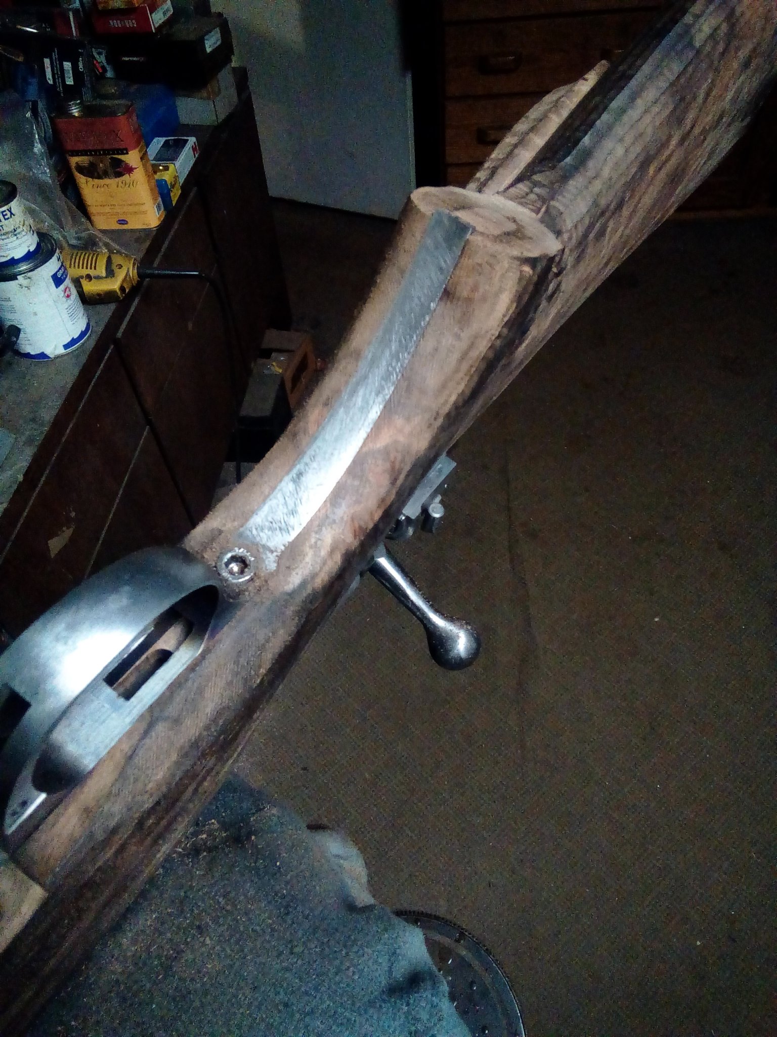

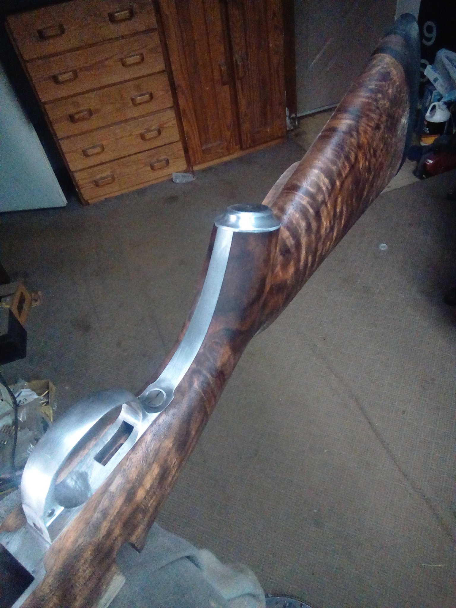

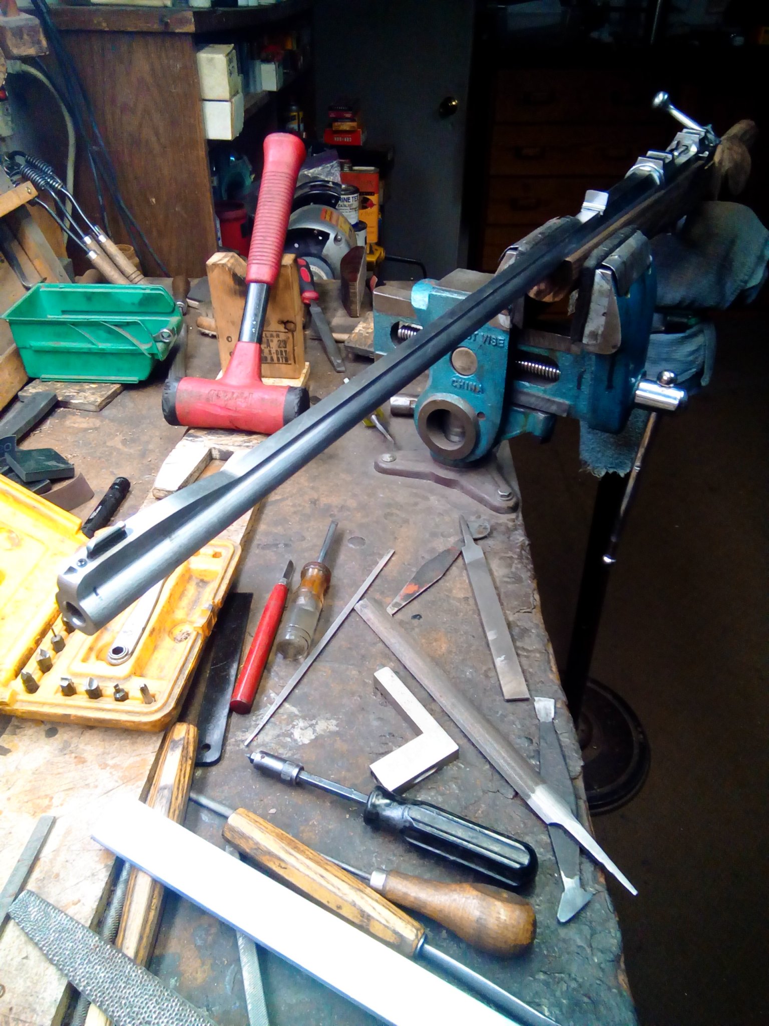

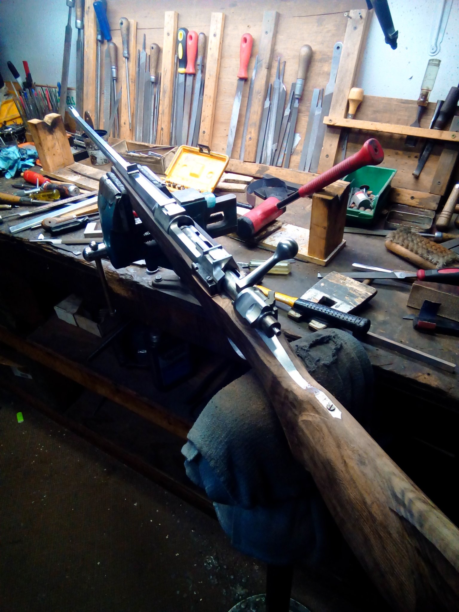

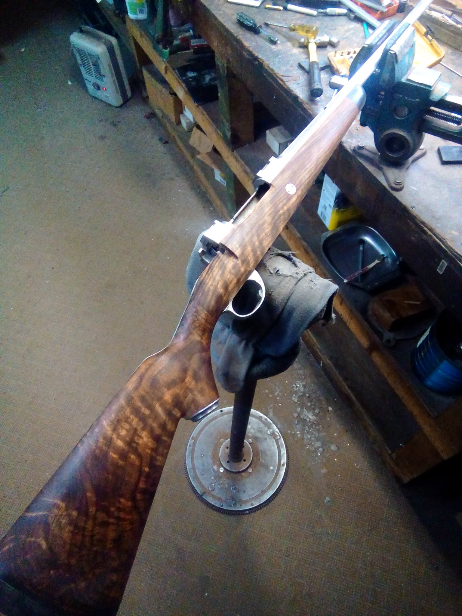

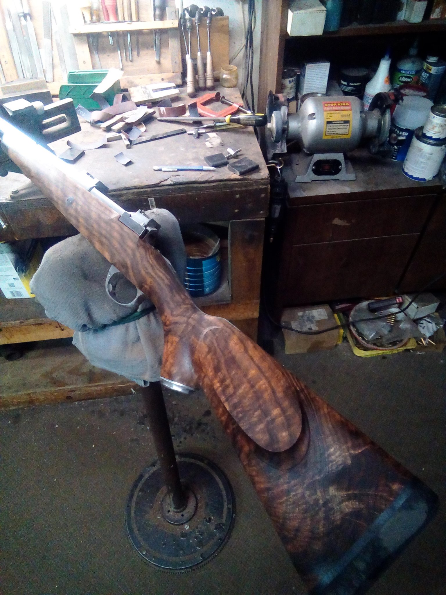

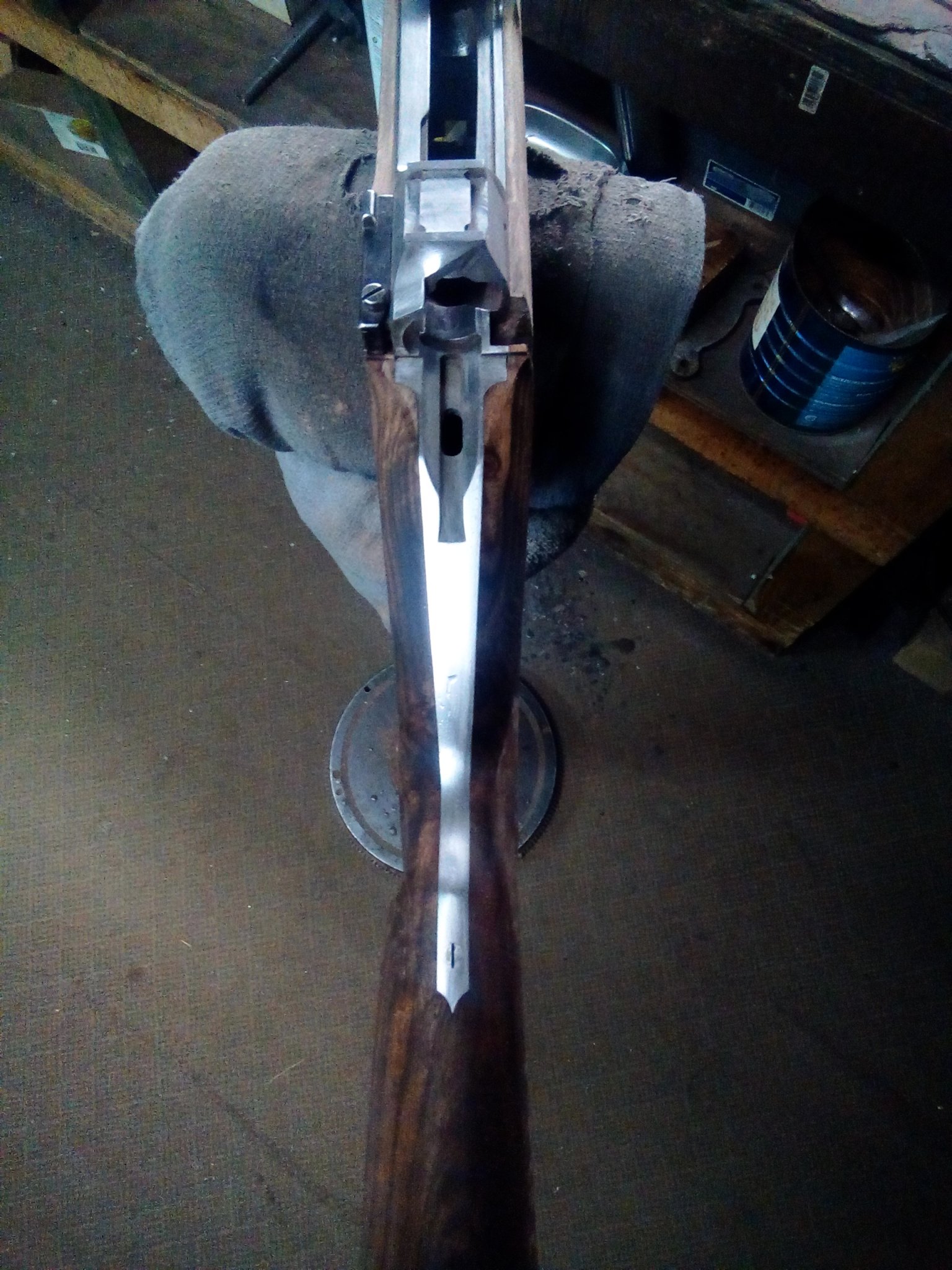

This one is an M98 where I made the action from bar stock with extended upper and lower tangs and I'm also making the stock. For the Barrel we've gone with a CM K&P blank, contoured to the Schilling profile by Morris Melani of Alaska Arms. Caliber is 338 Win.Mag. Kaufmann will be doing the engraving. Cheers.
