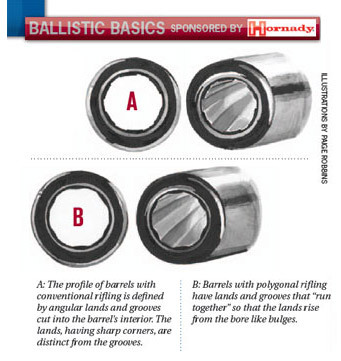

'', the bullets are pressure formed following a circumference and not cut like in traditional rifling (pic. 1) which extends the life cycle of the barrel. Also there is no sharp corner to fill like in the other rifling systems (pic. 1 & 2), therefore the barrel is cleaner and wears more slowly.''

In normal rifle barrels it offers no particular advantage or disadvantage. The bullet will be slightly swaged to conform to rifling grooves or the bearing surface. I don't do any lead casting any more, that is pretty much a dark art and too much depends on the quality and composition of the casting materials and the size of the swaging die relative to the true bore diameter. My H&K USP pistol has polygonal rifling, a hex if I remember right. It is accurate, for a pistol, and I see no signs of copper fouling. As to bearing surface, inscribe a bullet diameter circle inside a hex, octagonal or even dodecagonal polygon and you will find the difference in contact area to be minimal. Rifles, with their higher velocities, need a smoother bore to prevent wearing out the barrel in the rifling area and to promote the higher velocities. Straight is pretty important as well. You will still more likely wear out the barrel throat long before the rifling wears. I don't know enough about metallurgy to know about cold forging vs cut rifling in terms of induced stress, I never studied it and am now too old to worry about it.
