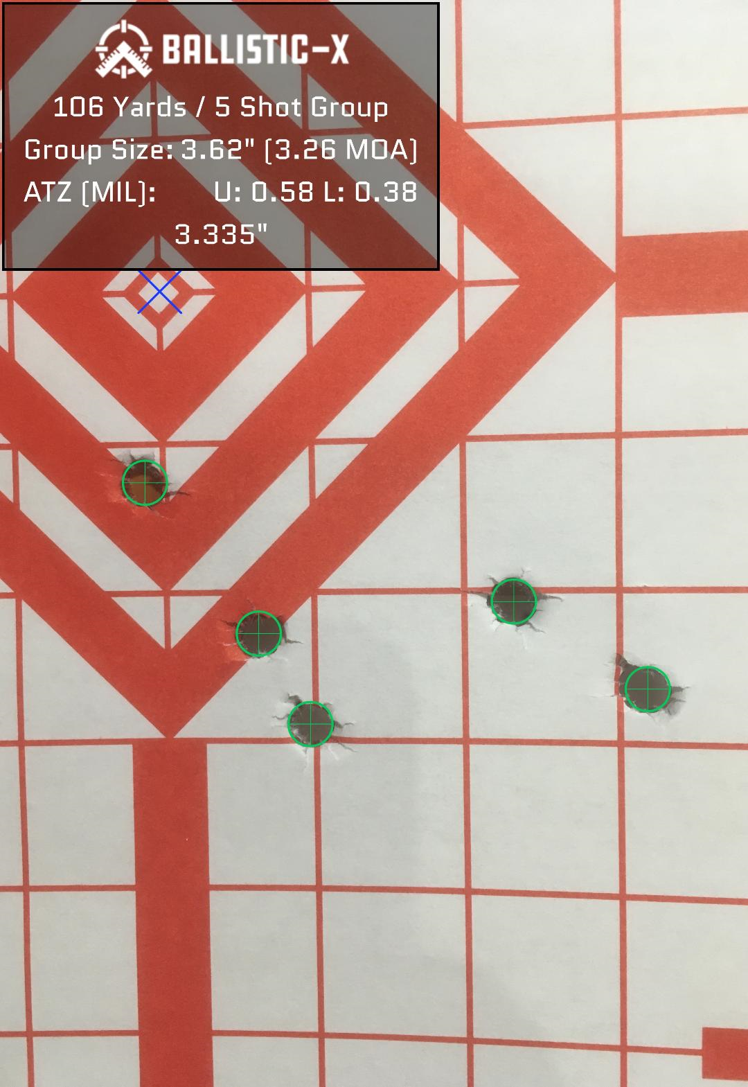

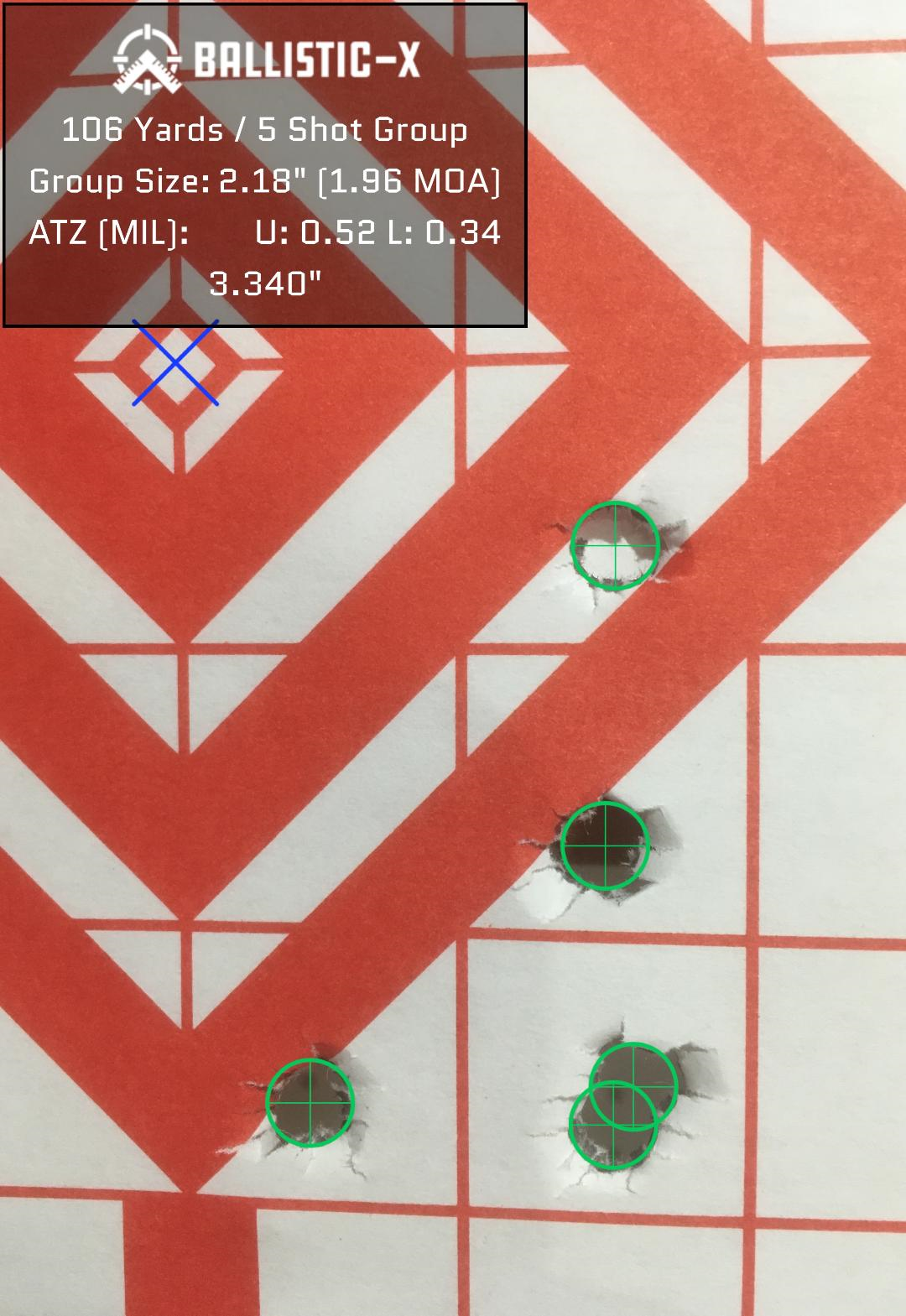

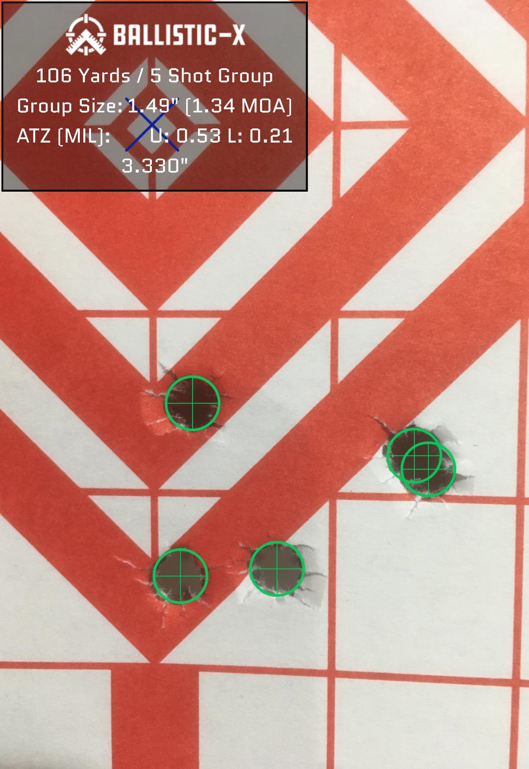

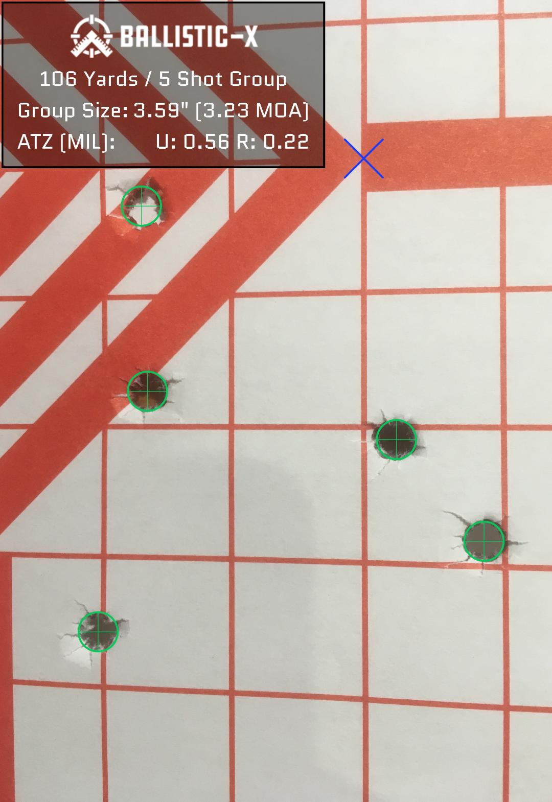

Seating Depth Test 100 yards:
OAL 3.325"
OAL 3.330"
OAL 3.335"
OAL 3.340"
Notes: The seating depth test was as dramatic as the OCW. Group sizes were from over 3moa to just over 1moa with a .005" change in seating depth.
