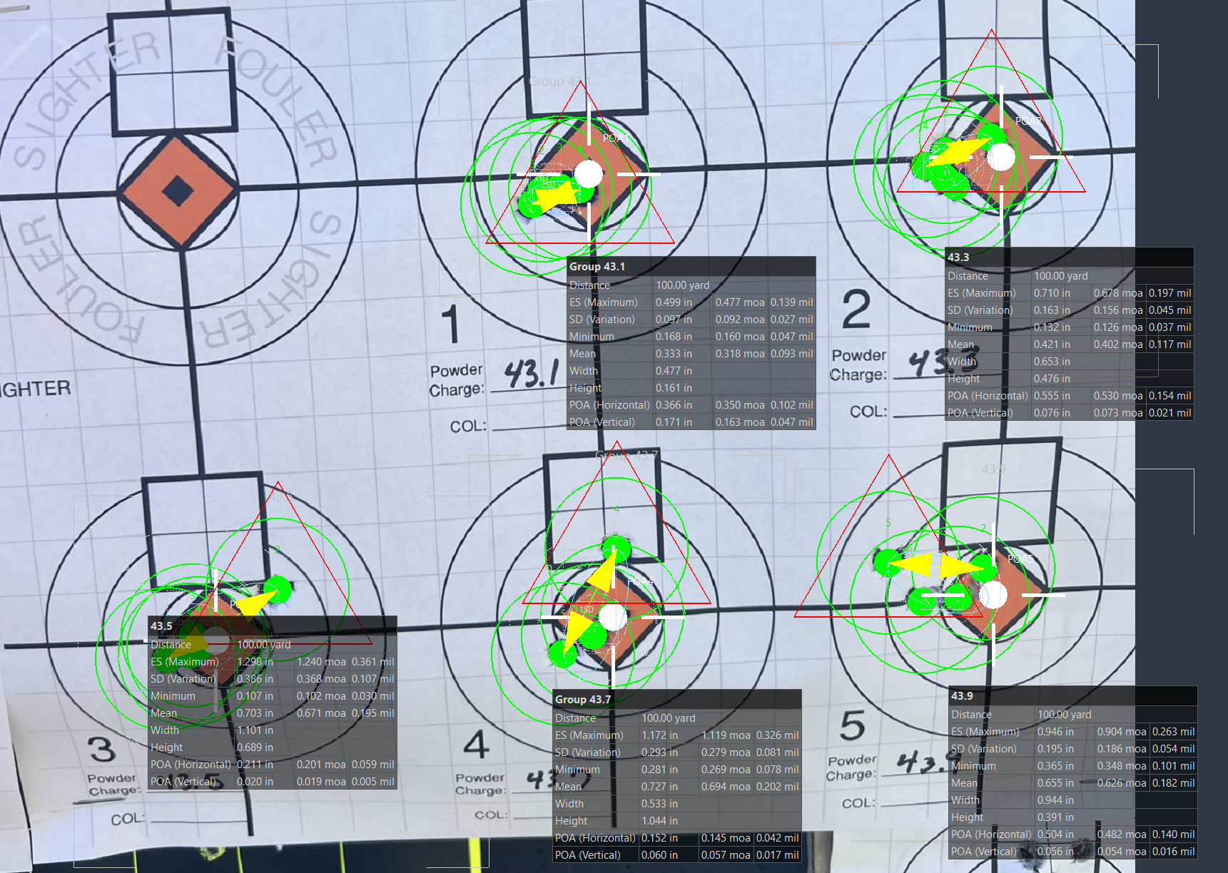

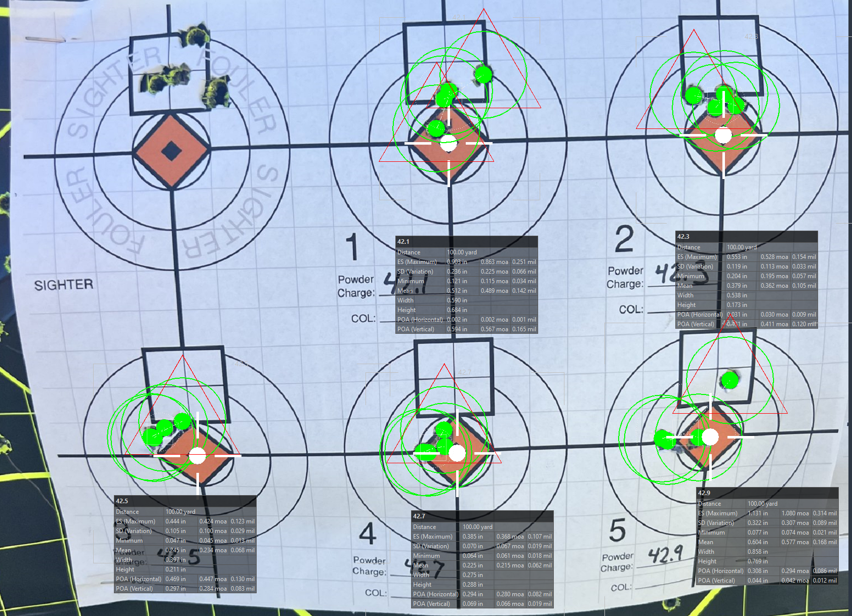

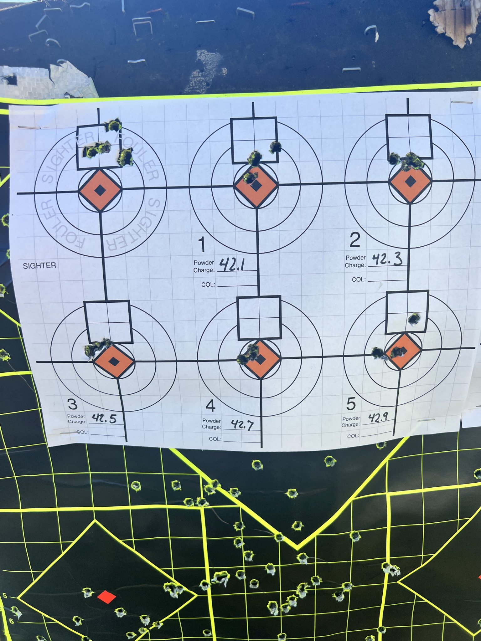

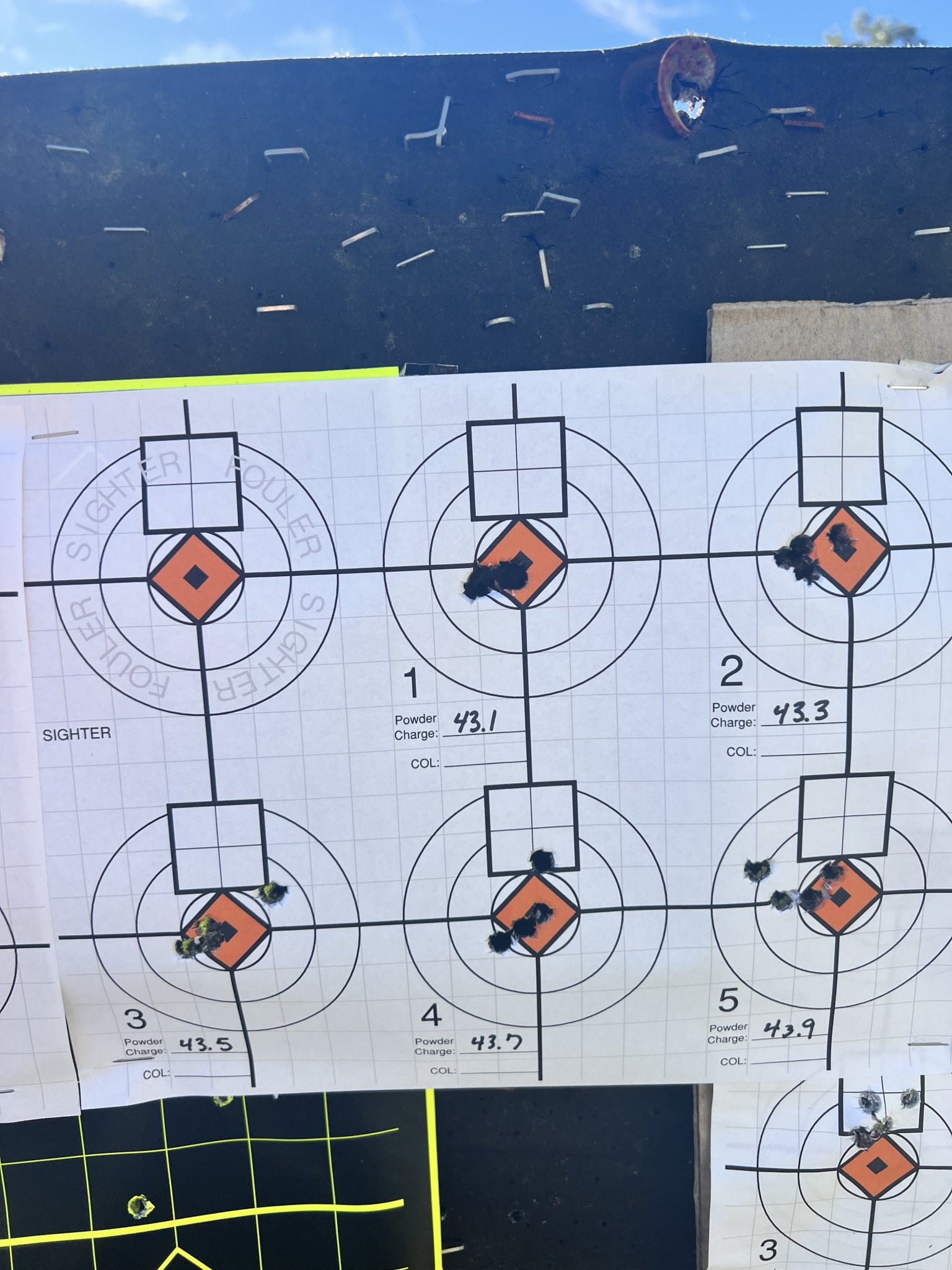

OCW Guys… help me read these!
Jamesl0822
Feb 3, 2020
37
5
6.5 cm
140 Berger VLD Target
All loaded at -.020 from Jam
42.1 - 43.9 grains of 6.5 StaBall
Help me choose the accuracy node by looking at these 100 yd groups.
4 shots each in a round robin fashion. 45 secs between shots, 2 mins between strings. No wind, maybe one bad trigger pull.
Thanks in advance
J
Warning - the results aren't perfect because the image of the target (and target itself) isn't perfectly flat (especially for 42.9 and 43.5), so the measurements are skewed.
Side note and question - is this 6.5cm or 6cm with the 109 Berger VLD? I'm only aware of a 6mm 109 LRHT. OCW isn't necessarily about finding the smallest group "node", it's more about finding a load range where the center of the group of impacts doesn't shift, even if the group sizes are larger.
OCW window would be 42.7 to 43.1 (discounted fliers), choose 42.9 and you'll have +/- 0.2gr allowable
Reason - center of the POI from POA range is 0.082 to 0.102 mil horizontal (0.02 mil difference), 0.047 to 0.012 mil vertical (0.035 mil difference). The differences in the center POI between the 3 charge weights is within most reticle subtension values (many are from 0.02 mil to 0.05 mil sizing).
If you have a center dot reticle subtension 0.03 to 0.05 mil of it's basically the difference between using the top portion of the dot to aim versus the bottom portion of the dot.
On either side of the window (42.5 or 43.3) you have a 0.048 to 0.071 mil center POI shift either vertical or horizontal (from one of the charge weight centers). A shift that is borderline or larger than many center reticle subtension.

I'd choose 43.1 - 43.5 to retest to confirm that there's something good in there.
Reactions: RegionRat and Doom
I totally mistyped 109gr… I’m also working on a load for my 6mm cm but it’s a lot easier to read.
The above test was with 6.5 140 gr VLD Target bergers… my apologies
The only three charge weights in a row you have that don’t have a flyer are 42.3-42.7. I don’t think there’s enough information here to know anything, but if I had to go with something it would be with 42.5. 43.1 looks good by itself, but if you go one charge up or down shit gets weird. There’s no such thing as discounting flyers. The groups are what the groups are. Don’t waste too much time trying to find the perfect charge weight. Pick one and shoot it.
I’m going to look closer at 42.5 - 43.3
Thanks for the ins
Reactions: ShtrRdy
6.5 cm
109 Berger VLD Target
Thanks in advance
J

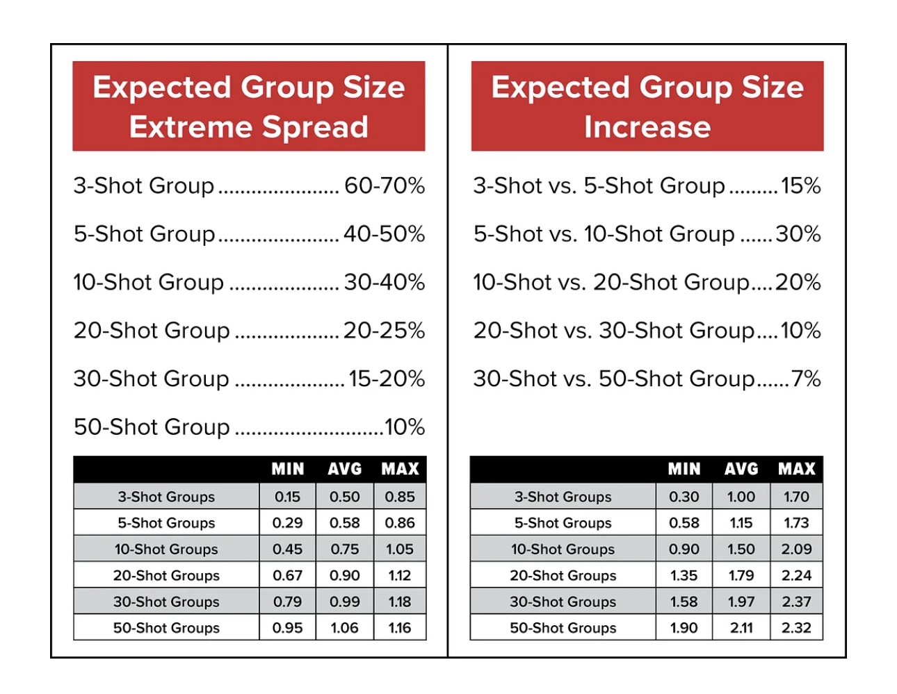

It’s actually subject to quite a bit of error
That's quite a bold statement and you may or may not be correct depending on a lot of factors. We can debate whether this method of reloading or any other method of reloading load development is "the best" or even works but in most cases if the end result is a load that works for the intended purpose then it probably works.
While the goal of load development is to find an accurate load that is also a high precision load, the way we ultimately determine what that load may be is by determining what loads don't work by a process of elimination and we want to get to that accurate load expending as little money, barrel life, components, etc as possible. In this case the OP gave some information on his load but not everything. He has a great bullet, but maybe not the best powder. We don't know what cases he used. He didn't give us any information on the rifle. It may be a custom rifle based on a BAT action or it may be a Thompson Center Compass. We don't know the shooters' ability. He could be a 1 MOA shooter or a .2 MOA shooter. Bottom line is I don't know what kind of dispersion to expect or what elements may be controlling.
Ultimately we are left looking at the target. In this thread they tend to reflect what most OCW targets tend to show. Statistically significant? Not even close. Subject to sampling errors? Yes. Shooter issues? Probably. In this case the 43.1 to 43.5 ranges shows a range of loads where the average point of impact for 12 shots seems to not move much implying the rifles was releasing the bullet on the same path since the expected velocity differences have almost no impact on the trajectory/drop at 100 yds (Most centerfire cartridges will move the point of impact about one caliber for a 100 fps change in velocity at 100 yds). Experience with OCW has shown that in most cases the loads that shoot well repeat about every 3% difference in charge weight and that scatter nodes occur when the difference is about 1.5% different than the OCW charge. Does this mean that the OCW is in that range? Anecdotally we can say this test does but to be sure we would need to retest in that range to see if it is repeatable. If it does then we have a load that is likely to be accurate and repeatable. Does it hold up at distance? Maybe. At distance we begin to see the effects of velocity variations. Usually an OCW load that fails at distance is due to velocity variations that probably are due to problems in the reloading process.
Is this load the best load? Who knows? The only way to determine that is to develop every possible combination of powders, bullets, cases and primers and shoot a statically significant number of each round and shoot them. Maybe in the end there may be clear winner or maybe not but we probably won't have any life left in the rifle so what is the point?
In a run of larger groups, you can accidently get a small group - but its neighbors call it out for what it is -- accident. On the other hand, a run of small groups is improbable and is - in my opinion - more likely to be telling you something.

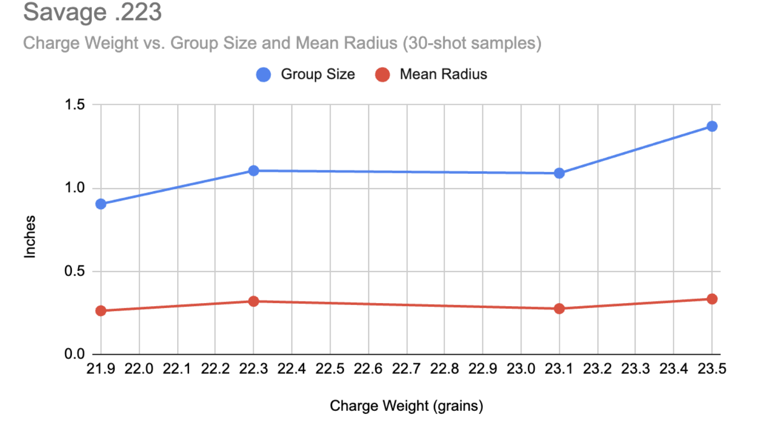

Another. "OCW Node: Based on accuracy, I pegged the OCW node at 22.3 grains because charge weights of 22.1, 22.3, and 22.5 grains had the closest consecutive mean points of impact (a .22-inch spread)"
His conclusion: "The lowest charge weight produced the tightest accuracy, and it slowly increased along with charge weight, with the book maximum producing the largest group size and mean radius."
and
Nowhere did he compare mean (average) point of impact to his original premise. He should have shot his 30 shots at 22.1, 22.3, and 22.5 gn. versus others. Also his point about group size increasing is based on the position of only 2 shots out of 30. Examining the mean radius the numbers do not appear to reflect a.change in precision (not accuracy) which is what he is trying to demonstrate.
He went to great trouble to calculate the mean radius for his data in test. However, not once did he bother to analyze whether or not the
mean radius differences were stistcically significant nor does he provide any data for his 30 shot mean point of impact.
I could go on but why bother!

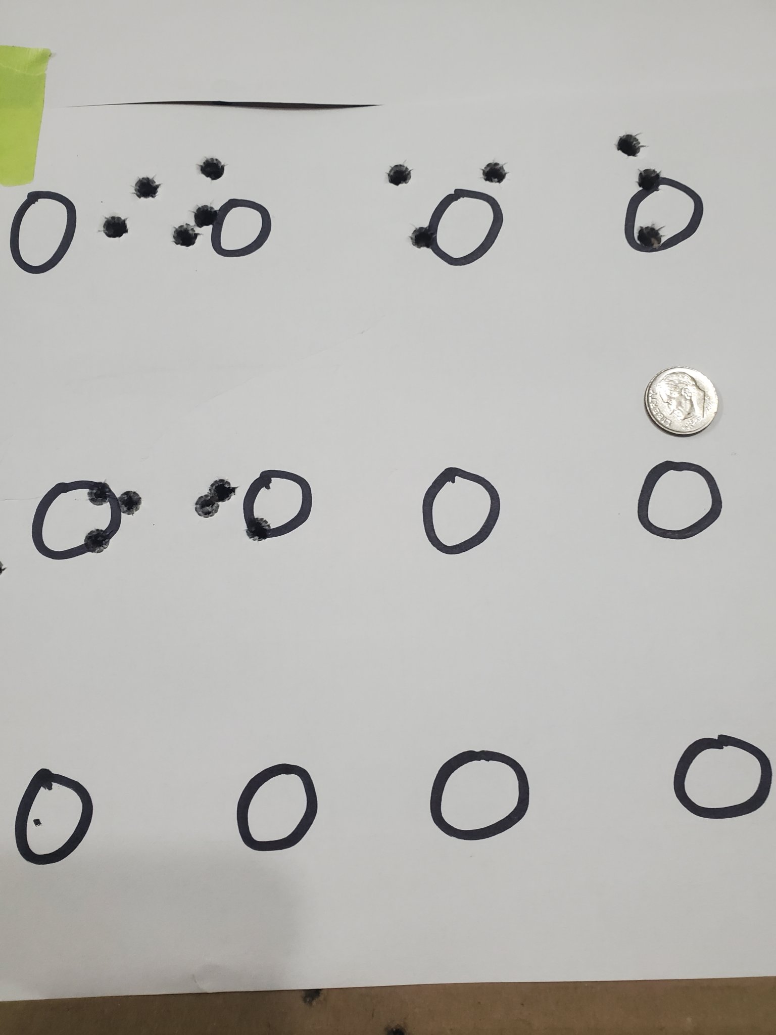

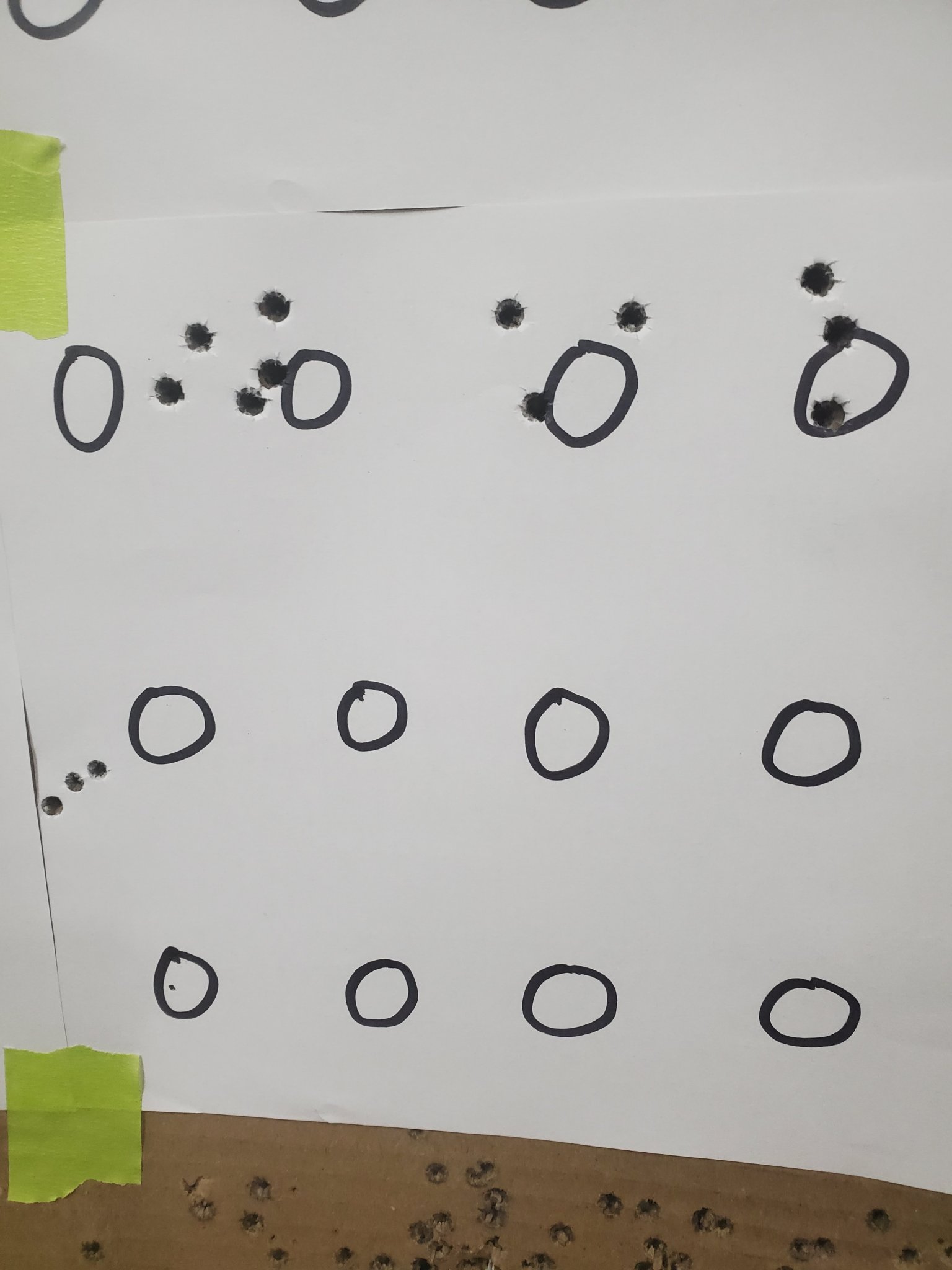

(Below)So is there no poi shift here or is it natural dispersion making it look like there is one?

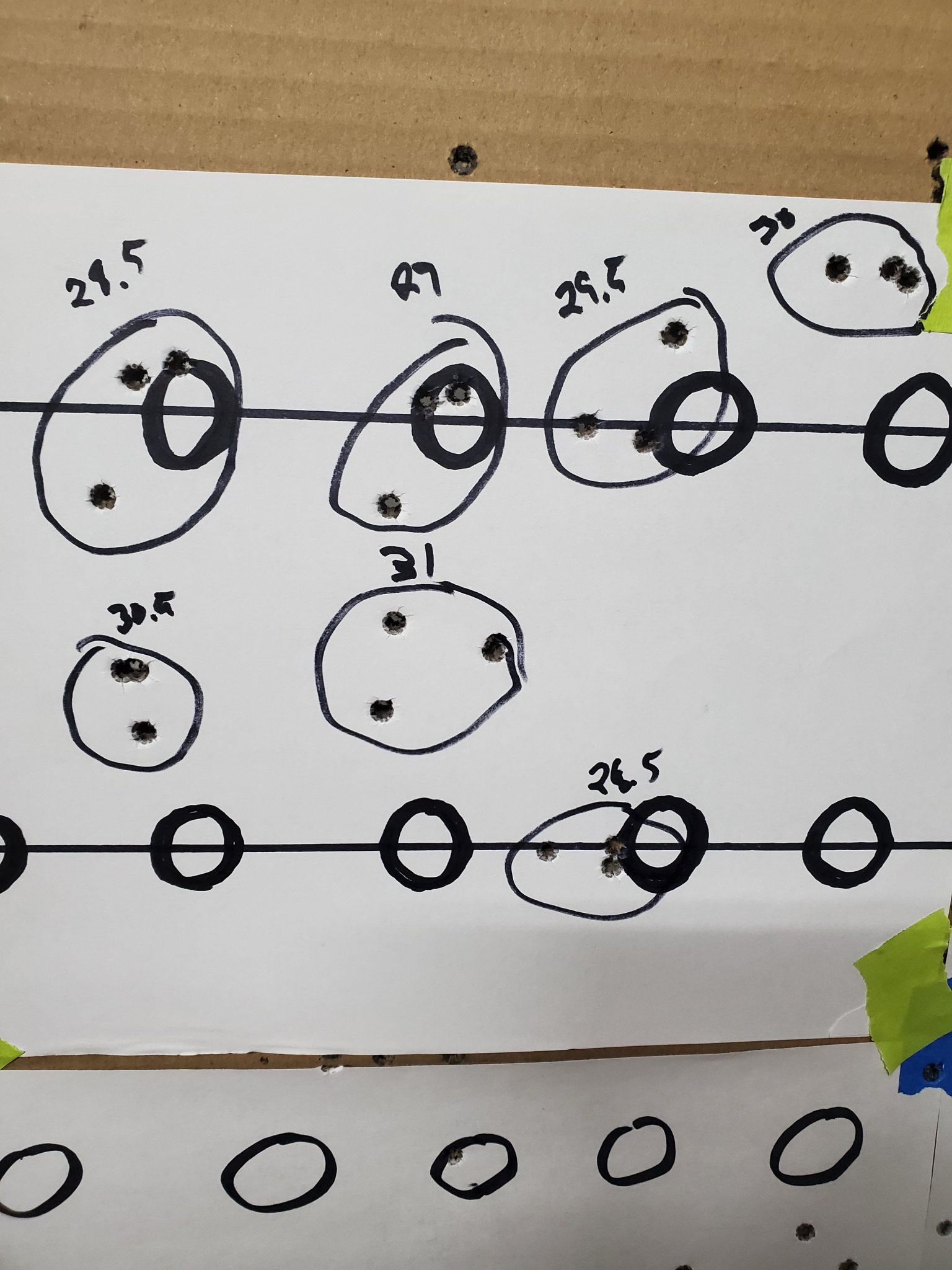

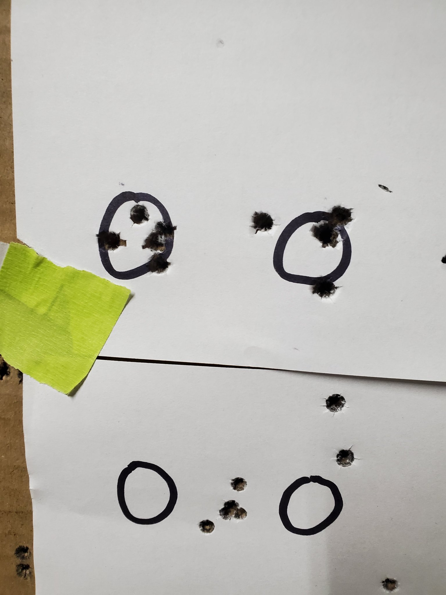

(Below)Three more groups after rezero. I was shooting 28.5. So I had to move my zero down. I shot 100 or so rounds of 28.5 and 100 or so of the new one 30.5.
(Above)Shot two more groups after bedding the barrel and final tuneing and assembly. It's easily shot better than the dispersion in the ocw target.
(Above)Here are a couple groups at 28.5. Looks like I was splitting time chronoing some 20 practical this day. This would have been inside the first 100 rounds down this barrel. Between 45 and 90. And earlier than the ocw and previous groups.
