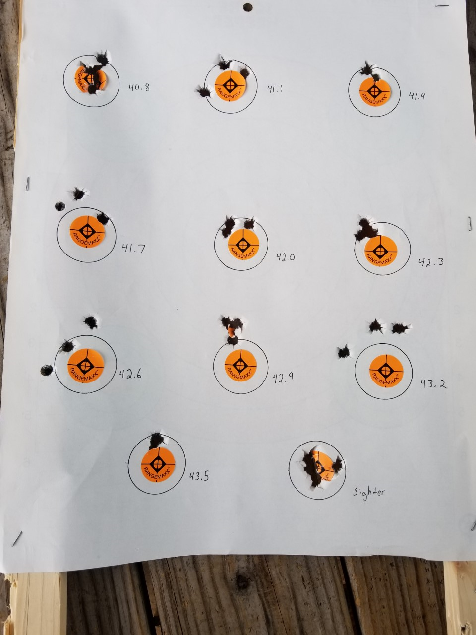

This is my first reload(and first post) and I chose the OCW load determination to see what works. I am shooting a M40A5 with Remington 700 short action and a 25" schneider barrel(1 in 12). I loaded in increments of .3 from 40.8 to 43.5. These were the recommended min and max. The load is federal brass, with Fed 210M primers, 175g SMK HPBT and IMR 4064. COAL was 2.800". Run out for each was <0.001" and was verified with a Hornady concentricity gauge. All brass was once fired.
Avg. Velocities, Std Dev
1. 40.8 - 2618, 9.63
2. 41.1 - 2628, 9.88
3. 41.4 - 2636, 12.36
4. 41.7 - 2653, 13.59
5. 42.0 - 2674, 6.65
6. 42.3 - 2695, 12.19
7. 42.6 - 2700, 14.38
8. 42.9 - 2728, 5.1
9. 43.2 - 2733, 8.38
10.43.5 - 2753, 7.85
I took 3 shots with each weight shooting round robin with 5 minutes between each shot. The temperature was 90°F. There were no pressure signs even at the 43.5 so I may go higher. Being new to this, I am curious as to which string of loads appears to be the best out the 10? 43.5 has the tightest group. But they all appear to be in the same direction from center, with 40.8 being an exception. What are your opinions? Thanks for your time!

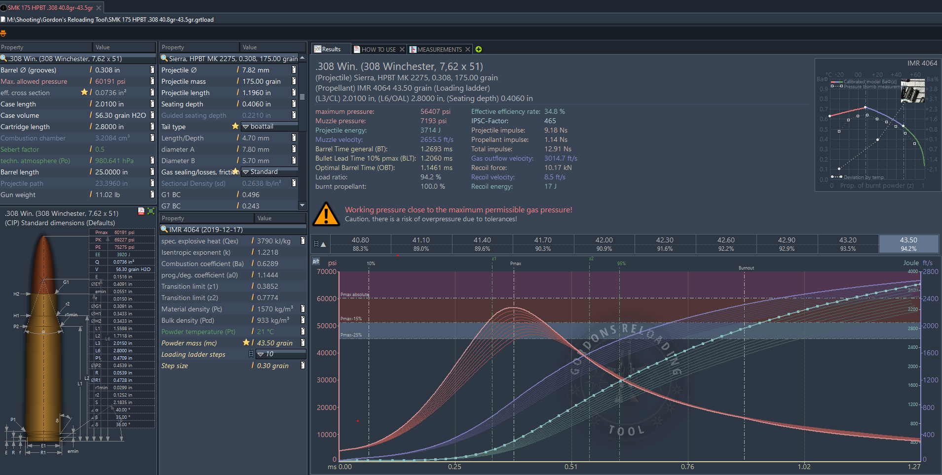

When I run your numbers through my QuickLoad app, your MV's are very close to what the app predicts. With the 43.5 grs of 4064 with temp @ 90°F the app is showing the case is filled 104.4% of capacity (you probably have a bit of a compressed load) and a pressure just above 66,000 psi (SAAMI max is 62,000 psi).
So, based on my experience and what the QL app is showing, I think it's a good idea stay away from those hotter loads and look at the lower charges. 42.5 worked well for me (again, I tend to load long as that's what my gun likes). The 42.0 - 42.3 is what I'd suggest you test again (maybe with some 5 shot groups to verify) and play with seating depths to help tighten up those groups there.

I plan on reloading and heading back out on Monday or Tuesday. I will try the 42.0 - 42.3 as you suggested and report back. I really appreciate it. I will have to download Quickload.

This is a great app, especially for being free. Thank you for sharing. It shows 4064 at 94.2% of max pressure. Would you say that QL is more reliable?

I set it at 100 yds. That would be something to consider for sure. I may set a target at 100yds and 200yds to test the difference.

Looking at your target, your results are spot on with everyone elses. I like that 41.7 - 42.3 range which is right in line with everyone elses results with this combo. Id load up a seating depth test with 42gr... Or if you want, load up a smaller OCW in .2gr increments from 41.7 to 42.5 to find the dead center of the node which is probably in that 42.1 - 42.2 range then do a seating depth test.

You're going to have a little learning curve to figure out how to handle the variables as you can't just use all the default setting. This is particularly so when it comes to your powder's burn rate as it will vary from lot to lot of powder. Often, when you use up your powder and buy some new, you'll have to tweak your loads to get back to the accuracy you have developed for the previous lot of powder.
So, in this app . . . take a look at your calculated MV. You see it's a good 100 fps slower than what your chrono got. You'll need to adjust the powder burn rate in this app to make it a more accurate representation of where your charge is for pressure and other results. Make sure you're using the correct case volume of YOUR brass; I used 55.9 gr H2O as that's what my Federal fired brass averages. Note too that your temperature is at 21°C when you say you were at 90°F, so that should be changed to 32°C. That'll all make a significant difference in your pressure.
QuickLoad has been around for a long time and used by many reloaders. I've found it to be quite reliable once I got through the learning curve. I've found this GRT app to be reliable too, to the extent I've used it (which isn't a whole lot). It's a verily new app an it still being improved. The GRT has some features not available in QL, but it's powder database is not as extensive and QL's.

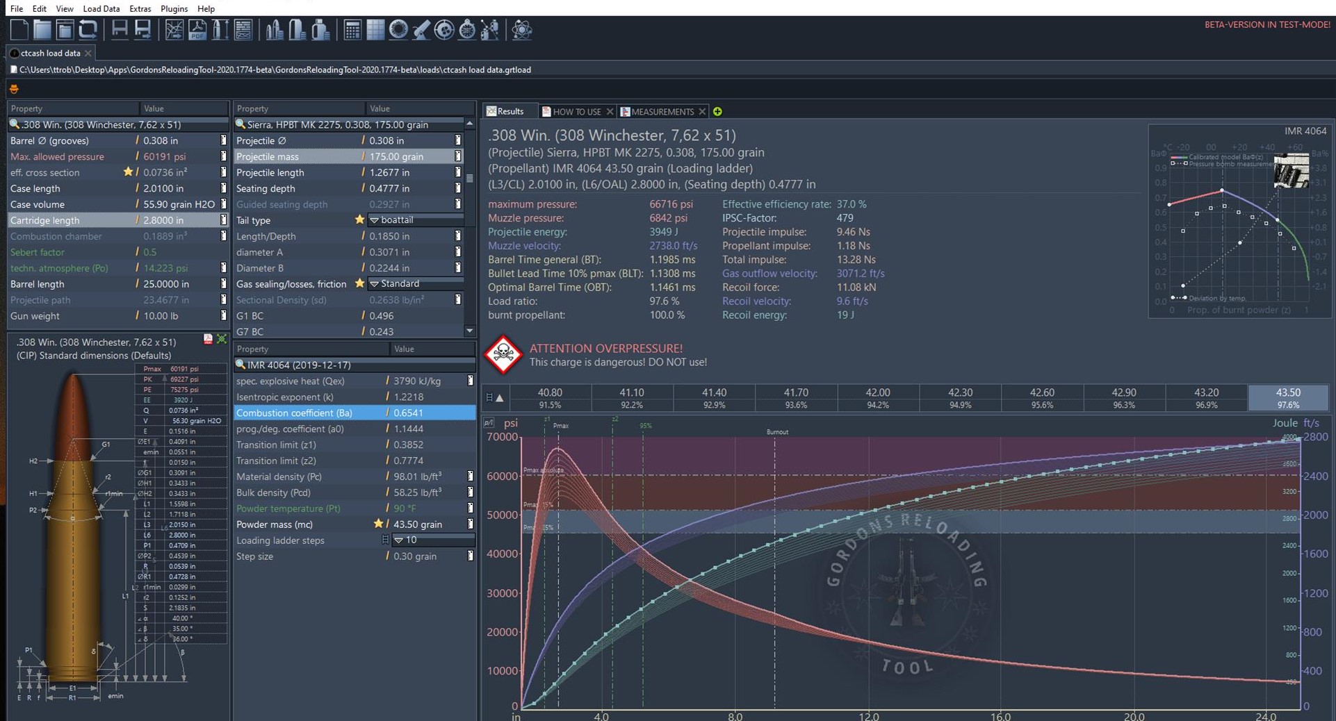

I ran the GRT quickly and here's what I've come up with:

Wow, that's a 3.4% difference in pressure. I'm glad I decided to reach out for help. Lot to learn. The "calculate shot groups" option looks handy as well. I may spend some time with that also down the road.

41.8 to 42.2 gr is the typical node. Corresponds to FGMM loaded with 4064. As for the FC brass, this node seem to not stress the brass based on my measurements. Next node is in the 43 to 43.4 gr range.
Strange thing about the OP’s target is the scatter at 41.7gr.
I just ran the same test with Federal brass. OCW was 41.9gr.
