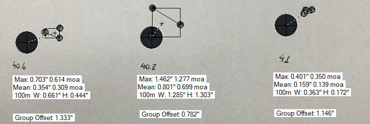

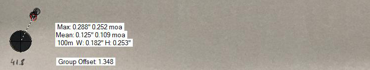

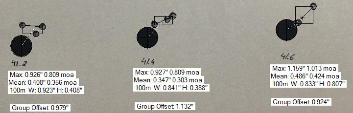

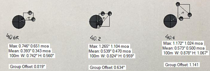

What do you see? Looks like a good node from 40.0 to 40.4, and a good node from 41.0 to 41.4. Am I correct in concluding that 41.4 would then be my optimal charge weight?

I’d like to hear your reasoning as to why you think that 40.4 is part of a node that also includes 40.0 and 40.2. And assuming that your reasoning were sound regarding 41.0-41.4 being a node, why would you choose 41.4 as your OCW?

@lash base on my understanding, from Mr. Newberry's instructions, ploted shots that come the closest to hitting the same POI (point of impact) on the targets.
@Skookum Good catch! Next time I will use the official OCW target.
Since you read Dan Newberry’s instructions, I suggest you follow the formula he provides to determine charge weights as well. Typically at charge weights around 40 grains +/-, the increments are 0.3 grains. Doing 0.2 grain increments can make finding the node a little more difficult.
This said, based on the target above, 41.2 would be the node based on the group centers relative to POA
As Skookum so correctly pointed out, it would be much easier to read if the dots were all on the same line to start with. Having said that, 40.4 poi is nowhere near the same relationship as 40.0 and 40.2. If you look at the rise and run (x and y coordinates) of the center of each of those groups carefully, you will see that.
As to choosing 41.4, I asked because 41.4 is the third and last point in a group of similar poi. You choose ocw based on the most forgiving charge weight in a node. In this case that would be 41.2, the middle charge in that node. This allows for some of the natural variations you will experience, such as charge variations, temperature swings and minor pressure differentials caused by other variability introduced by your loading practices and your environment.

What powder?
41.0-41.4 are pretty stable.
41.6 has that one shot going high, but you will notice that it goes to the exact place that the following 41.8 charge goes to. So 41.6 is likely on the very edge of the node.
As @lash has already mentioned, I would load 41.2 if it were me.
Side note: Notice your group shapes. They follow a pattern.
40 = round/horizontal
40.2 = vertical
40.4 = vertical
40.8 = round/horizontal
41 = bughole
41.2 = round/ horizontal
41.4 = vertical
41.6 = vertical *(edge of node, could have been bug hole if hadn't scattered)
41.8 = bughole
41.2 being next to a bughole means it should only take a slight change in seating depth (.005" at a time) to get it to tighten up considerably.
