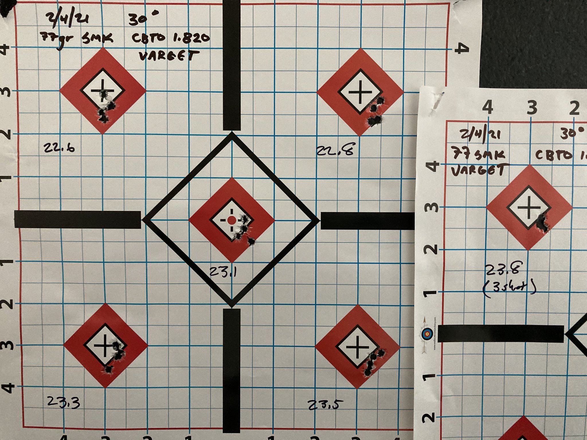

Hi guys I’ve been lurking around gaining information from you guys for last few months and just got done loading my first 223 workup for a tikka varmint. I’m using varget and 77smk in lake city brass. My question is regarding the seating depth. I measured my chamber and loaded the rounds 5 thousandths off the lands for this workup but is this too close to start? I’d rather ask now than shoot and run into any issues and figured going deeper would be quick fix.
loads go from 22.6-23.8gr varget coal approx 2.28
thanks in advance.

Coal as they sit is approx 2.28 and that’s giving me about 5 thousandths off lands. I’m measuring cbto and they are all within half a thou. Seems a lot more that I read most guys are starting development at 20 thousandths off so I might just run these through the die again and push them down a little farther if it’s recommended. I’ll make sure to check for pressure as I go as well.
Reactions: spife7980
Yeah, I'd start at 0.015 or 0.020 off to start and go from there. SMKs usually have no problem jumping a little bit.
Reactions: Mudflap621
Thanks guys input greatly appreciated. Seems consensus is I’m close to the right track. Hoping to get out this weekend so I’m sure there will be more questions to follow.

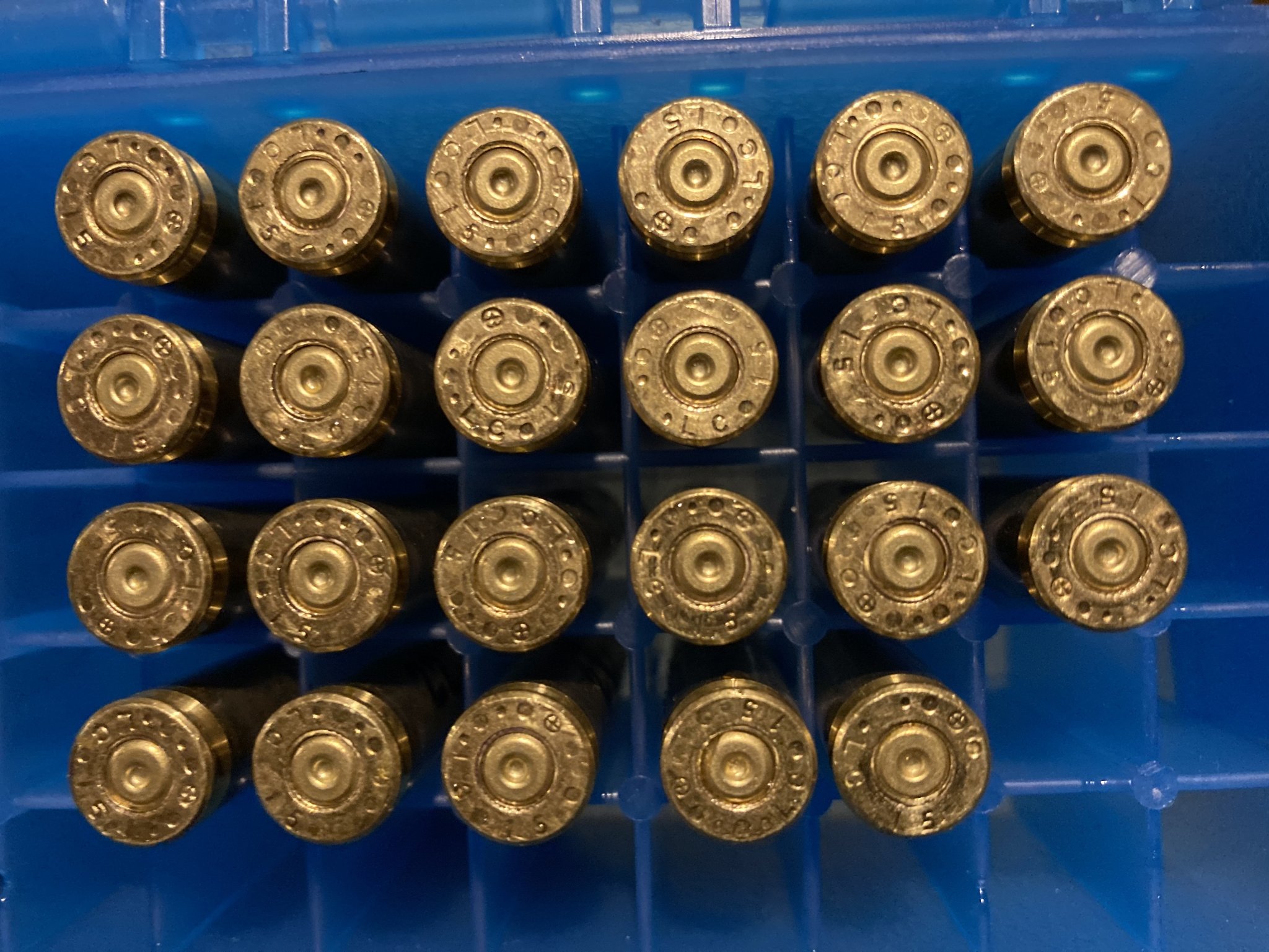

I shot 24.3 with the 75 a max twice in LC brass in my Wylde chamber and now the pockets are loose.
I cannot speak to LC brass as I shot everything with Lapua...
But I use the Ballistic Tools Go and No Go pocket gauge....the GO is nice and tight, the no go will not even go in on these 7x 24.4gr brass... I've been shooting this load for quite a few years now and it's mild for me. Idk what else to say. Zero brass issues pockets are nice and tight

My goal was 10x before I trash them but I will probably get more as tight as these pockets are. I'm also loading 2.49" COAL with 75 ELD which is .015" off lands

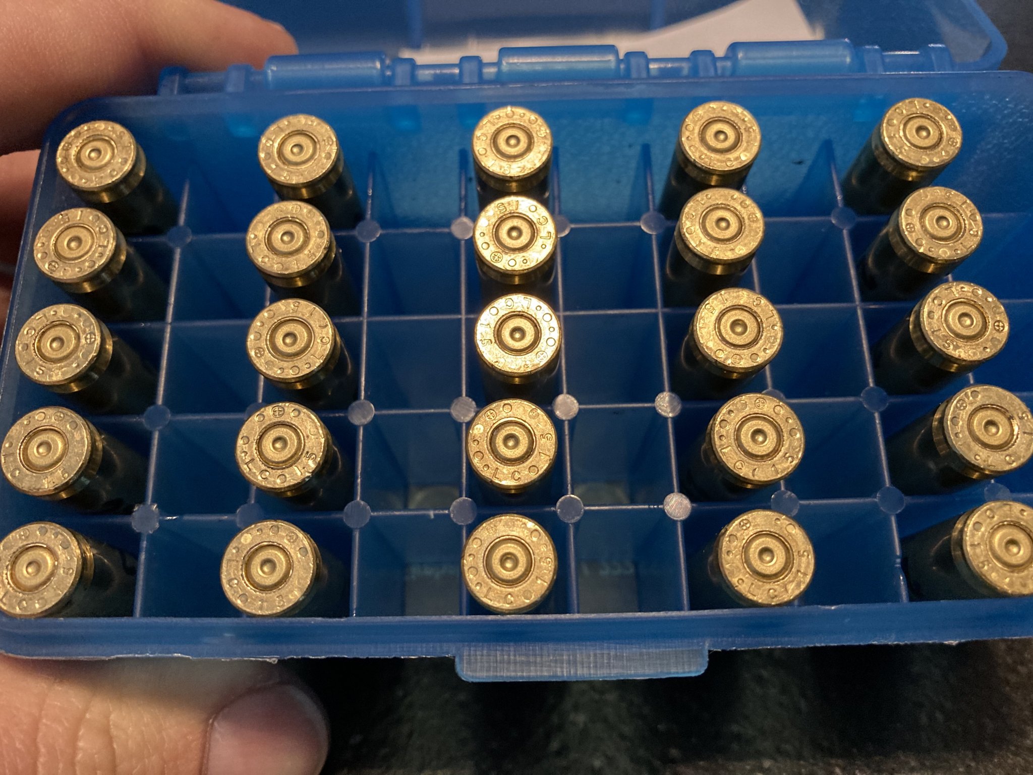

I recall a recent thread, with at least 2 more people saying they stretched out pockets shooting 24.3. I believe @spife7980 was one them.
As we are getting much deeper into this part of the conversation then we ever should have. We should remember our lot to lot changes in Varget. Now that I am thinking about it. I have to run 42.4 with the 175SMK with this batch also. 43.2 would leave ejector marks on some cases. I never saw them at 43.2 with my first 25lbs or so. I haven't shot this lot much because I started using RL15 when Varget was hard to find, and then started shooting the Gaymores 6 and 6.5 so H4350. I also changed most anything 223 to 8208.

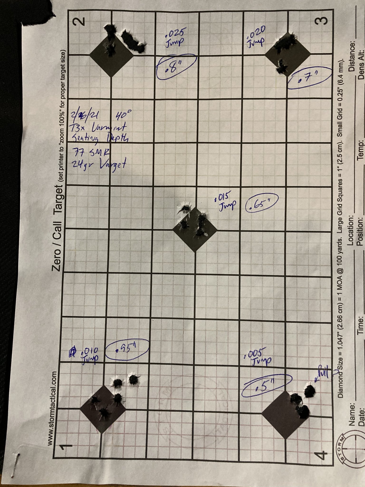

Ok so I went back seated these 20 thousandths off the lands and it put me at cbto of 1.820. Attached is the groups from today your input would be appreciated. Also attached is a pic of the brass and imo I don’t see any pressure signs but I’m new at this.
Looks good. Id work 23.8 - 24.4gr in 0.2gr increments... POI looks very consistent, nice and wide which is great.
In my .223 bolt guns I found tighter groups closer to the lands.. I load mine .005-.01 off... After you shoot 23.8-24.4 and find your load I would then load up 5rd each .005 off, .01 off, .015 off and .02 off.. I always find one of those that stands out from the rest and shrinks right up..
Thanks Padom I will get to work!

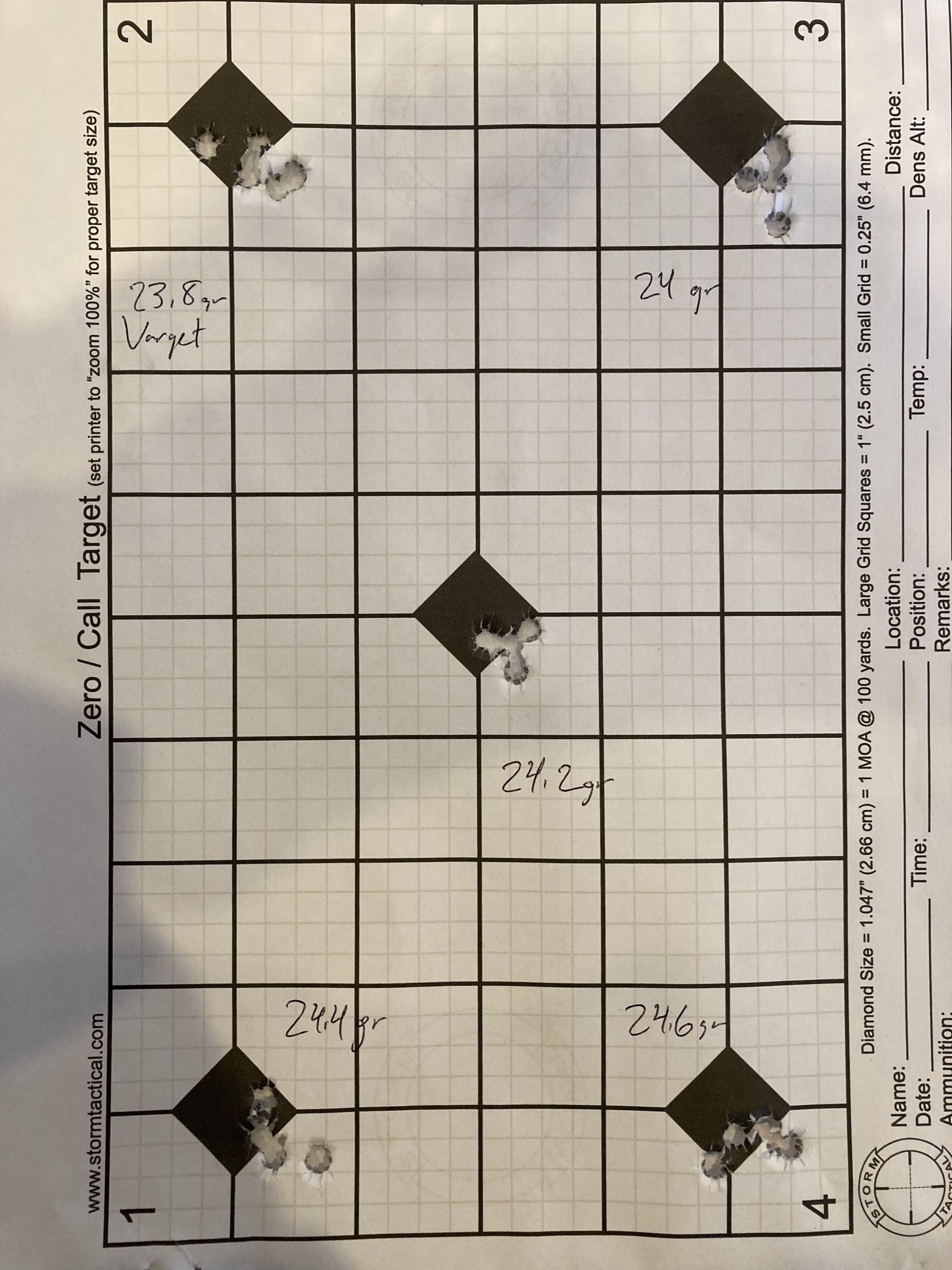

Today went out checked 23.8-24.6 every .2 grain while fighting a blizzard but was able to put together some ok groups. POI seems to be staying pretty stable I did see some primers starting to flatten more at 24.4 and 24.6 grain. I’m having a hard time trying to pinpoint a charge weight. My guts saying the 23.8-24.2 range.
On another note I had a hard time staying focused on target today in the snow is this common?

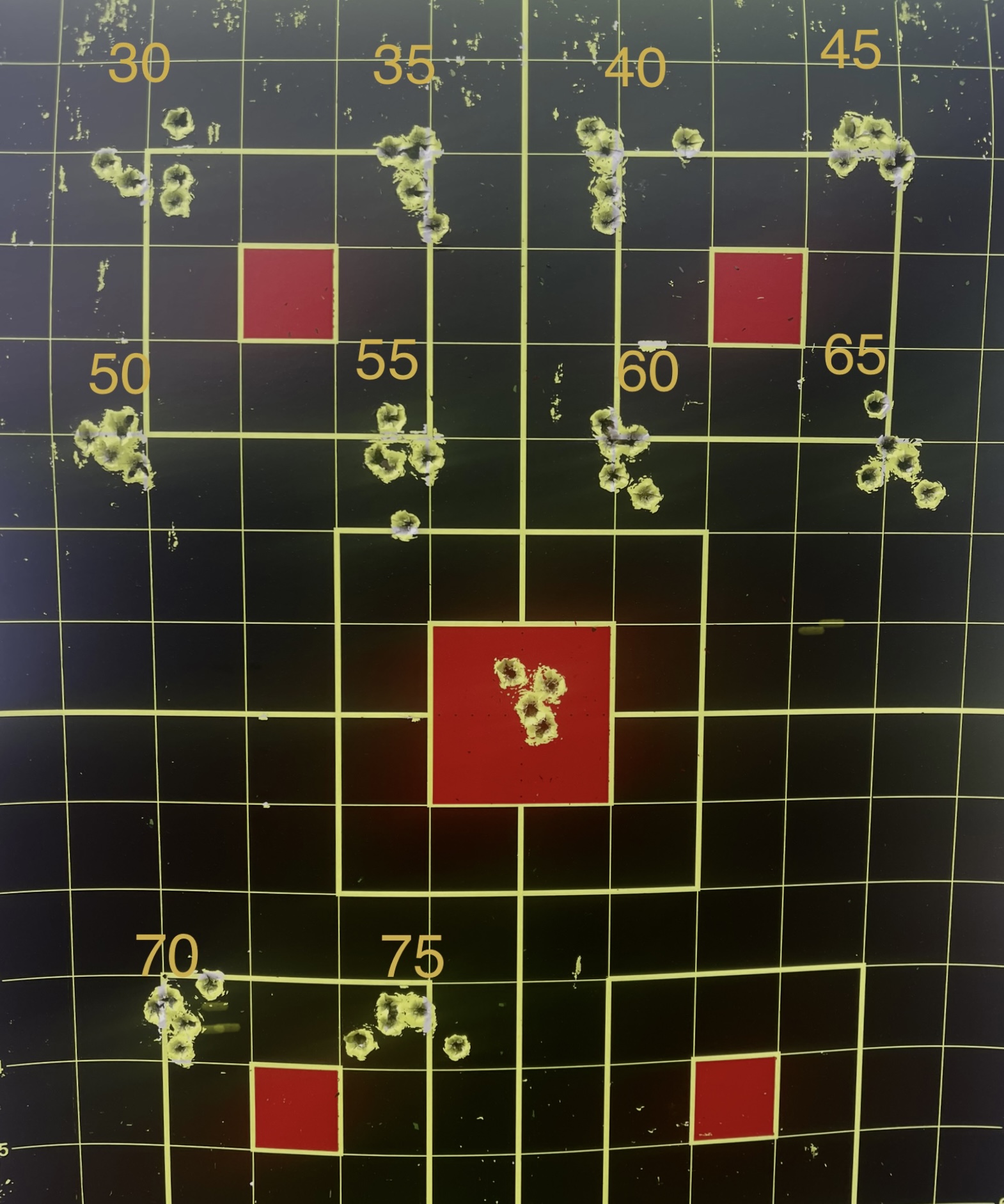

I know I WAY behind here but adding data anyway.
Pretty psyched, got this Bartlein broken in w about 375 rounds and just finished load development. SAC reamed this chamber to give me a 30k jump at magazine length. All rounds were charged w 24.25g Varget and 75g ELDS. All 5 shot groups;,seating depth test from 30 to 70 of lands. Was hoping it shot well from 45 to 60 and it did great today. Not great speed, 2780
