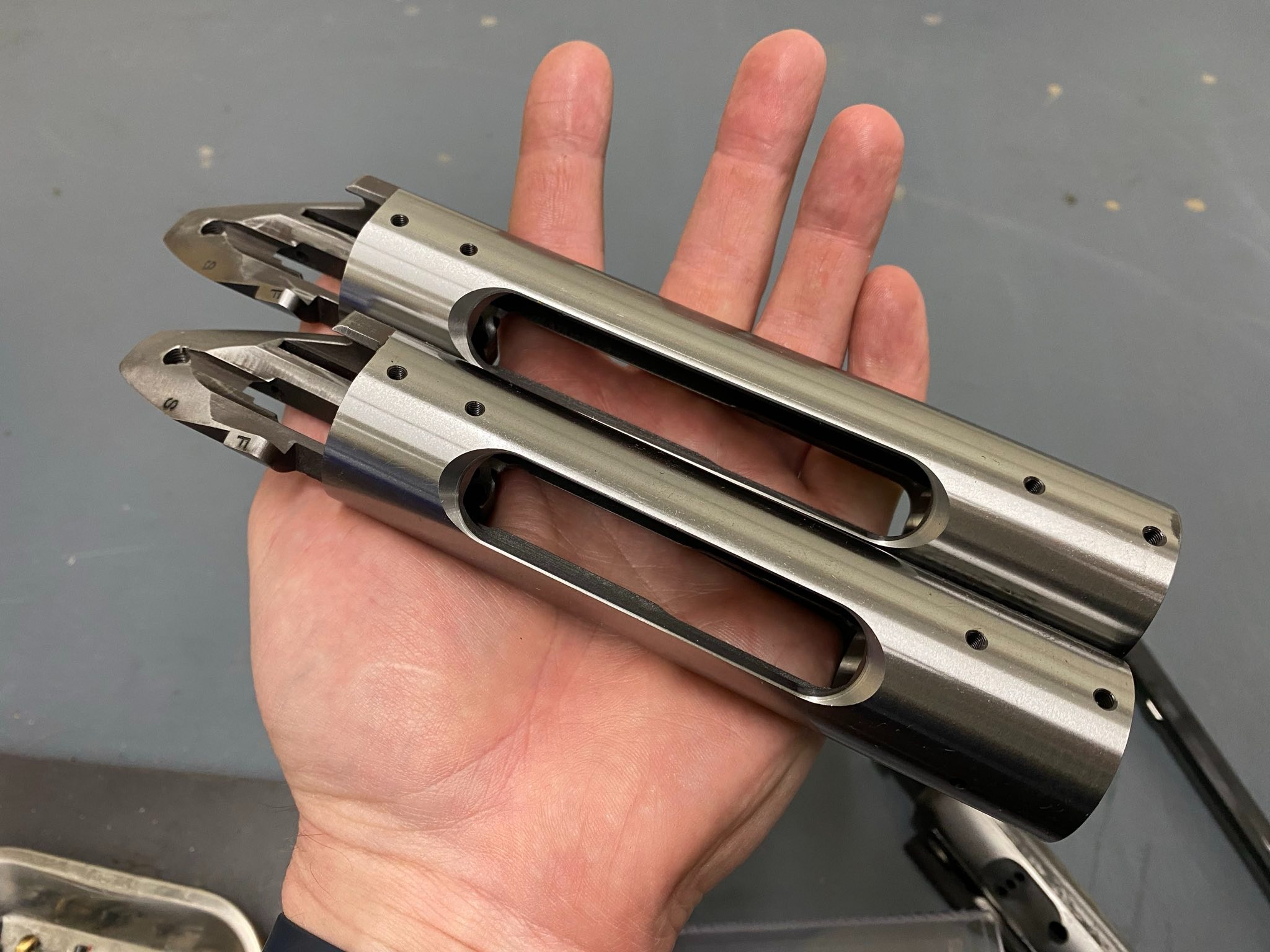

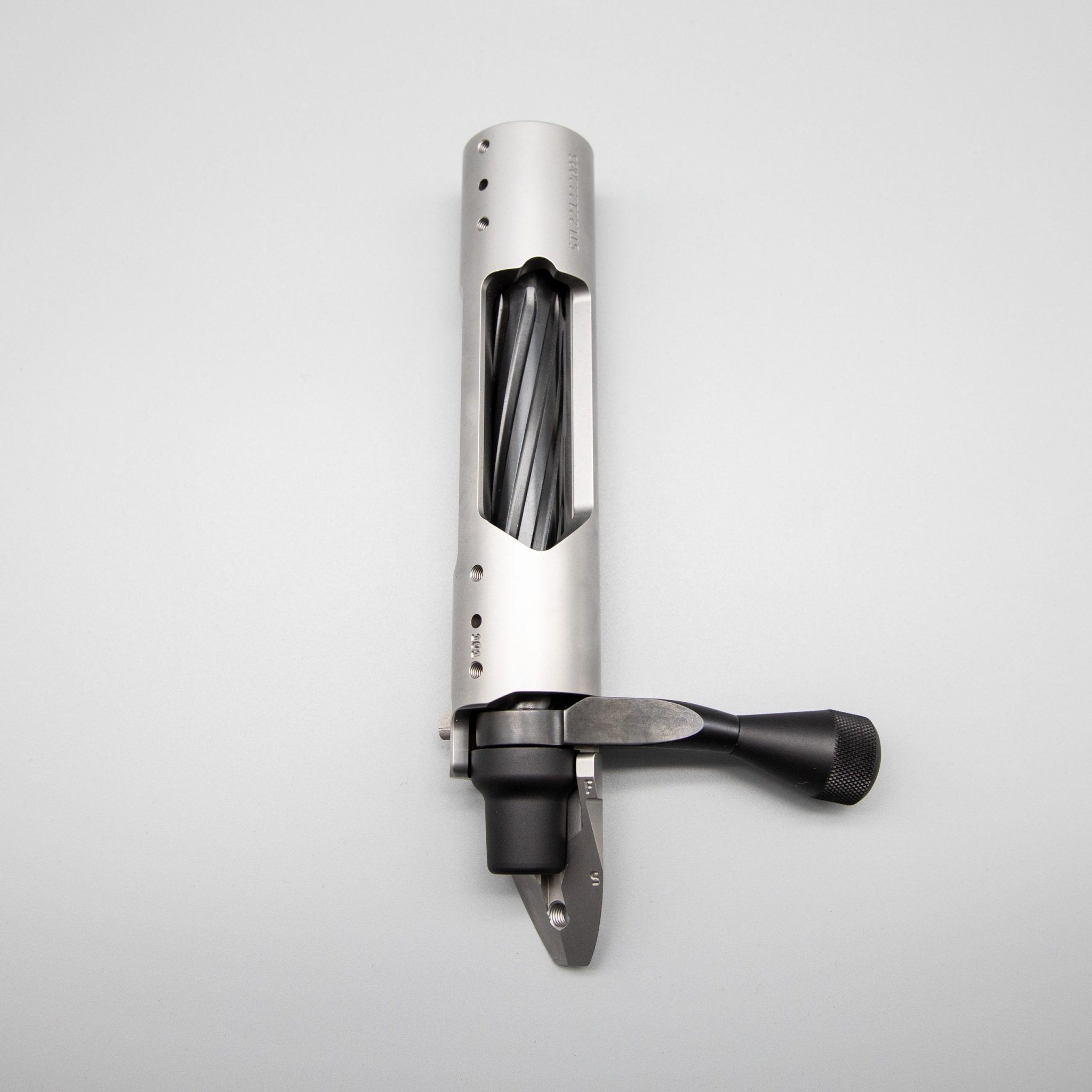

I came into some 700 pattern receivers made by Lewis Machine and Tool (LMT Defense) years ago when they were still in Illinois. I am not quite sure what scope base will work since it differs from a Remington 700 receiver in that it's fully round.
Does anyone know of a scope base like this?
Some quick measurements and browsing the EGW website, the hole spacing seems to match that of a Remington 700
I think defiance made some actions that were round top (that didn't have an integral rail). I think they still offer bases for sale for their round top actions, you might want to reach out to them, see if you can get the specs on their rails.
A lot of aftermarket 700 clone makers make full round 700 style actions. Your reviewer diameter should be 1.35". I don't remember what 700 hole spacing is but it looks to be standard. Call any aftermarket mount/rail maker, they probably stock what you're looking for. If not, you can get a blank rail and have it drilled to match. I prefer Ken Farrel mounts and rings because I've always had excellent customer service, give them a call 660-438-9456, check out his web site.

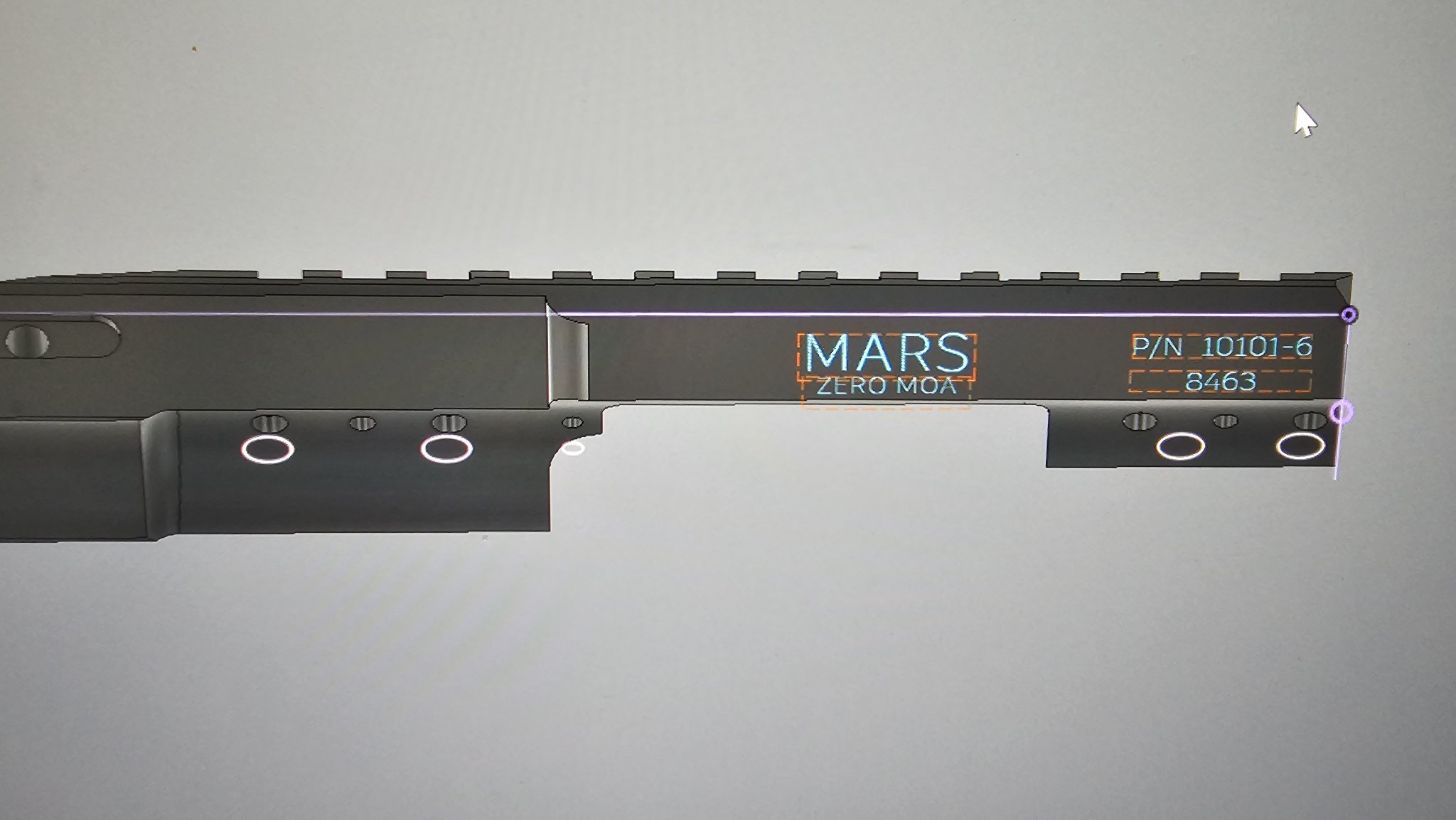

I just checked my CAD drawings. The model is stiller tac30. The white holes (sketch) is rem700. Front line up, rear doesnt.
Yes its a MARS clone rail.

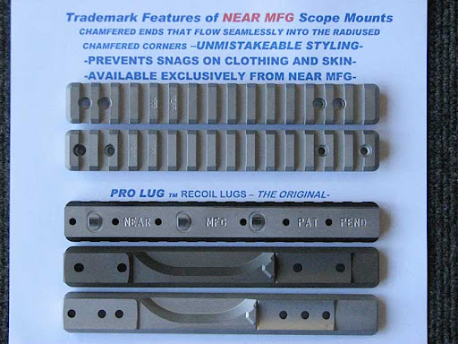

Check with Murphy Precision, they could probably make something for you.

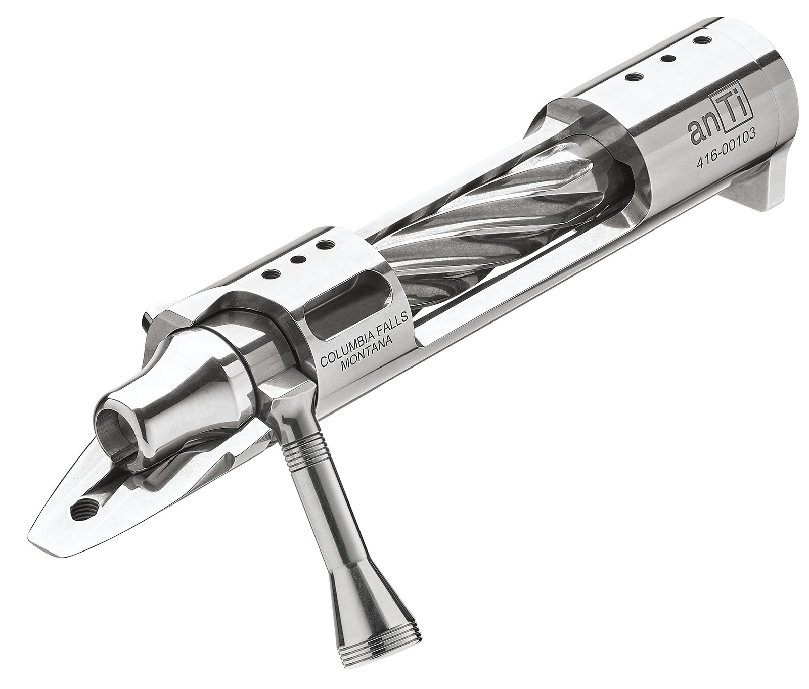

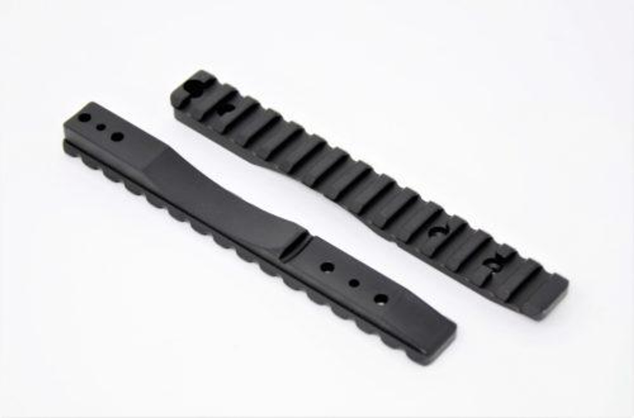

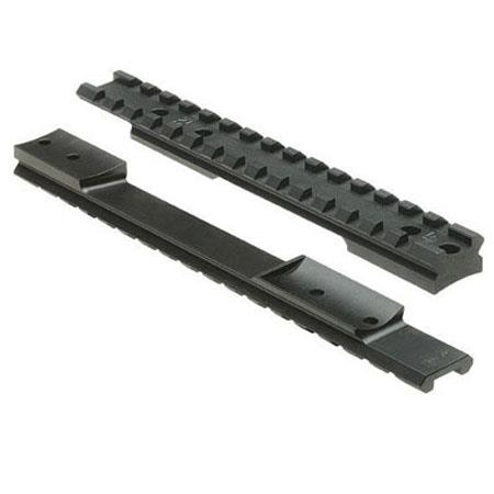

That was the ticket. Defiance did get back to me and confirm that the anTI bases would work and they also suggested Murphy's
While a bit spendy for the titanium option, this version will work for the short action I have.
and this will work for the long action.
Reactions: Tokay444
unclemoak, just as an aside -- if you're going to chamber the long action in something especially recoil heavy, take Tokay444's advice and install pins into the receiver in the holes between mounting screw holes to take some recoil and keep the screw shafts from shearing.
Many single-piece bridge mounts have a recoil butt that fits into the ejection port (at the front or in the rear at the clip slot). Examples:
View attachment 8322063View attachment 8322064View attachment 8322066
