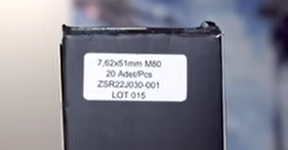

Hi,
So I doped my 16” large frame 308 gasser today at 310, 390, 436, and 517 yards. Lets call it 300, 400, 430, and 520. All data in mils and suppressed.
Data for IMI 175 OTM:
300 - 1.3
400 - 2.0
430 - 2.3
520 - 3.3
These figures seem to line up very well at 2600fps on JBM. However, the next batch is whats weird.
Data for S&B/ZSR M80 ball:
300 - 1.4
400 - 1.9
430 - 2.2
520 - 2.7
I tried truing this in Ballistics AE at 517 yards. If I use that velocity given, nothing else lines up, and vice versa.
As a note, my 20” bolt rifle velocity with a 175 (2504fps) matches its data well +/-.1-.2 mil. I am only having an issue with my M80 data set. Another note, when my 16” barrel heated up a bit, I noticed the data change to:
300 - 1.0
400 - 1.7
430 - 2.0
520 - 2.5
This data held a bit more consistent over the remaining rounds I fired for the day of M80 loads. I did not test the IMI 175 under heat.
Does anyone have a guess as to whats going on? Could it be an SD error in bulk M80 loadings? I did notice some random flyers with the ZSR load splashing 1-2 mils off target.
Thanks in advance,
PBWalsh

If you have this ZSR ammo, I would use caution and put it aside till they get to the bottom of their investigations. YMMV
