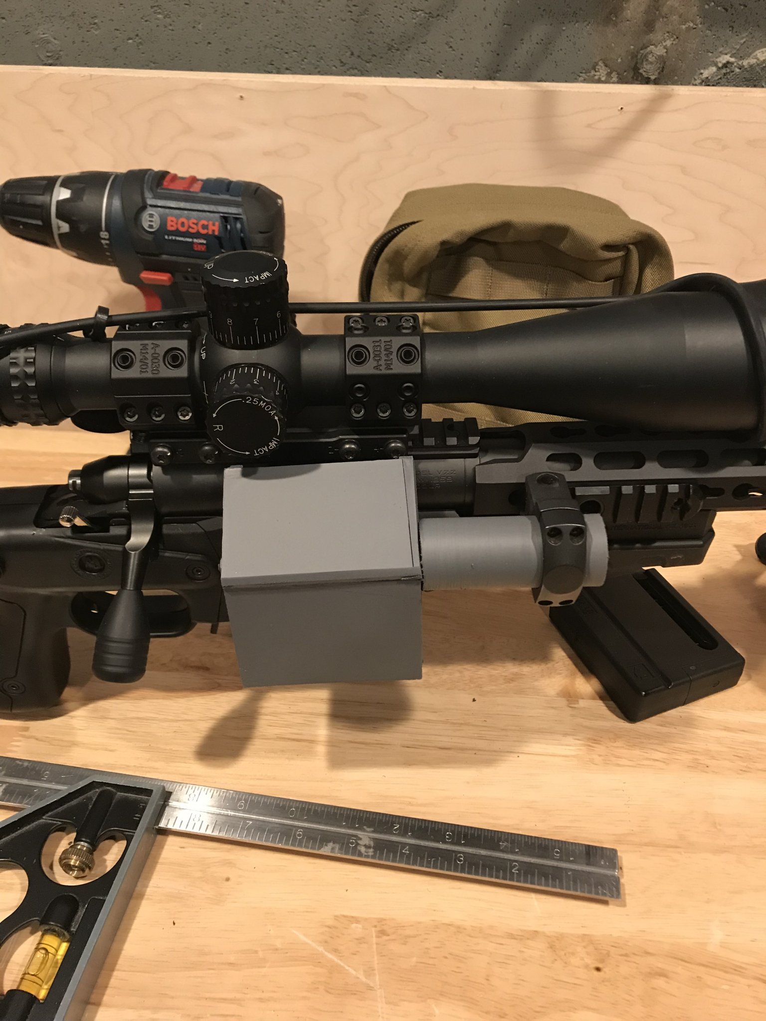

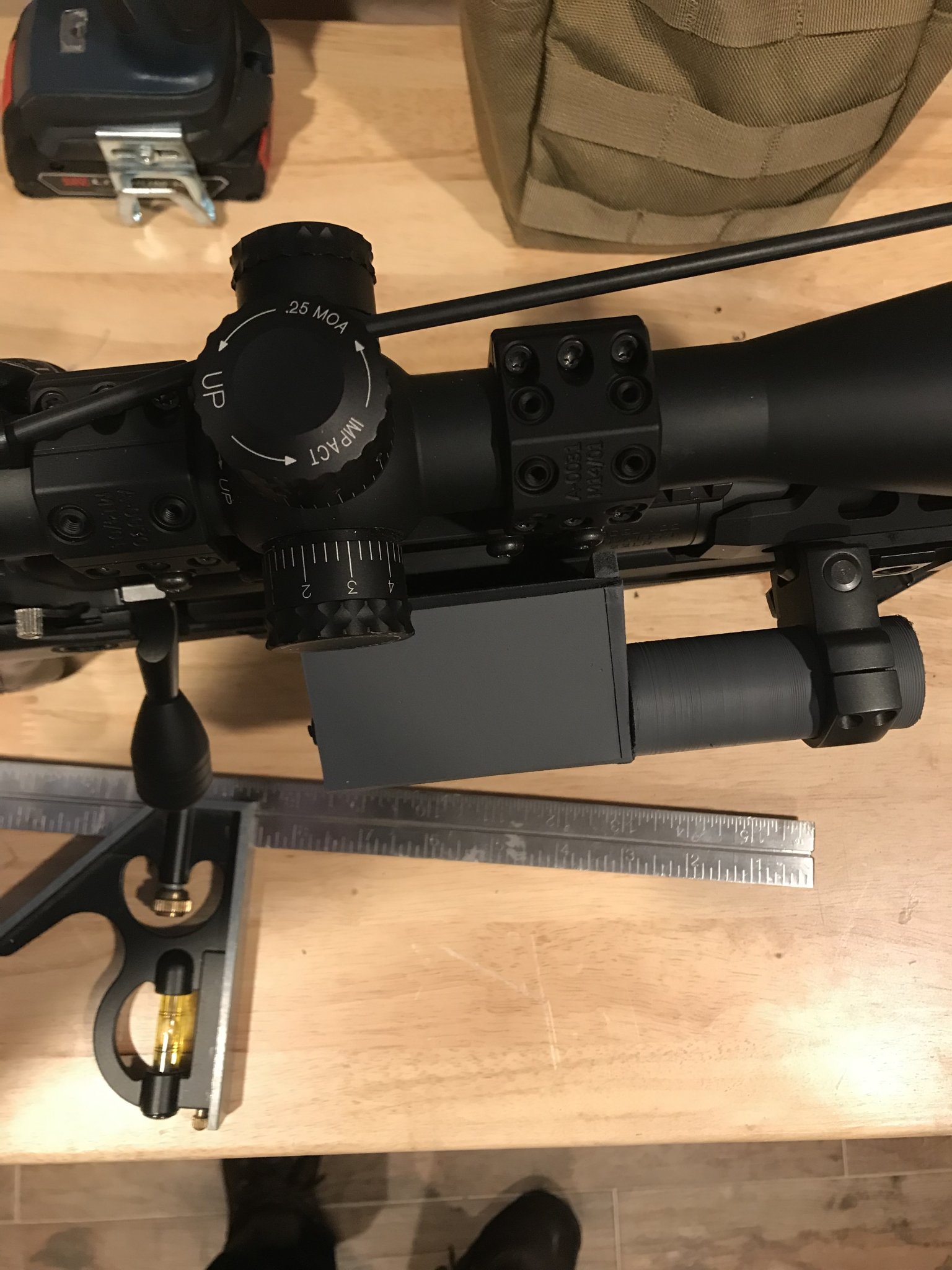

Not a full size cut I threw a couple of parts in my basement together on my 22lr vudoo, works so well I’m sticking with the prototype..
Plastic shaft attached to a old scope ring I had laying around.
It can be done, on a weekend.
Open frame with a mesh bag.

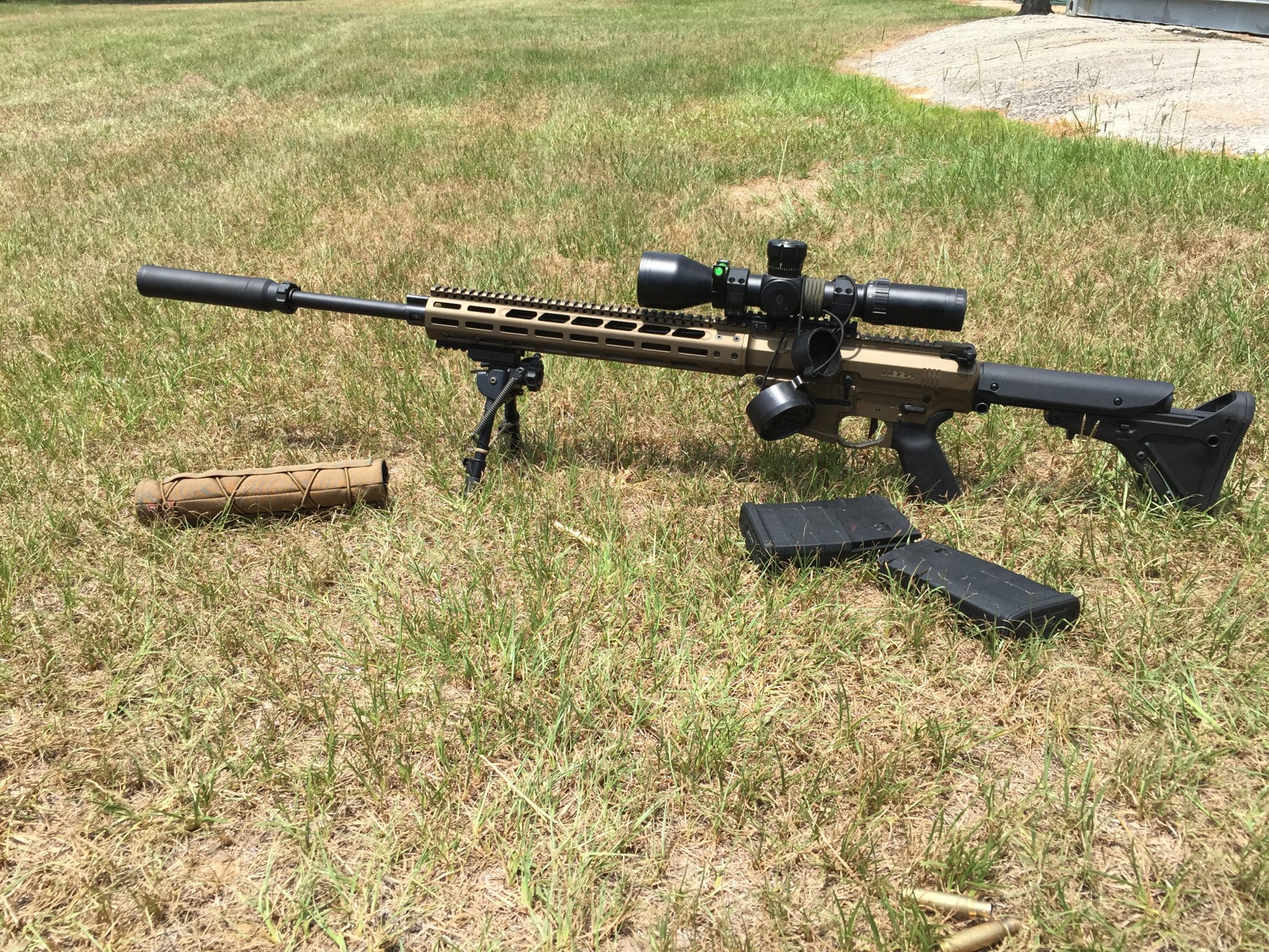

My old rig when it was a 6 SLR. It shot phenomenally, but losing brass was a pain. When it was shot out I rebarreled it in 6.5 CM, then sold that barrel and am going to make it a 6 CM when I get some time.
