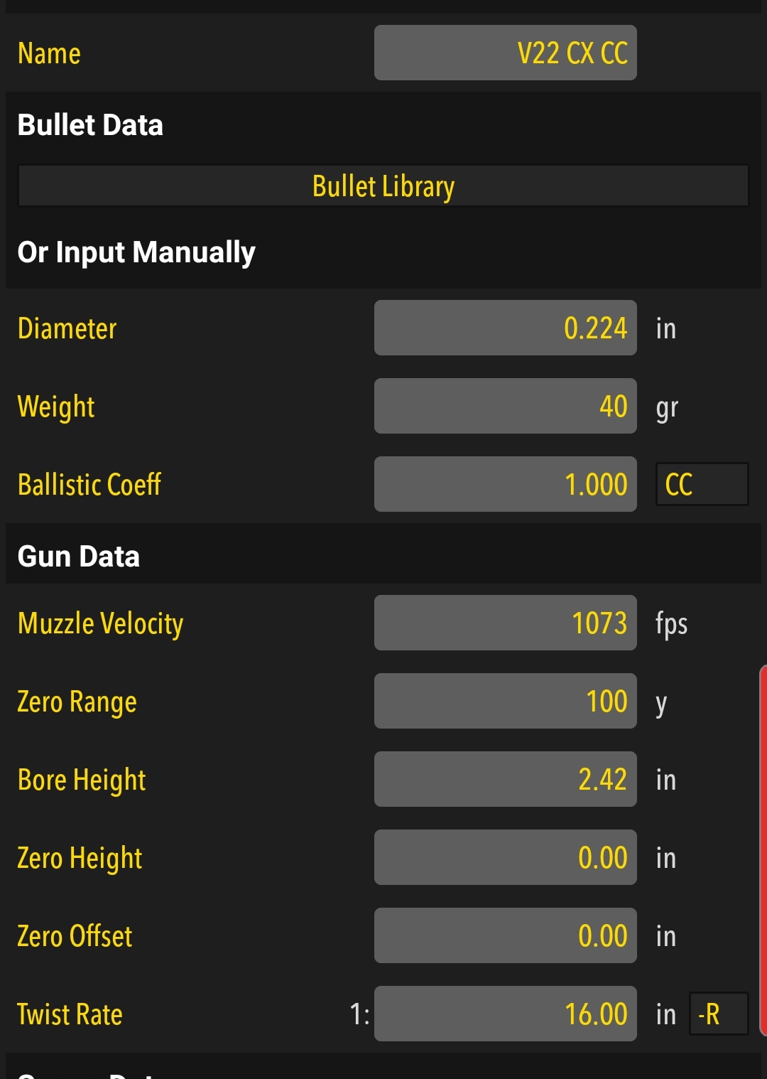

    Question about Custom Curve......when I selected it shows BC of 1.000
    Is that right?
    Is that right?
    Yep since it's a variable BC that's been doped by AB using Doppler.
    Then you just true the muzzle velocity. In the 4 lots of CX I've tested (24-26-28xx) out of Ace, Kukri and MTU barrels it generally has ranged from 1086-1095.
