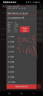

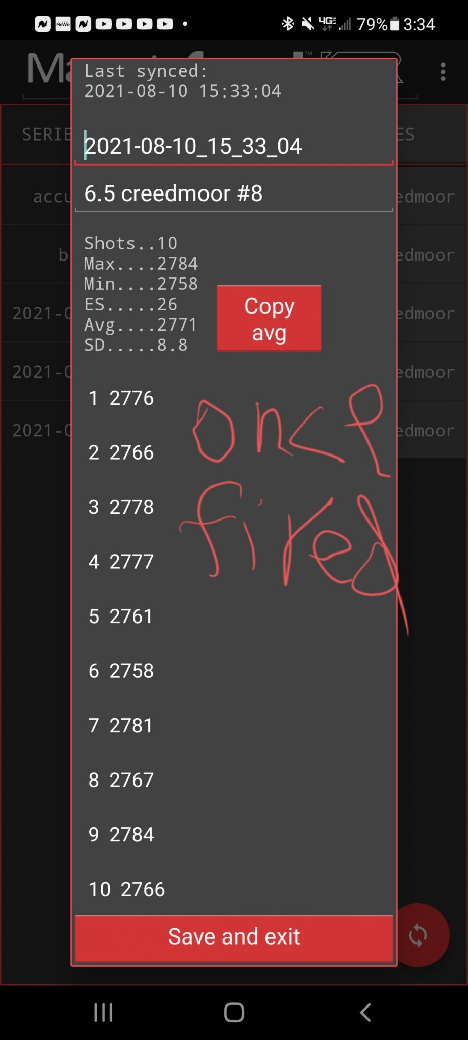

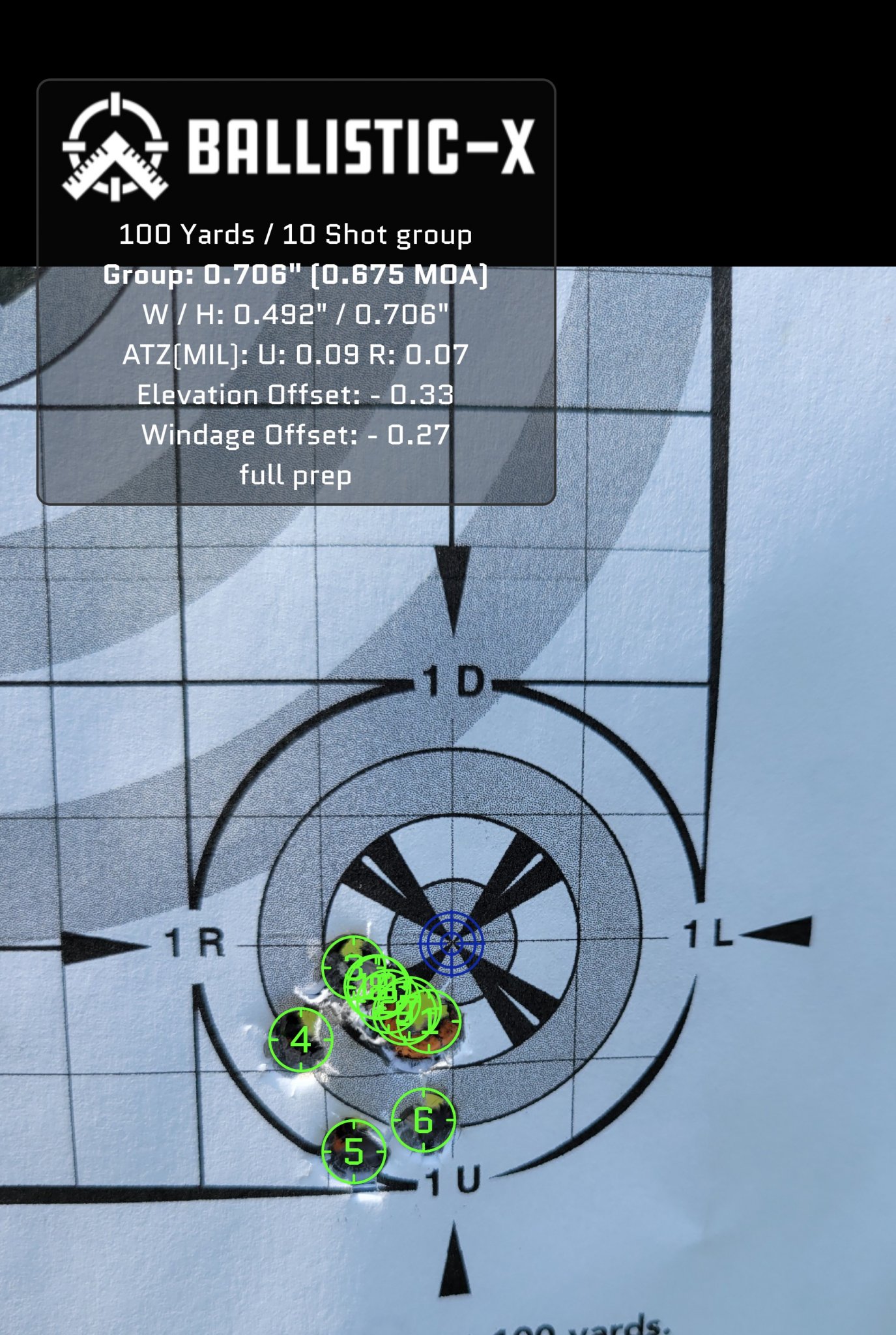

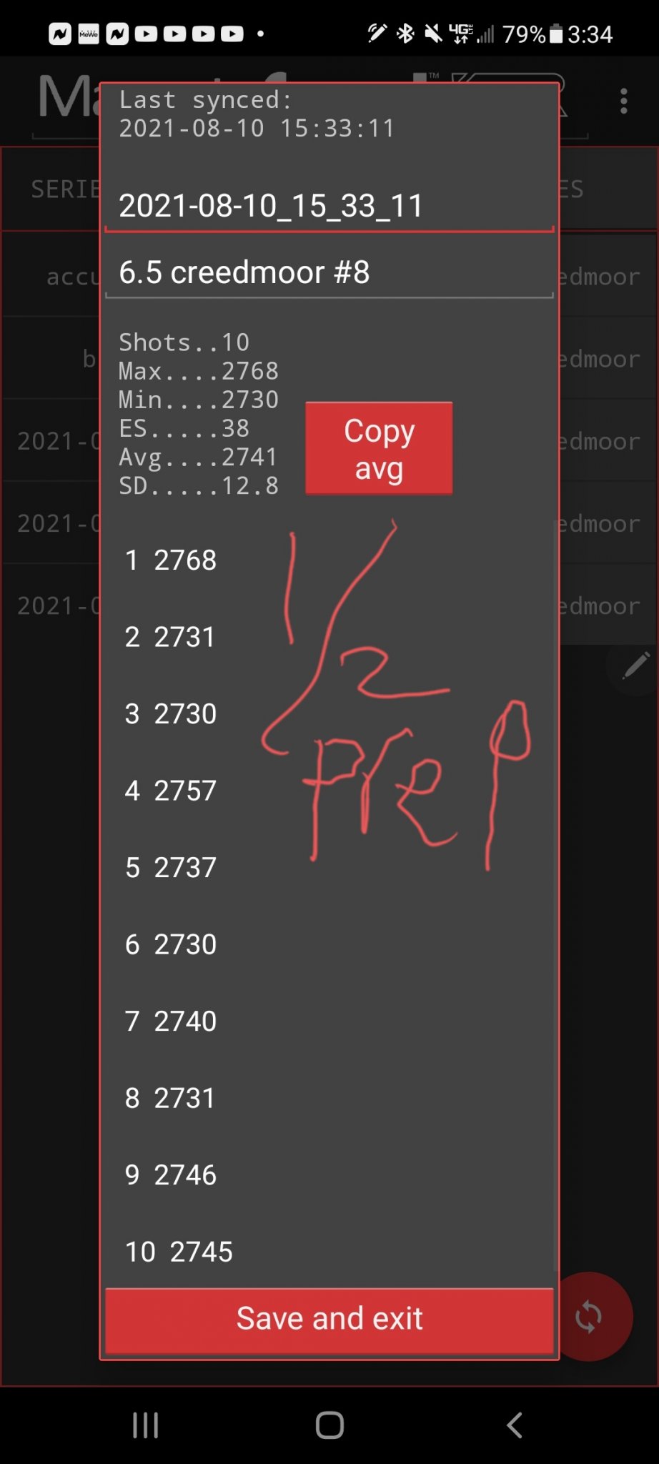

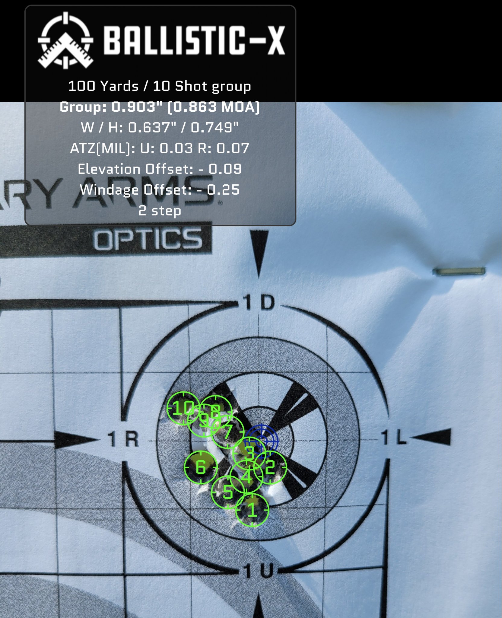

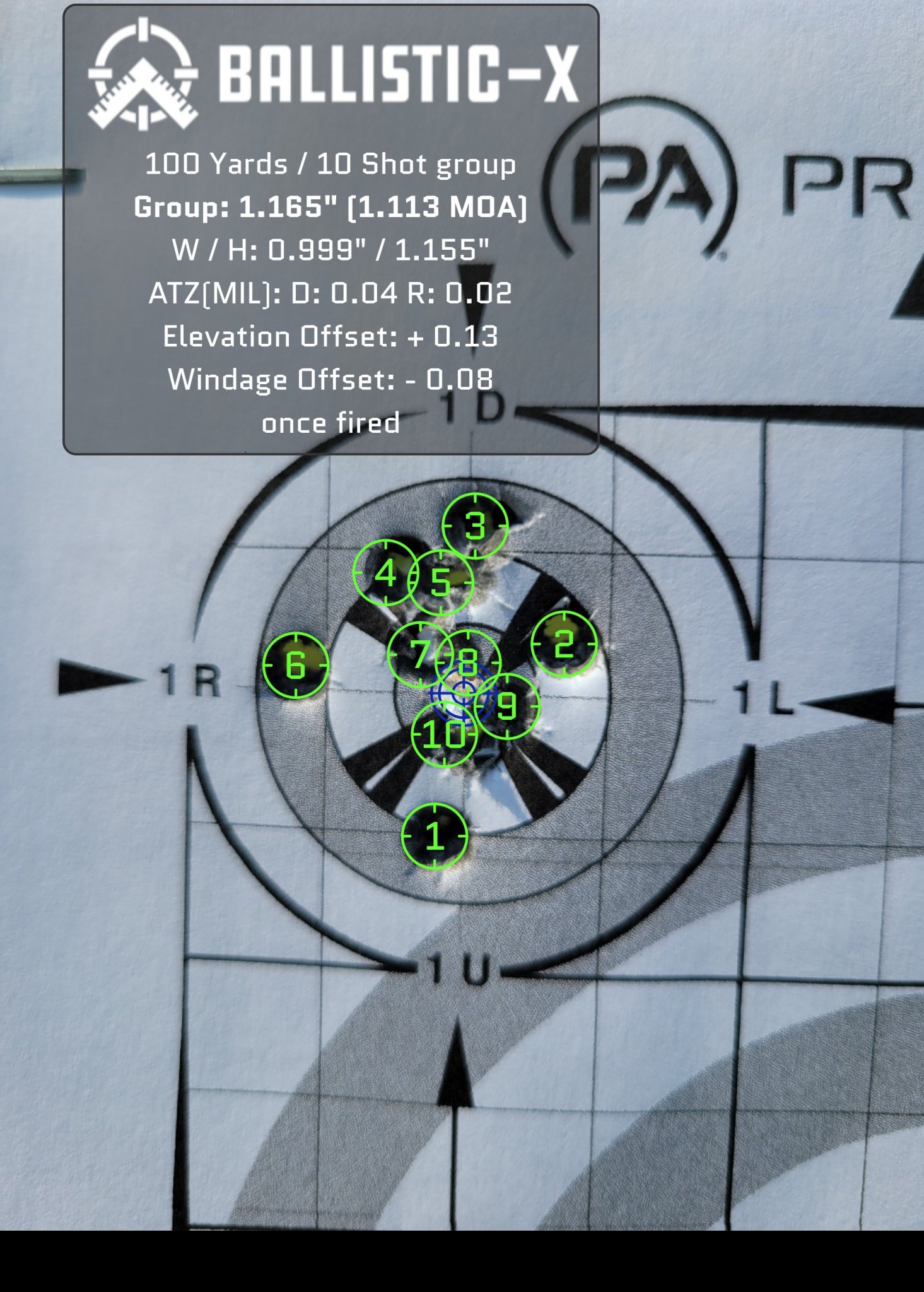

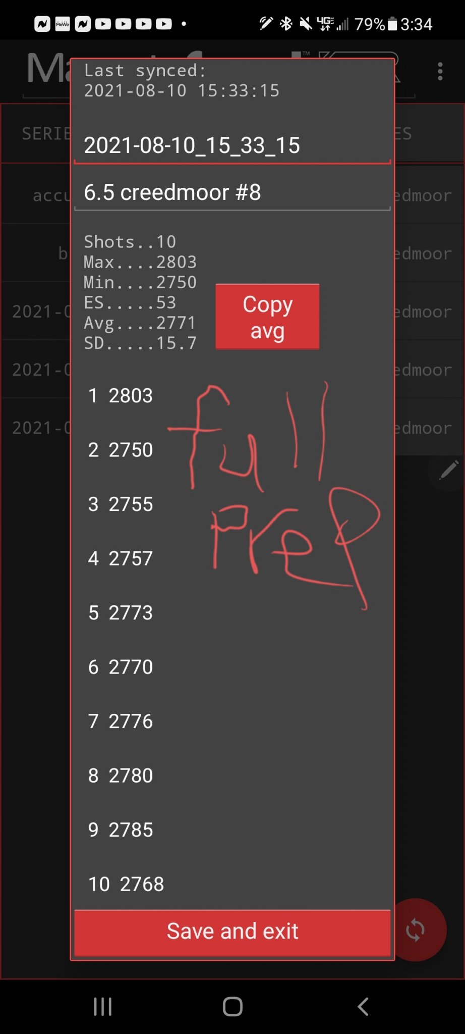

So shooting hornady brass 3 different ways of prep just for my a little testing
1st 10 was just once fired and bumped .2 with hornady die
2nd was done the same then I ran a the cases through a mandrel die .262
3rd was universal deprimed then ran through the resizing die with the the decapping rod and sizer button removed followed by the mandrel
My groups improved but my sd went up anyone else find that odd
Loaded on rock chucker powder thrown from one of the lee perfect powder measure and weighted lyman accu touch 2000

It’s not surprising in the least. Group size at 100yds or 200yds and standard deviation seldom correlate. Other factors are at play.
Also, what your statistics actually show is there is 95% confidence that the true SD of the first group would be between 6 and 16, and the last group between 10.8 and 28.7. This is what you would expect if you loaded and sampled more rounds.
It’s extremely hard to perform a test like this because its nearly impossible to control all the variables. In this case, one major source of variation is your scale. It will only display to the nearest 0.1 gr so a 39.95 gr load to 40.04gr load will both show 40.0 gr. That is probably 6 fps just due to powder charge.
What I would conclude from your test is that using a mandrel in either case gave me better accuracy than using just a FLS die and setting the shoulder back.
I wouldn’t concern myself with SD/ES on only 10 shots. In my experience the “SD” curve is somewhat of an arc. Small number of shots (3-7), low SD. Shot count increases to 15-20, SD/ES peaks in that range. Increase shot count to 30, it comes back down to somewhere in the low double digits which is perfectly fine for practical shooting purposes.
In fact, I’d argue that single digit SD numbers only get critical to have if you are shooting for groups at or near the system’s max effective range towards transonic (F class/bench rest).
Otherwise if you are consistently shooting at the limits of the cartridge and not getting desired results, I’d up-gun to a more powerful one.
Lastly, if you’re looking for better consistency try out some better brass.
Reactions: Doom
