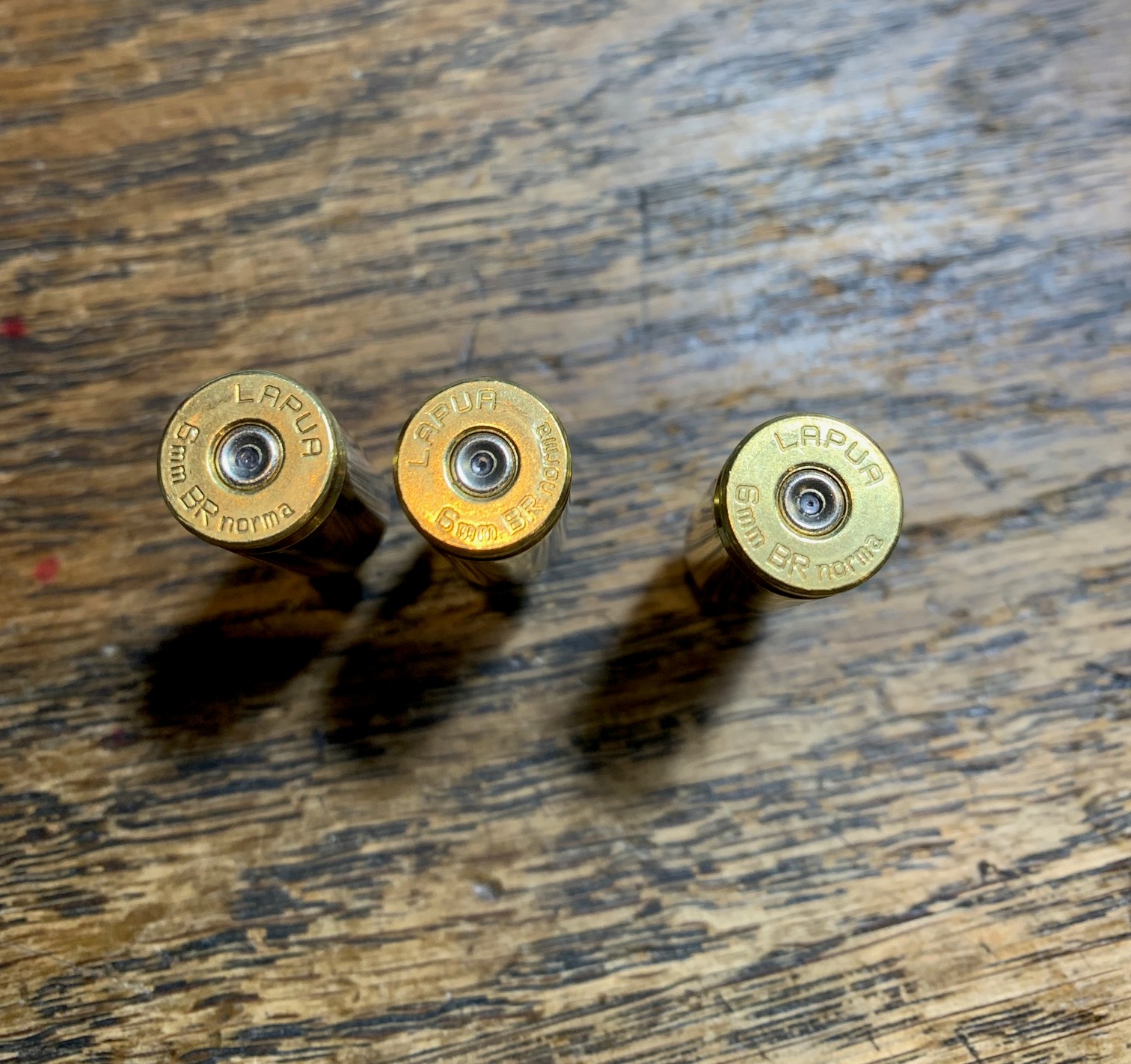

Hopefully a picture attached of some odd looking primer strikes. 6BR, Impact 737 action with Vitahvouri N140/29.5 grains. Primer is a CCI450 seated in the 0.005 range. I had just started using a new brick of 450's and noticed this. 3X fired Lapua brass. I shoot about 2000 BR rounds per year and have never seen this. I'm thinking some sort of manufacturer defect. It's like the whole top is soft and crushing inward.
Anybody seen this or have any suggestions?
I checked the firing pin tip and it looks fine. I have several spare firing pins so I may change it out. I shot about 25 rounds today though with another box of primers and did not have any issues. FP indent looked normal and the primer did not show signs of pressure. I have a hard time believing the primers in the picture are defective but, I guess it's possible.
I can try them in a 6XC I own. I just cleaned the 6BR barrel after my last match with BoreTech C4 and then Iosso bore paste. It had a small carbon ring as you would expect. Only About 25 rounds down the tube since. It has a .275 neck so it takes alot of carbon to cause pressure. I'll try those primers in my 6XC with a mild load and see what happens. Might go back to a known good load at 29.0 grains that runs about 2700fps.. I hate to slow down too much though. I shot a match recently with 3 targets at 1270 and flight time is 2 seconds. RO said he could have had a snack in between impacts.
Any chance you load pistol ammo, with similar looking primers?
I ask only because, once upon a time, I had some small pistol primers that got set aside when I unloaded the primer feed on the 550, and at some way later date, found their way into the queue when I was loading some 5.56 ammo. Looked kinda like what you have going on there. Never made *that* mistake again...

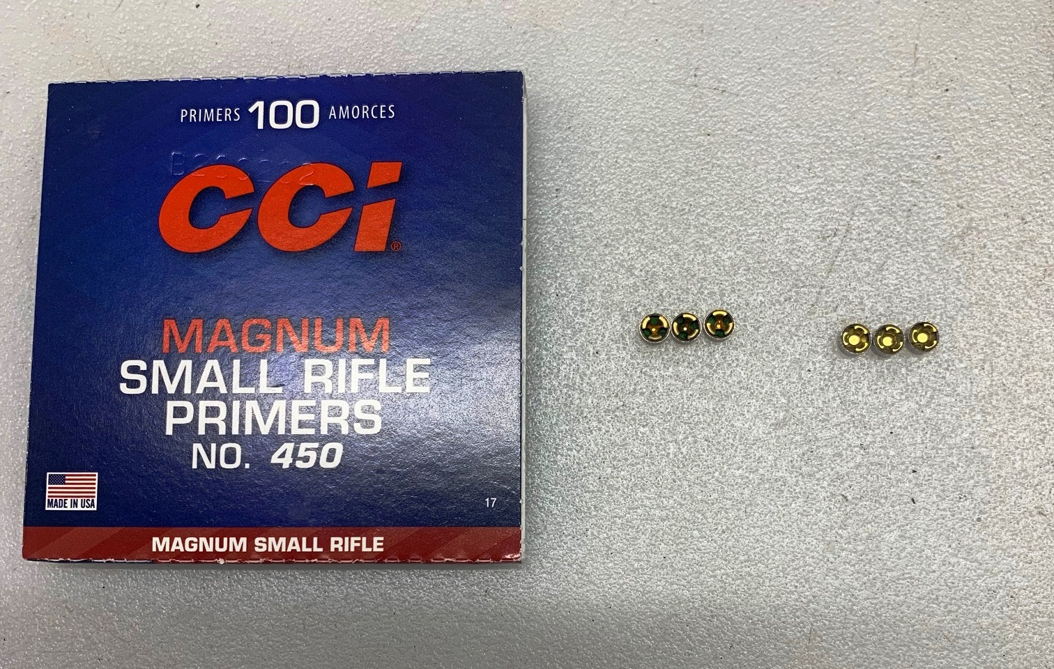

So I have 5 bricks of 450 primers all purchased at different times. When I compared the primers I noticed that on four of the boxes, the primer propellant color was the same - gold color. On the box that has been giving me issues, the primer propellant is green. I'm guessing CCI color codes primers so they can be identified so I'll send a pic to them and see if they will help.
Thanks to everyone for your help.

So an update: SRP primers were packaged in a 450 box. It's possible they were switched but, all the sleaves in the brick were marked 450's and all of the primers had green propellant. The softer and thinner cup of a SRP makes it unsuitable for use in a bolt action load hence the pierced primers. I'll be checking the color of the propellant when I purchase 450's again.

How did you validate that they are SPP?
I have called and left a message for CCI customer support to call me so I can get them to tell me. But, I have a friend who shoots alot of pistol matches and uses CCI primers. He said that based on the color of the propellant, they are 550 magnum pistol primers. I may try them in my glock to see if they have issues in a handgun round. I have 5 bricks of 450's on hand. I just pulled two primers from each brick and they all have yellow propellant. I shot some practice rounds today from one of the boxes and they all shot well with low SD and .2-.3 grouping at 100 yards. I've been shooting 29.5 grains of N140 through 2 previous barrels and it always shoots well.
