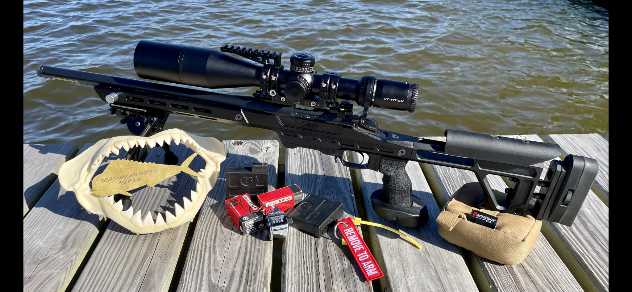

I've probably put 5k through my B14R in the last 2 months. Zero issues in both the factory stock and Xylo chassis using 10 different OEM mags. It's got a TT Diamond Pro set at 8 ounces. The only thing I'm not digging is the NF NX8 2.5-20 I put on it. I'm going to replace it once I figure out what I want. Got a DA Mask coming anytime now. I really enjoy this rifle. It was worth every penny I paid for it. Get one!
