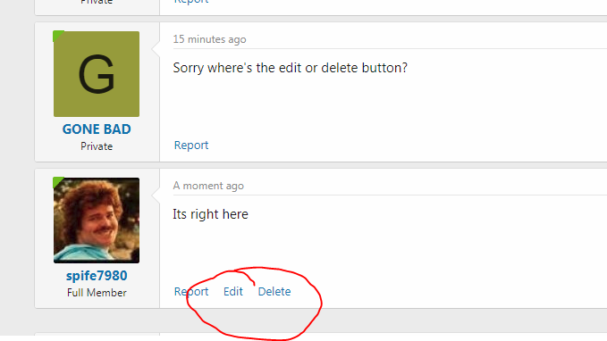

Its right here
If youre on mobile its in the same spot but under the ellipsis and down arrow.
