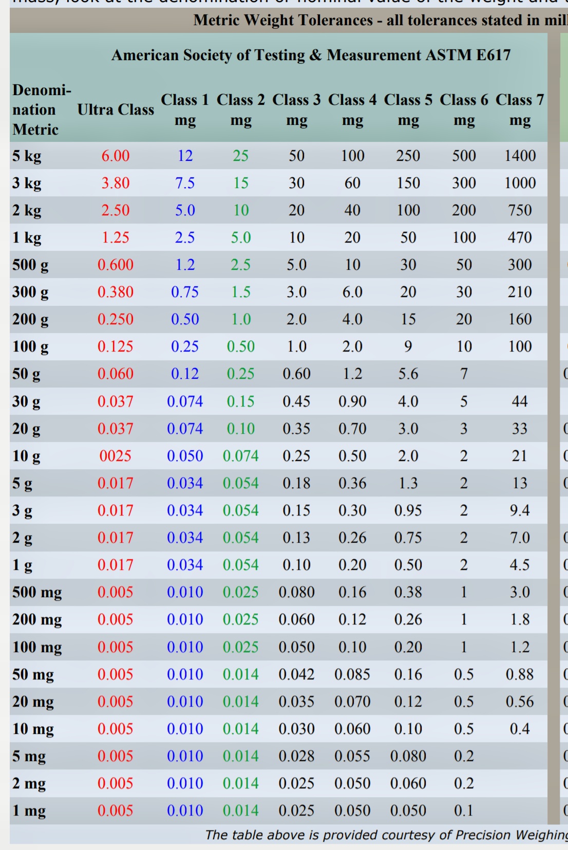

Yes, everytime with a lyman check weights.
It would bug me not to use a calibration weight with a certified class that has a tolerance tighter than what I'm trying to load for. I get that if 42.20 is your load then no matter if it is truly 42.20 or actually 42.36 being loaded as long as you load it precisely the same each and every time you will still be loaded the correct load.
Hopefully that makes coherent sense...
Yes, it's the difference between accuracy and precision and accuracy really isn't required.
