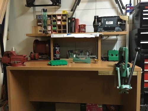

    @roostercogburn98 can you shoot me some pics so i have an idea. anyone for that matter, if you can send me pics of your set ups, i would be much appreciated.
    See how the press has a larger piece of 2x under it? extra thickness to reist bending and it spreads the load out over the entire area of the 2x4 to the table top itself instead of only contacting the actual top on only the bolt hole locations.
    Reactions: Festeraxp

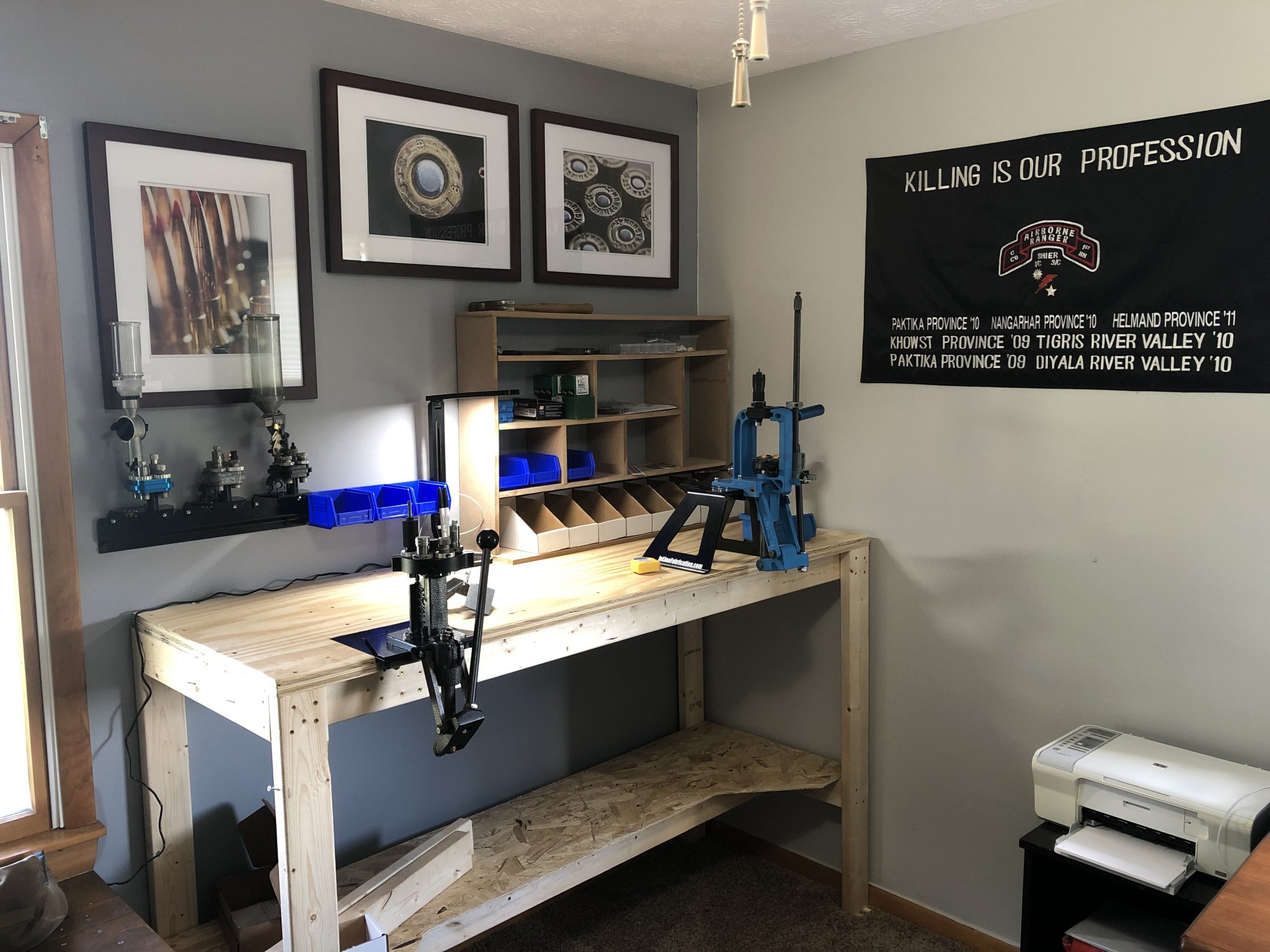

    Here’s a pic I just snagged from the loading room contest thread (It’s someone else’s). It shows a pretty solid and simple bench made using two layers of plywood. Guarantee that this would not break.
    Solid wood tops always have the potential to break under a lot of stress, due to natural grain weaknesses.
