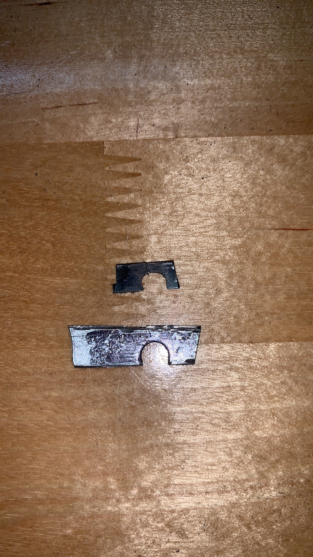

It shot OK but I have been led to believe a 2 piece firing pin is not good for Ballard’s and finally after searching for one gave up and picked up a file.
The two pieces at 10 o’clock or so in the dish should be a one piece unit and look like a funny upside down U

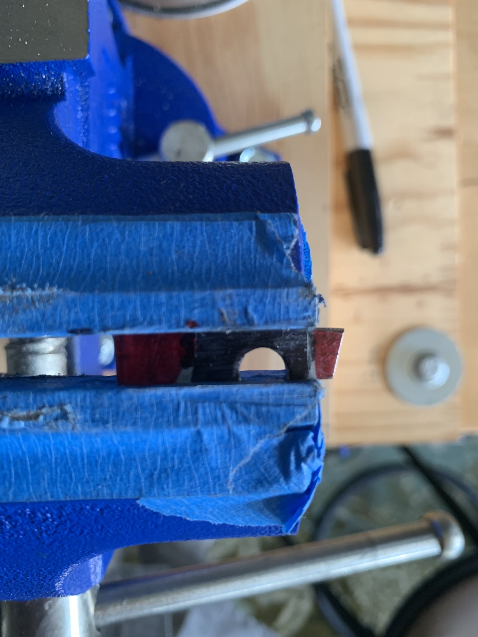

Starting to look like a firing pin, a little bit of Dremel, a lot of filing, and soon some stoning.
Then a mild heat treat I think.
