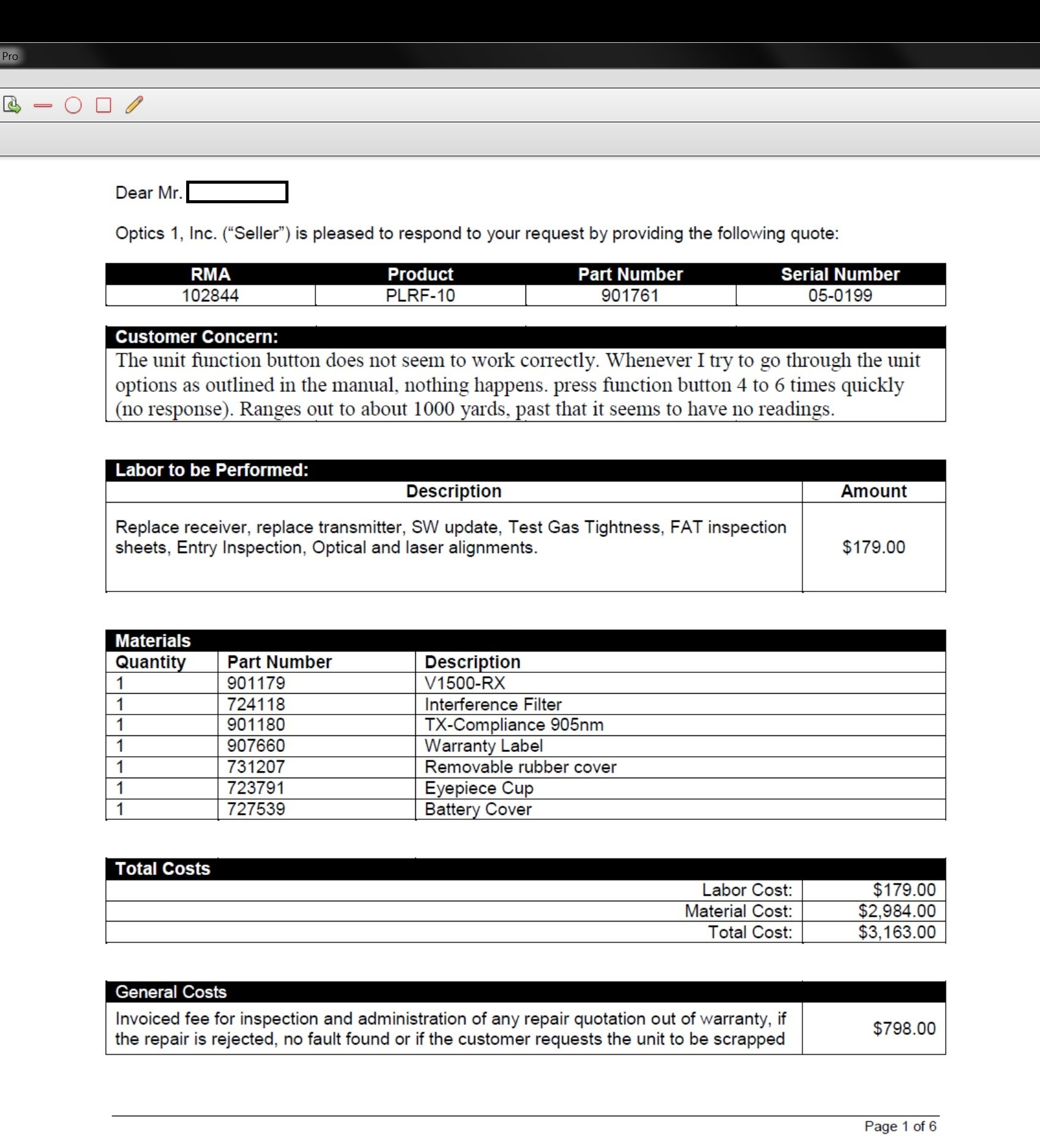

My terrapin will only range at night not during the day. I talked to Optics One late last year and they said it would be $800 to inspect. It’s still sitting on my bench. I’d like to get it fixed but didn’t think it was worth another 800 to look at it plus more $$ to actually repair it. Would love to get it fixed someday though.
Any updates to this thread? I live in Canada and have a Terrapin that has intermittent display issues. Anyone able to fix their Terrapins?
Check out http://www.optics1.com/
I reached out to them a while back about mine and he said it could be fixed. The problem was it was like $800 to diagnose. I asked if the 800 would be applied towards repairs if I proceeded forward and never heard back so I never sent it in. I think I’d rather apply that 800 towards the newer terrapin or something that has a service option.
I talked to them awhile back. The 800 covers the inspect only, but they said they would scrap it for me after i paid the 800. They said mine had a problem with the memory. It would range find out to 1000, past that was no good. They sent me estimate for 3k to repair it. Its still at their shop. Theres a whole thread about it.
