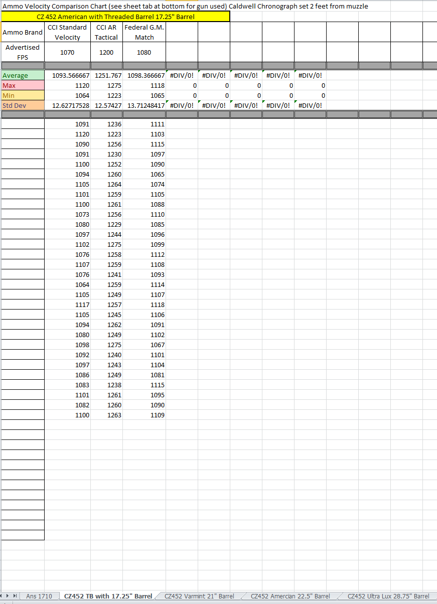

    1. 452 American TB Barrel length 17.25" --1093.6 fps

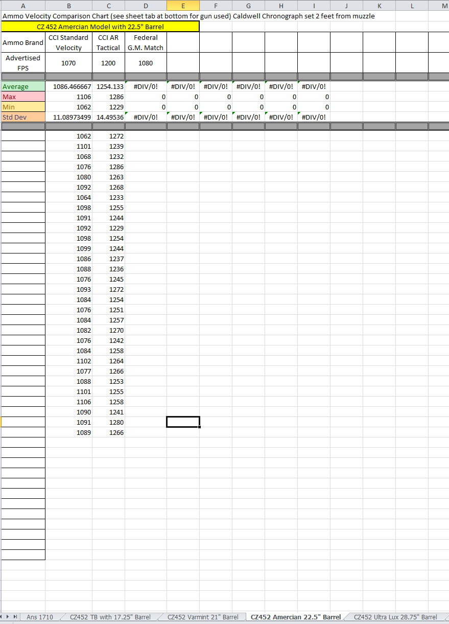

    2. 452 American Barrel length 22.5" -------1086.5 fps

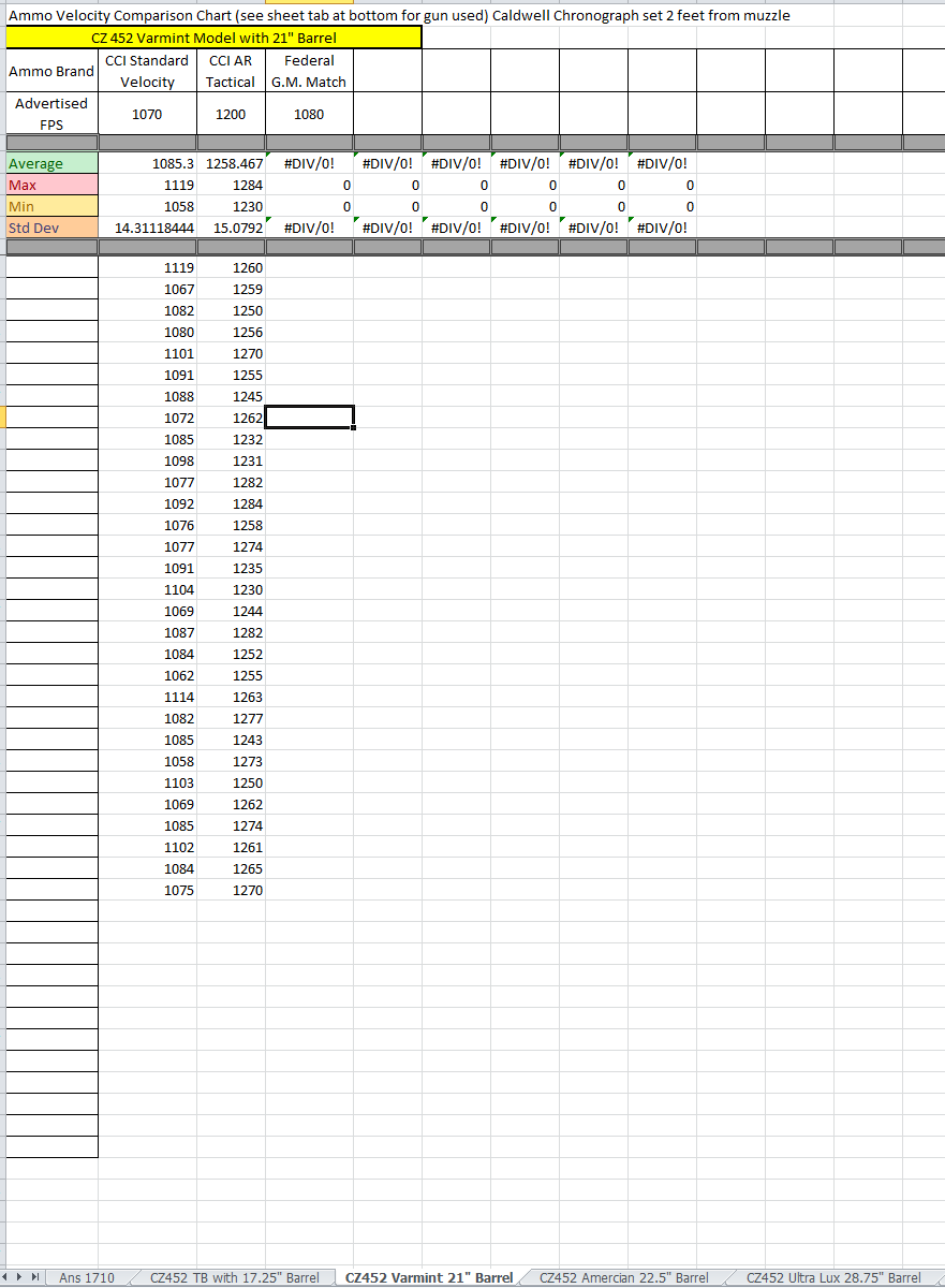

    3. 452 Varmint Barrel length 21" ---------- 1085.3 fps

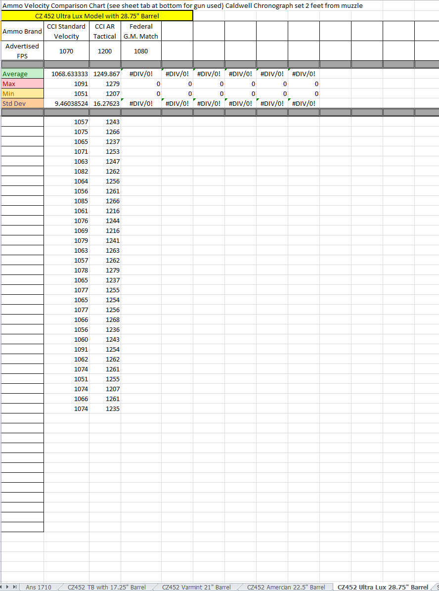

    4. 452 Ultra Lux Barrel length 28.75" ------1068.6 fps

    1. 452 Varmint at 1258.5 fps
    2. 452 American at 1254.1 fps
    3. 452 Amer TB at 1251.8 fps
    4. 452 Ultra Lux at 1249.9 fps

    Ok, here is the snip photos for each rifle.
    7113194
    7113195
    7113196
    7113197

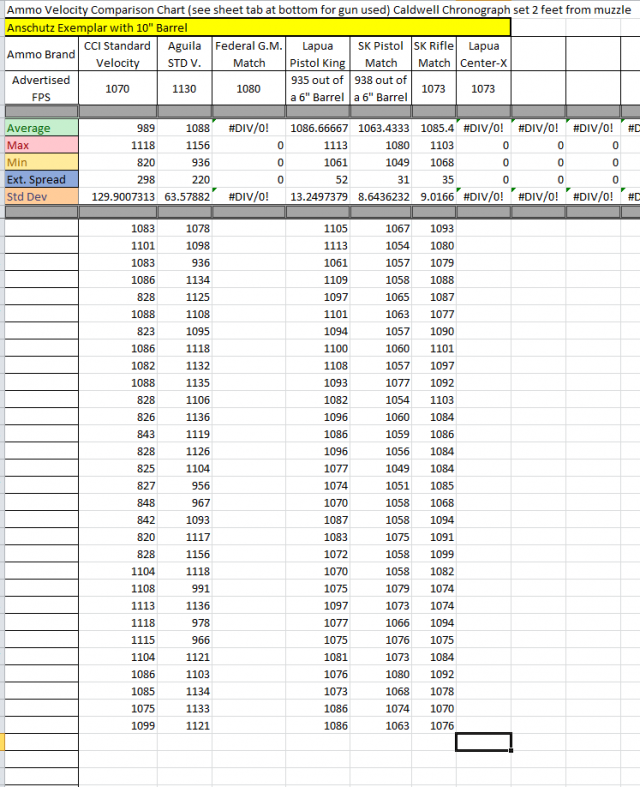

    Here are some other data from my 10" barreled Anschutz Exemplar. Since the CCI SV ammo slowed down so much out of the Ultra Lux barrel I wondered how far behind the FPS would be out of the 10" barrel.
    The velocity FPS didn't surprise me but the SD sure did. This is the same LOT ammo I have shot for months and the same used in all the CZ test. Same for the AR Tactical.
    7113199
