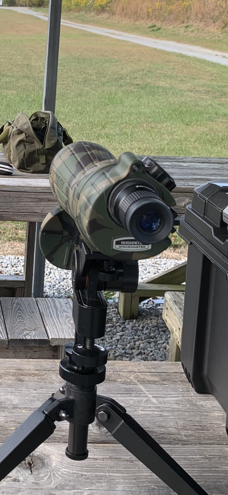

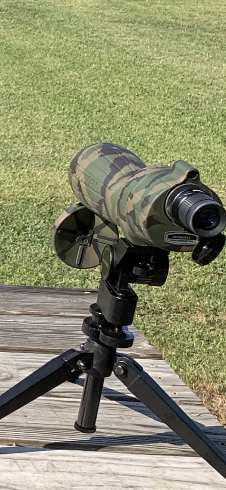

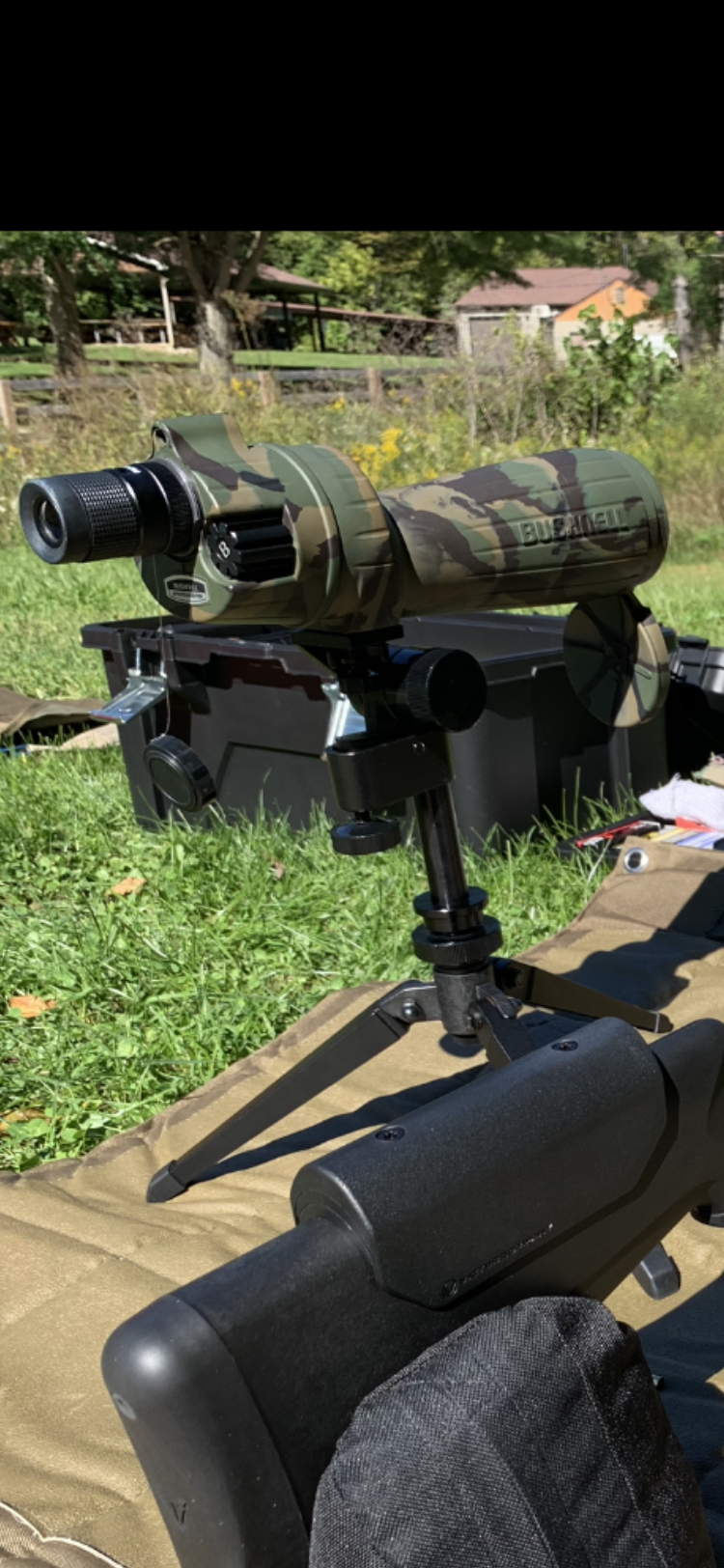

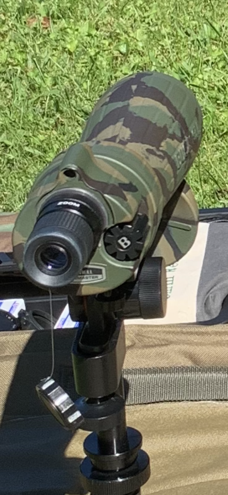

I’ve been real happy with my used Bushnell Spacemaster spotting scope. Made in Japan. 15-45x 60. Comes with backpack and tripod. I think I gave $125 for it.
I spot .22 impacts on paper a 300 just fine. Spot at 1000 just fine as well.
Only thing is the eye relief is a bit tight at 45x but I’m not at 45x very often.
