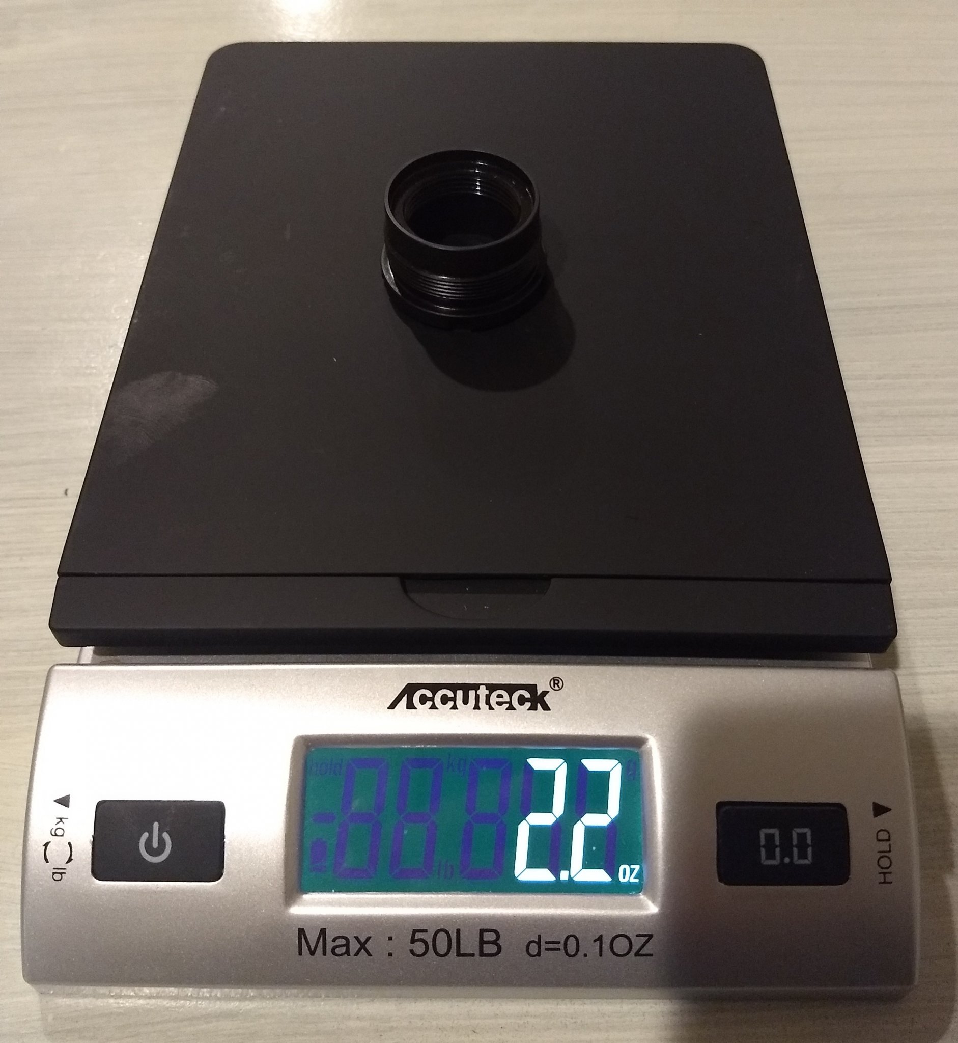

I got a Griffin Plan-A with my Nomad, haven't used it, but playing around with it, it seems well made and locks up nicely.

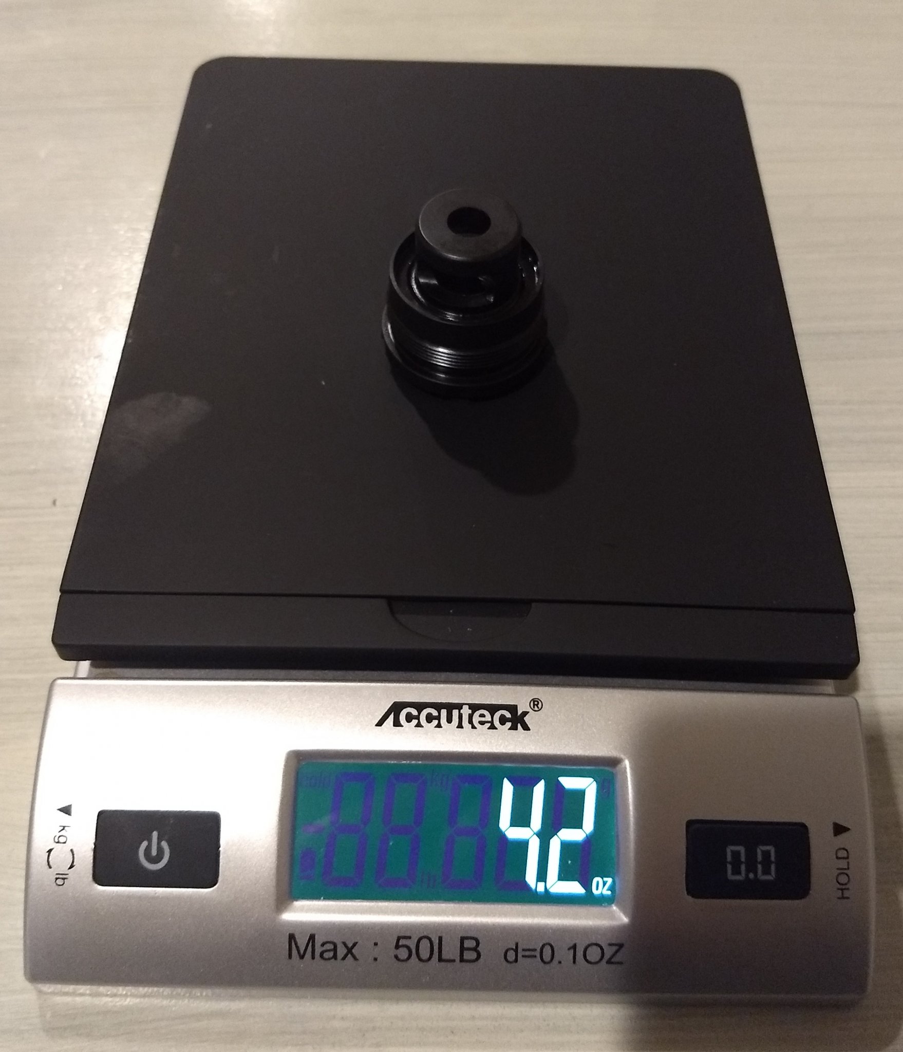

It's pretty light as well, 2.2 oz, a steel minimalist brake adds 2 oz and a Ti minimalist adds 1 oz. I believe, that's ~0.3 oz heavier than a Plan-B + Cherry Bomb with the steel brake, and 0.7 oz less with the Ti brake.
I'll probably wind up getting a Plan-A for my Saker as well since I'll have the brakes mounted anyway.
