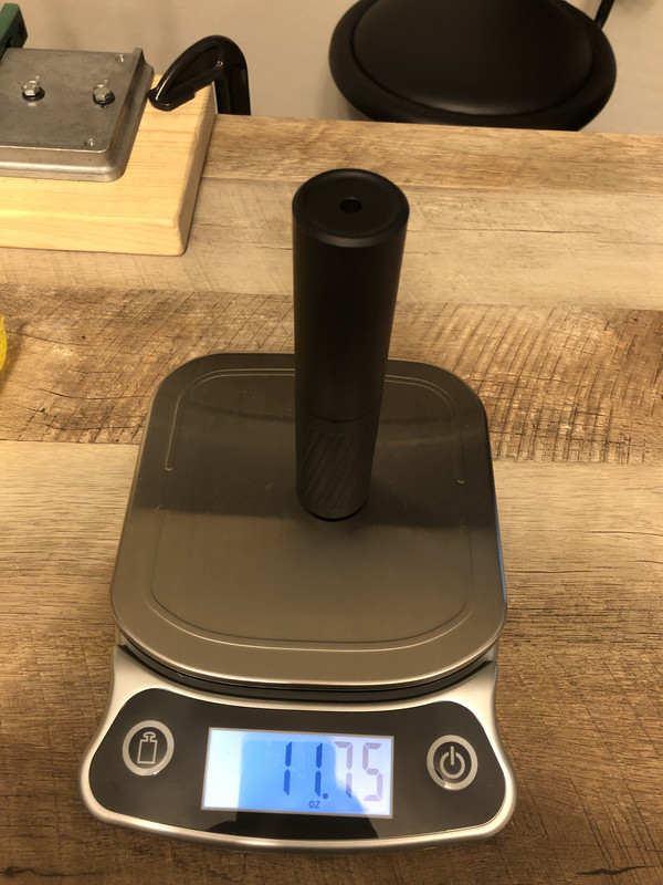

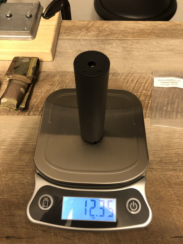

All that said I am very happy with both. I'm in the camp of liking the ultra better simply because they come in .264 where the Omega doesn't. I also like the fact that the Ultra comes in over 1/2 OZ lighter than Omega with Omega having all the ti stuff on it.
In the end I kinda think the Omega is outperforming my Ultras and am having a hard time accepting that hahah.
Omega with ti end cap and thread adapter in DT
.264 Ultra 7 DT
